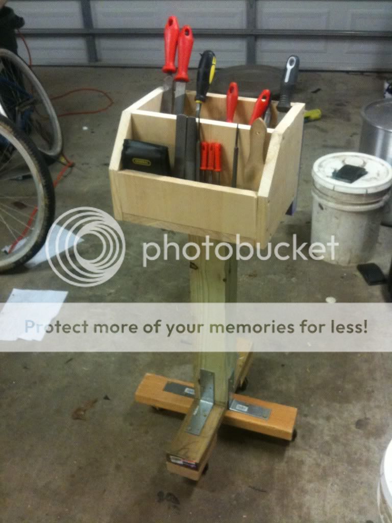

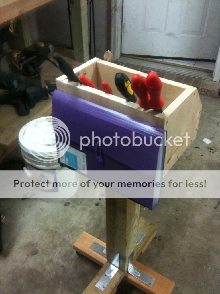

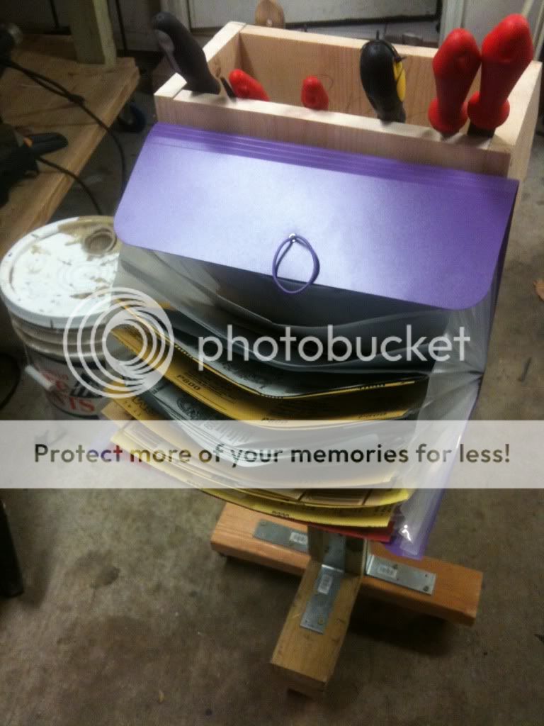

I move into my new place which has a yard and basement ( the shop) in 2 weeks . This is what I have so far.
Craftsman 2x42 : $200 including the shipping to get it here
Belts from trugrit, I got the expensive ones ( gators, Blaze etc ) and some AO in a variety of grits: $140
Makita porta-band used off of kijiji , 4 yrs old and runs good but not pretty : $80
Bubble Jig set: $75
I already have a 4" vice and a wide variety of files and hand tools also a master craft rotary tool with 500 accessories and a decent cordless drill . I still need :
- drill press ( $200 budget for this or more? still gotta get the other stuff)
-shop vac
-a box fan or 2 with some furnace filters for dust control
-long tube fluorescent lights and table lights
- wood, screws , etc for work table and stands
-possibly a bench grinder/ polisher / paper wheel
I plan to build my own work table and hopefully the hardware store will cut the wood for me , also I'd like to make 2 stands and rig the porta-band stationary upright. Any thoughts on this list and building tables and stands, I can probably find free plans on the net. Anything important I'm forgetting ? Still got around $500 to work with.
