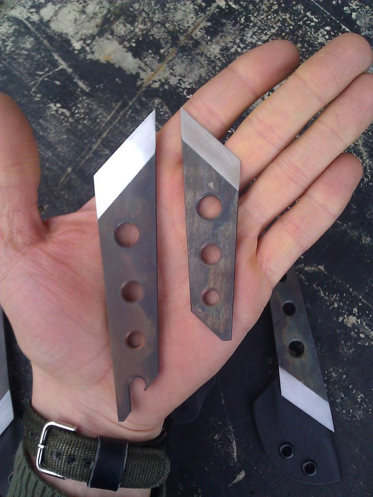

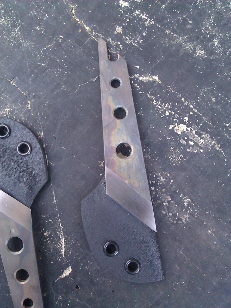

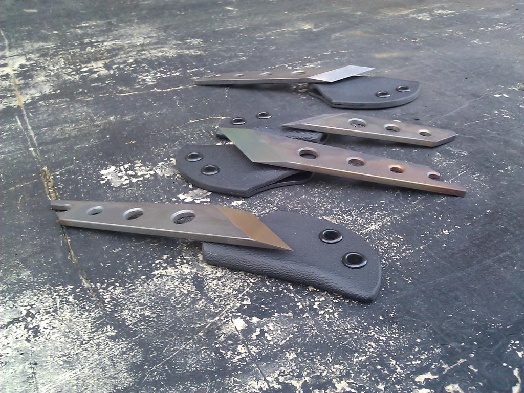

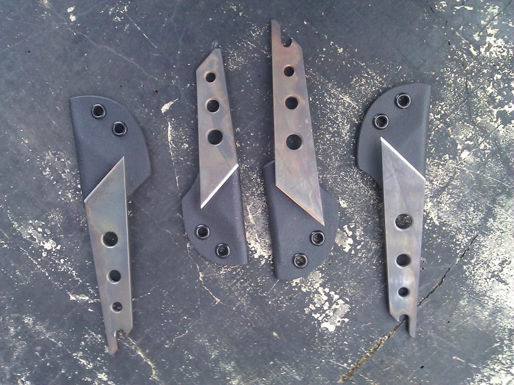

Three birudashi and one mini, all single-bevels.
Two have left-side bevels and one has a right-side bevel. All are sharpened on the back side. They are ~0.140" CPM154 with 180grit perimeters and 280 grit bevels. The flats are mill finished and all but the bevel just has the heat-treat finish.
I'll add some better pics when I get some more light.
