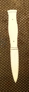

I've been looking for a consensus on dimensions for an accurate Sgian Dubh. Most on-line articles I have seen agree on a 3.5" long blade (somewhat). But, beyond that, width, OAL length, and single vs double edge blade differ.
IS there a historical consensus for this little blade, or did they simply change over the centuries and as long as it's "close" it's okay? I would like to be as accurate as possible, if possible.
The pattern I have cut out has a 3.5" blade and 1" width, and I've drawn it showing a double-edged blade, but can make it single edges also.IMG_20171016_140021.jpg
Thanks,
There is no standard for a sgian dubh. Originally it was a hideout knife for last ditch defense and for eating. During the 19th century it became a decorative knife used as part of a highland costume, but seldom used as a knife, and it was incorporated into Britain's Scots regimental dress. Current decorative usage has the blade at about 3 1/2" long, overall length about 6 5/8 (depending on how long handle needs to be for the owners hand size), spear or dagger point, single edge, back of blade may be scalloped, wood handle is thin (for comfort when worn on leg) and may be decorated with carvings and inlay, and a leather sheath. Going back beyond 19th century, there are no records that reference any details of a sgian dubl and its dimensions and fittings are up to your imagination, guided by pictures of the few older scotish knives that still exist. In ye olden times it is probable that a sgian dubl was not a special design, but was just a normal knife of a size that suited the purposes of a sgian dubl.

I agree with Bob.
3-3.5" blade, single edge, file-worked spine.
3-3.5" handle, flat profile. Blackwood, carved in a woven pattern is most authentic.
No guard. A bolster collar is normal, but not required.On ceremonial sgian dubh, the collar is often engraved or patterned.
Handles may vary with taste, and a small stag crown is also authentic. Mounting a small scottish coin in the crown end is nice.
Silver fittings are traditional, but any metal will work.
A simple blade cover scabbard made from waterproofed light weight leather is a good idea. 5-6oz leather is fine. The sheath does not need dying unless you want it, but it does need waterproof sealing with Resilone or other good grade sealer. You don't want dyd because it may bleed into your hose or shin.
The knife needs to be lightweight, so keep all thicknesses down. 1" is pretty wide. 3/4" is more like it. 1/8" is plenty thick, even less is good.
The handle should be around 1/2" to 5/8" thick. 3/4" to 1" wide is about right.
All that said, there are no sgian dubh police checking your weapon at events to make sure it meets any standards.

Thanks Bob and Stacy, I'll modify my pattern to incorporate the suggestions into my build.
