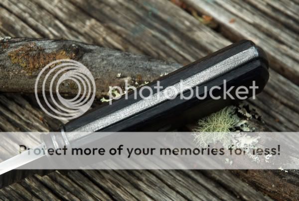

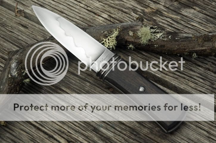

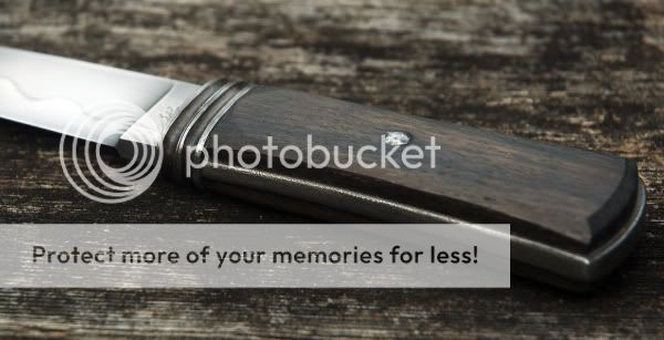

It's pretty close to what I had in mind.
An interesting thing about this piece of Bog Oak... I tried sanding it but it really looked terrible. It seemed to lose it's essence somehow. In the end I used a scraper to finish it. It looks rougher but the cut of the scraper kept the "flecks" of grain where sanding kinda made the handle look like mud.
Blade is W2 at 4 1/8" long with an OAL of 7 3/4"
Handle is "Ancient Irish Bog Oak" (as it was described on ebay)
The guard and frame are from an old wagon wheel. (Thanks to Ray Richard for the tips on finishing it :))
Pin is a common nail peened.
This is my first frame handled knife.
In case it's not clear, I intended the filing of the guard to be rough and the faceting of the handle to be slightly unbalanced. It's got a real old feel in person. Hard to believe I just finished it last night.

You got some major talent, there.
And, yes, you've made the handle look ancient, and strong.
John
Stuart, you knocked it out of the park with this one. Somehow you got the knife to look like it was made 200 years ago and then put in a perfect place for safe keeping until today. The Bog Oak is the very best choice you could have made for that particular knife. "Authentic" comes to mind along with meticulous and a couple of other glowing adjectives. You did well, indeed!:thumbup::thumbup::thumbup:

Stuart, First time I saw this knife I thought you had found one of the fittings I had lost out in my shop. If I didn't know you were a new maker I would have never guessed it. I've never been a big fan of Sgian Dubh's but I do like your version of it.
Very cool and interesting piece--does look like it came out of someone's family heirlooms from hundreds of years ago. Nice!
