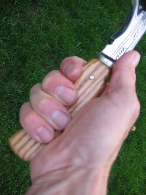

I re-handled my Sgt. Khadka and I hope you guys don't hate me for changing the lines. I have had this knife for about seven months now and a fine knife it is....but the handle was a bit too short for practical use. Since I use all my HI blades this was not acceptable to me. I had some oak left over from a cabinet project [read frugal here] so I decided to give it a try. After Dremeling off the peened tail cap, I fired up the Coleman camp stove outdoors and proceeded to boil off the original bone handle in a coffee can. The handle slipped off with no problem. I used a router to cut groves into the new two piece slab oak handle where the rat tail tang would fit into. Drilled some holes for a couple of brass pins, nice epoxy sandwich, clamps and an overnight cure did the trick. I am pleased with the results, lots of comfort and a sure grip. I credit this forum for giving me the info required to do this project. I have never done anything like this before and it was a gamble that could have resulted in a total loss. I regret not taking step by step photos along the way, but here are two of the finished job. I have a villager Ganga Ram and an Ang Khola that are perfect and shall remain as is, I promise.
i approve! looks good to me, and a better job than i did - next time, the slab method, and a pin, though i'm tempted to try a pin when i can get a drill press.
what did you make your pin from?

Thanks everyone for the positive comments, better to use it and enjoy it. Bladite, I used a couple of ordinary 8-32 brass machine bolts for the pins. I cut them to length with the Dremel. The machine threads in the screws help, the epoxy has a nice rough surface area to cling to. I did use the drill press for the holes through the handle and tang. Your handle conversion looks strangely familiar.

Sorry for the confusion, the handle was horn.

I agree with everyone who's said variations on "good for you for making the tool usable." It's far better to have the blade handled in a way that it won't live in a drawer. I also see that the handle you've made will be comfortable, handy, and fit for hard use.
It would look better, IMHO, on a Western style blade. Were it mine, I'd have tried to make something that had more the look/feel of the original.
But it isn't mine - and as a result of your work, it will have an ongoing and functional life. Much better than the alternative ...
