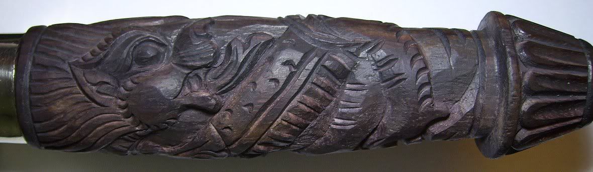

Second, my special ordered Dukti sword, which looks to have been made by Bura. Initials La Ba, crescent moon mark, I don't know who else it could be. :cool:
Interestingly, the balance is much farther forward than I would have thought, an entire 6" ahead of the guard, compared to my short Tibetan (with a more Uddha-like blade) that balances 4.5" ahead, and my Giant Chitlangi which balances 3.5" ahead. Despite that, the fact that it weighs only 28.5 ounces means that it's not slow or unweildy by any standards. The central fuller also makes it make a rather loud noise, nearly a whistle, when swung properly.
One unusual thing I notice is that this blade actually has a reverse distal taper! It starts out at 0.204" thick at the ricasso, then very uniformly thickens to 0.255" just before the fuller ends. I've never seen a sword do that. I think that actually makes some sense for a primarily stabbing blade, though; having the thickest part first means there may be less resistance when pulling the blade out after a thrust. It definitely works that way with cardboard boxes, anyway. It stabs in very easily, and glides back out, while the short Tibetan, despite having a more acute tip, drags a lot both ways.
And the carving of the dragon is perfect, as can be expected.
The only imperfection on the blade at all is that one of the edges was ground a little wonky right above where the fuller ends, on one side. The good news is, it wasn't ground enough, so it should be very easy to correct with a file (it's easy to take metal away, not so easy to put it back). It also doesn't affect function of the blade in any way at all, purely cosmetic, and an easy fix.

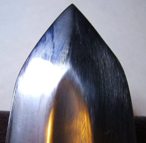

And the tip of the Dukti, which is just the tiniest bit off, you can see how the "line" goes off to the left.
Might not be as easy a fix as I'd thought, as I remembered "oh yeah, this is a Bura heat treat" while I was trying to knock the burrs off with sandpaper. The steel on this sword is hard.
Congratulations on your new steel Ryan. Don't you just love it when you get a new triangular box delivered? The handle carving on the Dukti looks great from what I can see. Maybe you can get some more pictures when the sun returns. How long is that Dukti in overall and blade length? It looks like a very nice sword. Being Bura made I'm sure its a quality piece of work and art.

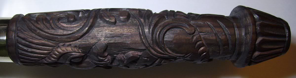

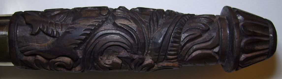

That at least, I can do tonight, by putting a diffuser on my flashlight. It's anything but close-ups that's a problem. :(

Thanks for the close ups of the Dukti handle. That carving looks very nicely done.

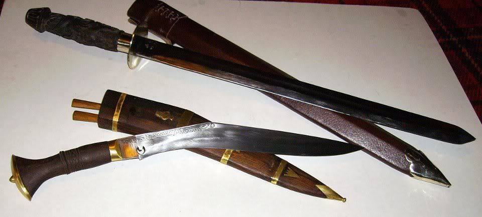

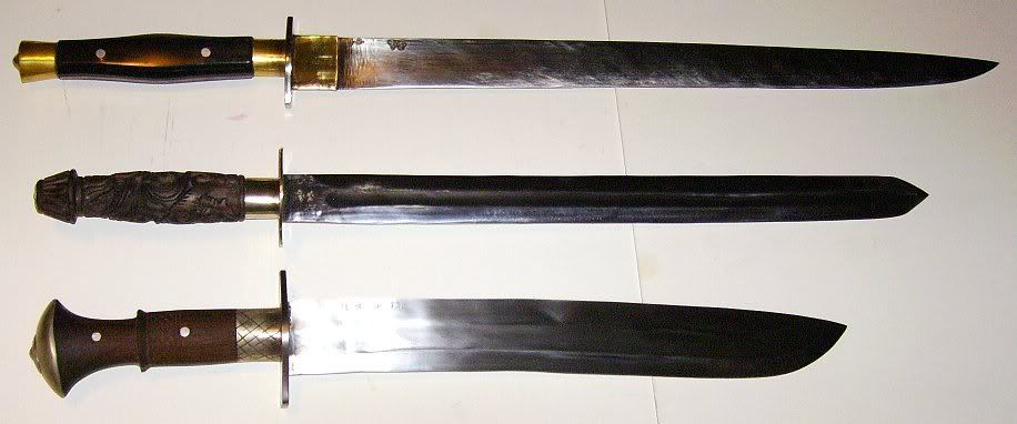

The dayorb hasn't been very cooperative, so here's another terrible indoor photo of my 3 HI swords.
The tip on the Dukti turned out to be very very easy to fix with a diamond file. Given how hard it was to knock the burrs off the edge, I think Bura figured out how to differentially harden a double edged sword, somehow!
Good news that the Dutki was 'squared off' successfully. I have read that both the Dutki and Manjushree Swords are differentially hardened. I would really like to know that is true or if they are quenched-hardened?
With regards the Giant Chitlangi Bowie, I yo-yo between categorising mine as either a knife or sword. Considering its size and weight, it can fit both. ;)
Oh, I really like your Short Tibetan Sword. It is one of the few items I hope to purchase this year.
Me too. It really does seem as though the edges are harder than the spine.
I like to think of it as sort of a "Dwarven" bastard sword. Exact same weight and balance as a regular bastard sword (3 lbs 11 oz., balances 3.5" ahead of the guard), but much shorter, and it hits more like an axe. Definitely my absolute favorite blade of all time. Though this new Chainpuri, the polar opposite, is really growing on me. If I were just a little taller, I'd be seriously thinking about having a concealed carry rig made to hide it under a jacket.
Definitely go for it. Mine is surprisingly nimble IMO, much closer in handling to a cut-and-thrust sword, than a heavier slashing blade.

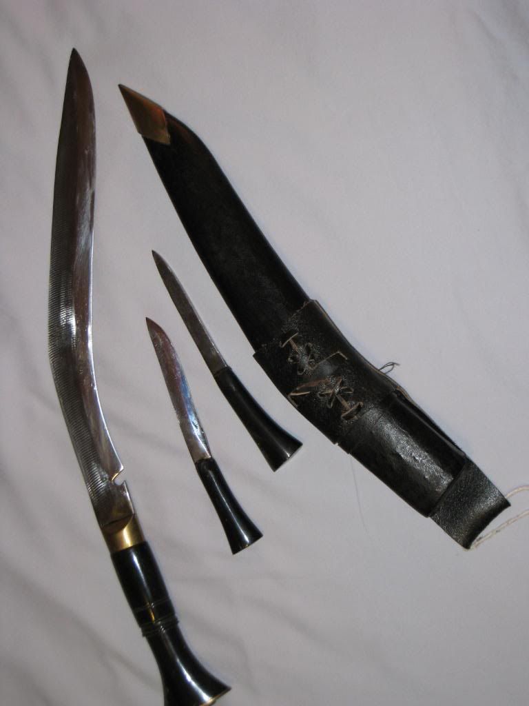

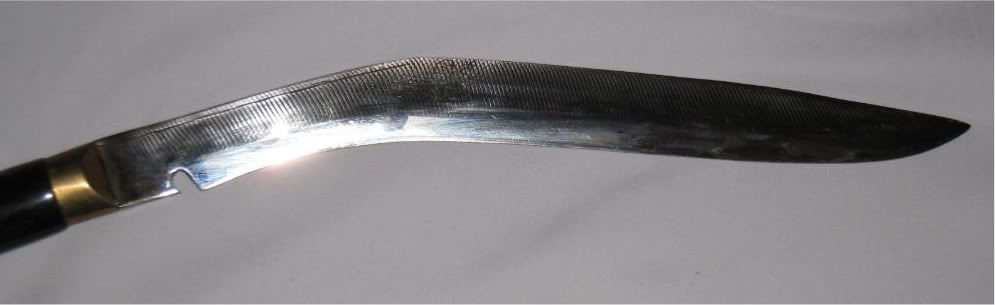

I do have an old Kumar Kobra, atleast I'm pretty sure it's a Kumar Kobra even though it doesn't look quite like a regular Kobra, more like a Malla. Anyways, I picked it up around 10 years ago, might have been from the first batch of Kobras made (could be wrong here). It does have hatch-marks all over the blade flats and even the karda and chakmak have what look like remnants of hatch-marks - don't know if this means it was an old file. I'll take better photos and post them soon, in the meantime here are some cr@ppy pics I took some years ago:
Length is around 17" OAL, don't know exact weight but it's very light and agile, although it does not feel as "aggressive" as the better villagers I've handled. This is a very neat khukuri though.

sta94, that ole Kumar Kobra is something else!! :thumbup: would love to handle it and compare it to the villager for speed and agility.

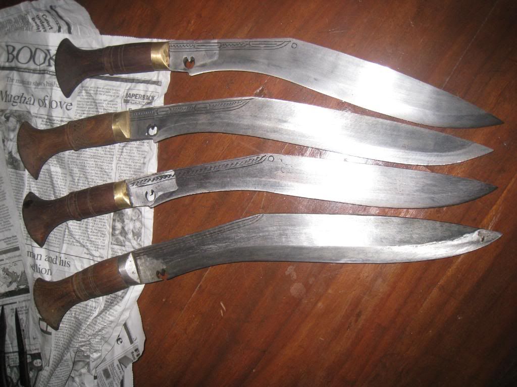

The scabbards on the four villagers pictured are all pretty rough affairs too. For one of them (top-most in pics and the one still with me), I had to dismantle it and smoothen out the insides by filing/scraping the rough portions that were catching on the blade. And yes, kardas and chakmaks on these are really nothing to write home about! This rough appearance with minimal aesthetics seem to be pretty common amongst these villager models - and for a reason too, the clientele for which these khukuris are intended for would probably not be able to afford prettier (and thus more expensive) khukuris. You will find very well-done scabbards, etc. but these are aimed at consumers with a higher price point! Atleast your villager has a really nice, solid handle and butt-plate. Two of the four villagers in my pic have partial-tang handles.

Sta94, it would be my pleasure. :D The OAL length is 18" and weight is somewhere I around 25oz. This one is partial tang and as you know, handling and feel are wonderful. A great kukri IMHO. :thumbup:
Big W, thanks very much for the photo! Now, that's a nice solid hunk of a villager khukuri! Pick it up and you can almost feel a heightened sense of its edge and point, very alive, like a lithe beast coiled to pounce on its prey, seriously!!! :thumbup:
