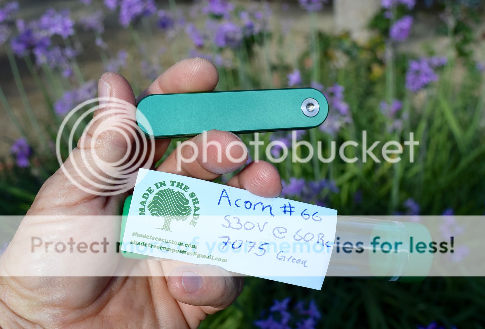

The Acorn comes packaged in a protective plastic tube (There is some history to this that will be explained below.)
[/URL]
Inside the tube is the knife and a card showing the prototype serial number, steel type & hardness, and the scale material & color.
[/URL]

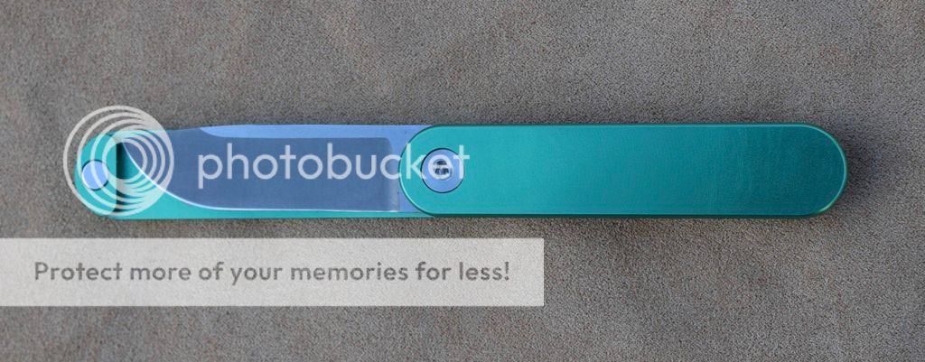

The following measurements were taken with a digital caliber I use at work. Most of the results are very close to the nominal specs listed by Shadetree with the exception of blade length. I measure blade length from the front of the handle forward to the tip, rather than including the pivot section of the blade that is covered by the handle. It is possible that Todd made a typo on the blade length spec he posted with his announcement.
Lock Type: Rotating “Swing Lock” Mechanism w/ Rare Earth Magnets acting on Open & Closed Positions
Blade Steel Type: S30V @ 60 HRc
Primary Grind Type: Flat Grind
Blade Length: 2.410”
Cutting Edge length: 2.680”
Blade Height @ Plunge Line: .710”
Handle Material: 7075 Aluminum w/ Green Hard Anodize (also available in Blue)
Handle Length: 3.545”
Handle Width: .435”
Handle Height: .748”
Weight: 1.86 oz.

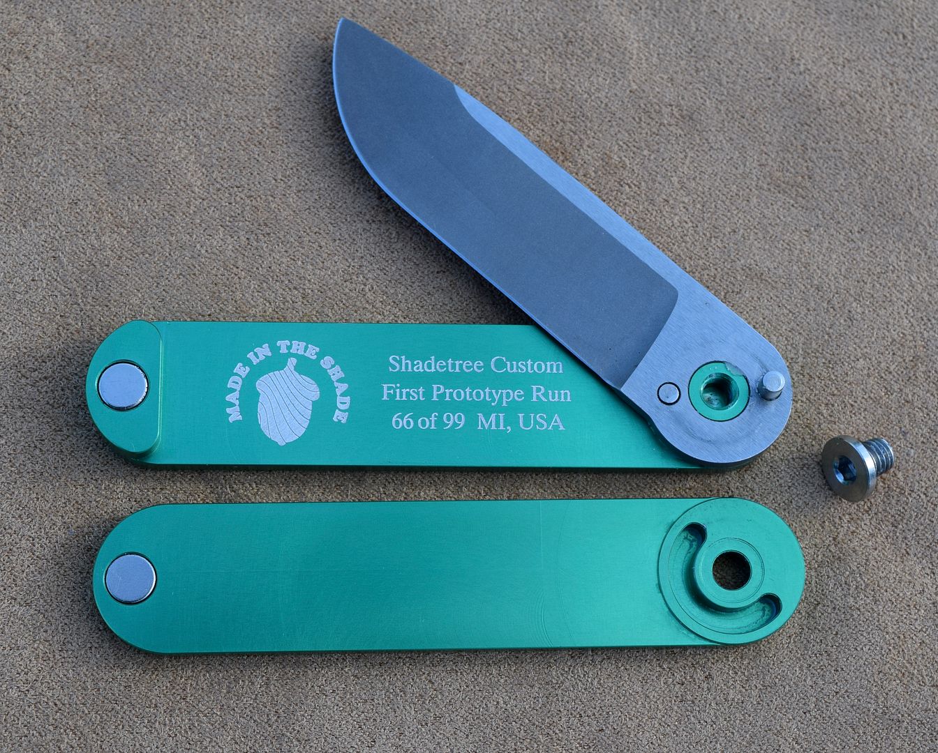

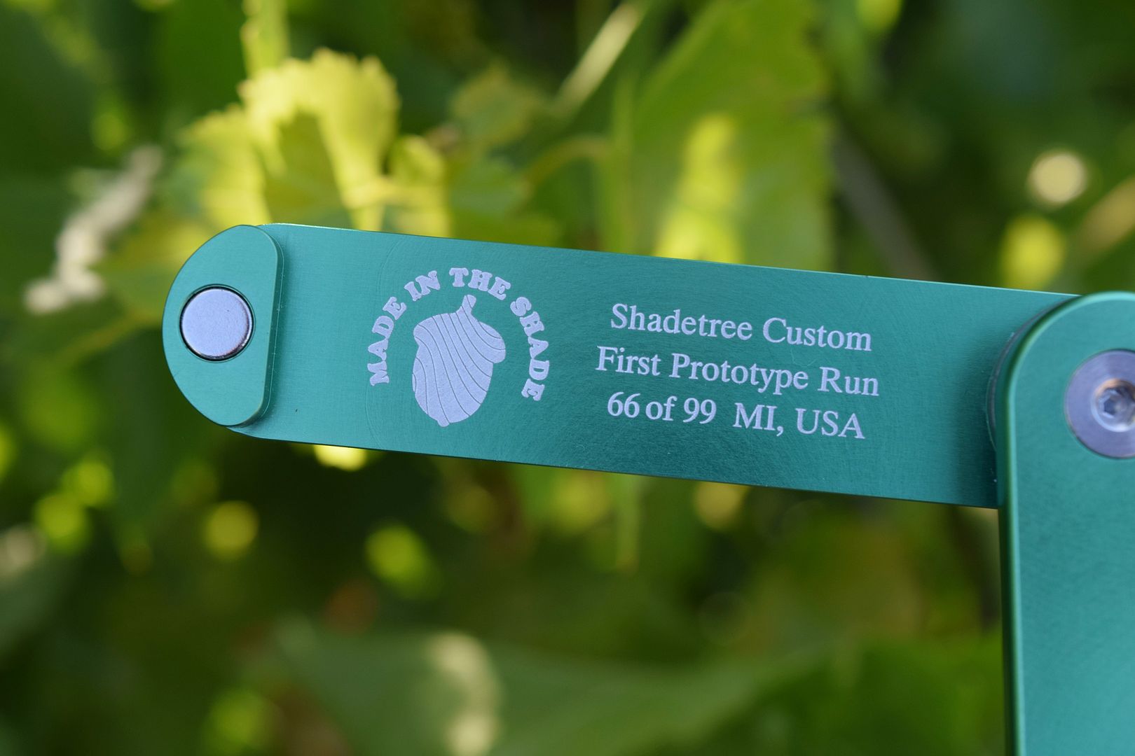

My sample Acorn is serial number 66 of 99 prototypes in this run. This information is laser etched onto the inside surface of what I will call the primary pivot scale. All of the component pieces for this run were manufactured by local suppliers to Shadetree in Michigan. It is always nice to see manufacturing stay in the USA. I am not aware of any plans to change this arrangement for future production runs.
[/URL]

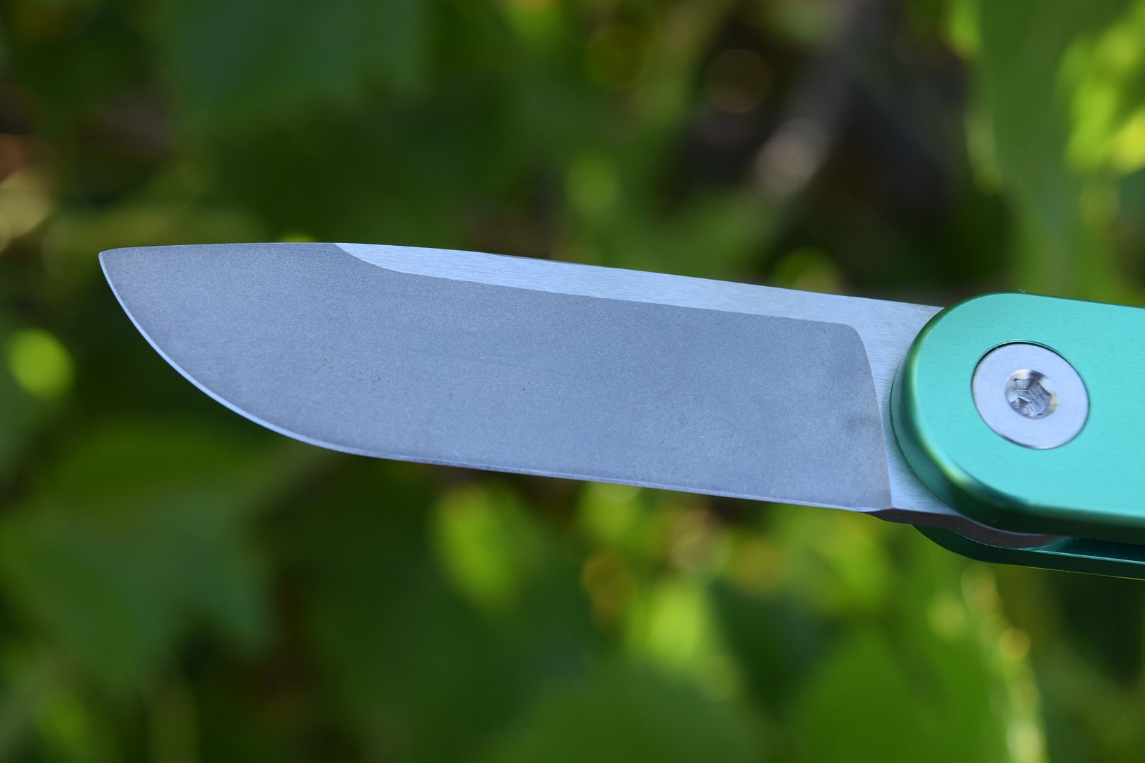

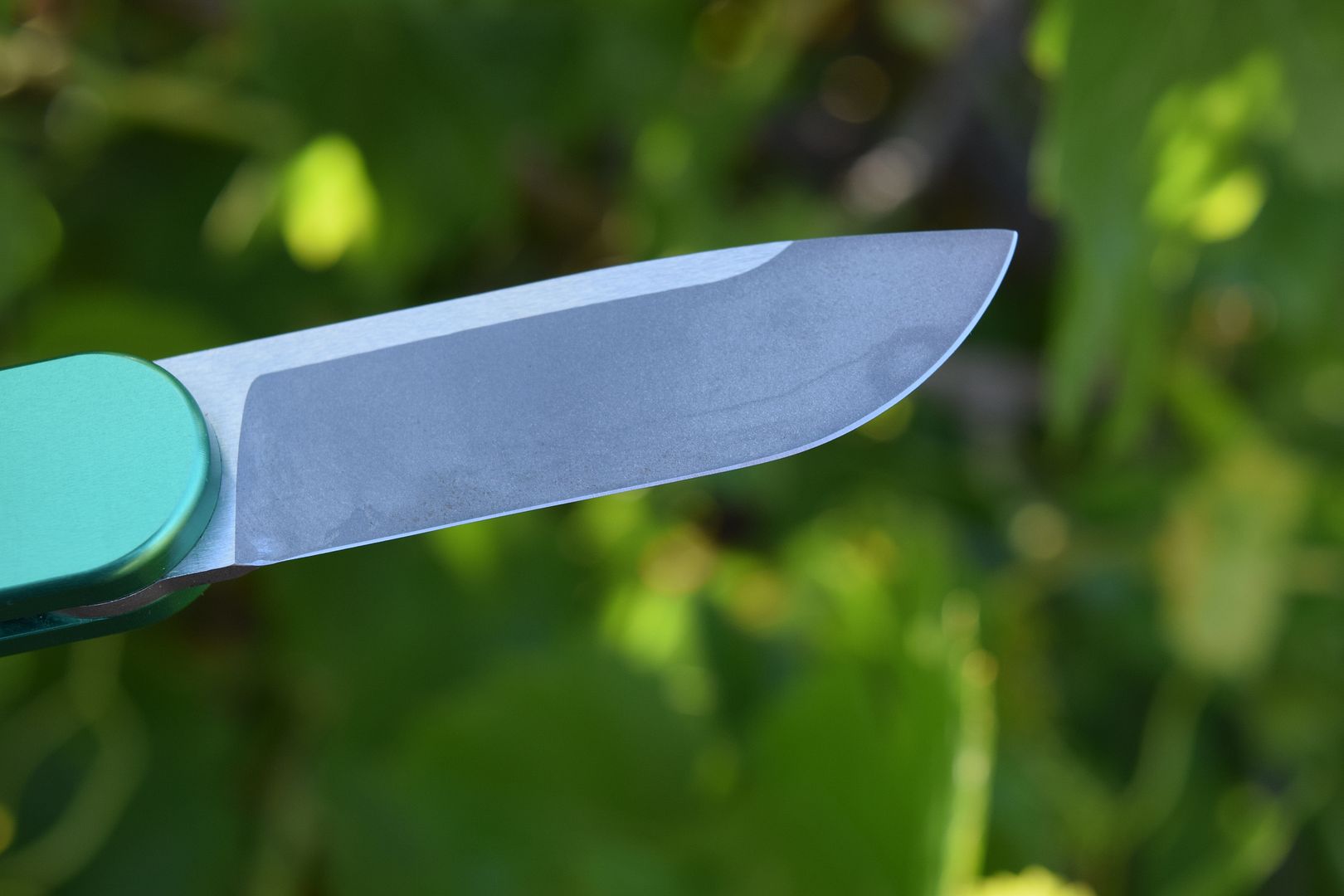

The S30V Jack-style blade has a flat primary grind with a V-grind secondary edge. The flats and pivot section of the blade are surface ground for consistent size and smooth finish. The blade was sharp enough as received to cleanly slice paper over the full length of the edge. Note: Both the blade and handle are guardless.
[/URL]

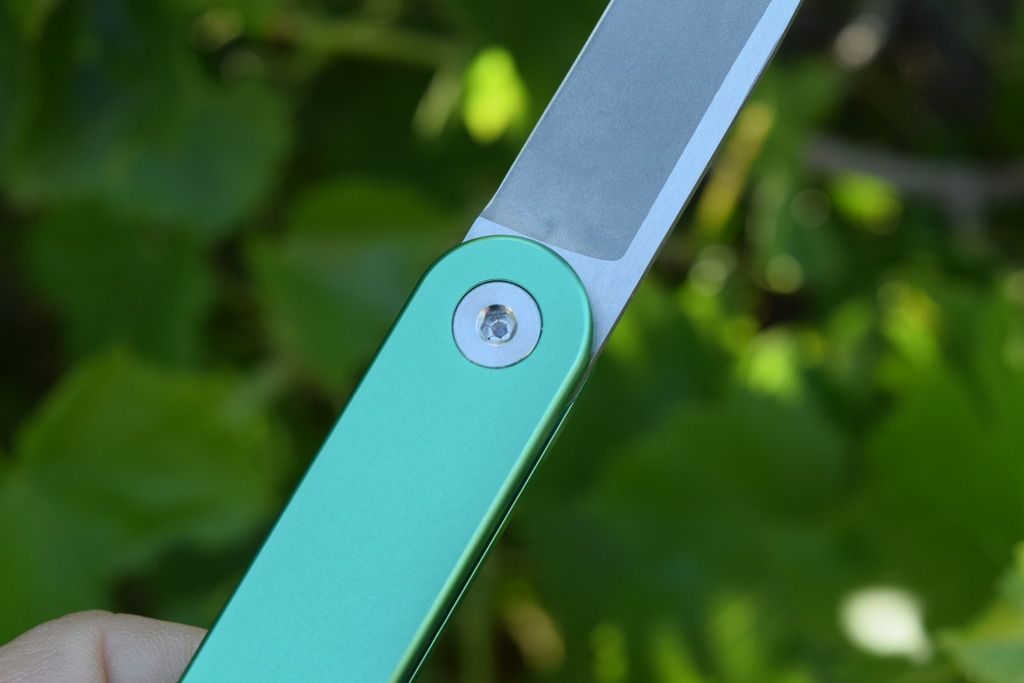

This is a washer-less design with the blade directly sandwiched between the two handle scales.
[/URL]
The knife is held together by a single hex-headed stainless steel screw that is mates into female threads in the primary pivot scale. This photo also shows the smooth radius machined around the handle.
[/URL]
The knife opens and closes by rotating one of the handle scales 360 degrees to secure the blade in either position. The rotation is very smooth throughout its motion. This indicates good parallelism and finishes on the mating surfaces.
[/URL]
The rare earth magnets are housed inside the back end of the handle scales to hold the handle in the open or closed position.
[/URL]
The handle scales are simple and unadorned. There is no pocket clip or lanyard hole.

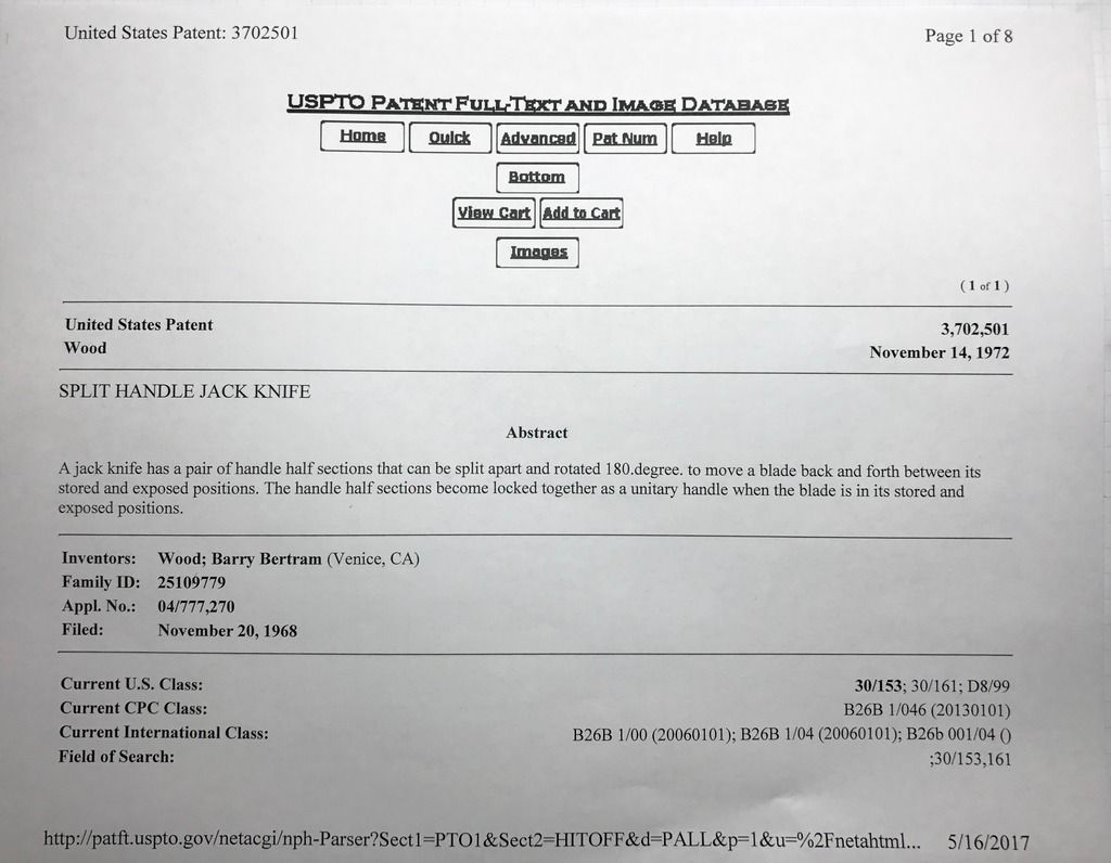

The idea for the split handle swing lock design goes back quite a ways. There were several U.S. Patents filed in the 1880’s for what was originally called a “Clasp Knife” and various other nondescript names by other inventors.
Here is a sketch of one of the early patents from 1887 that shows semi-circular pivot cut-outs and opposing crosspins through the blade tang that ride in the cut-outs to open and close the blade.
[/URL]
Most people who are familiar with swing lock knives think of Barry Wood as the knife maker who brought it into the modern era with his improved version of the design along with some very well crafted handmade knives. He was granted U.S. Patent # 3702501 on November 14, 1972 for what he called a “Split Handle Jack Knife.” His patent covered a new locking design for the pommel end of the handle that incorporated a locking pin and locking hole in the opposing handles to lock both sides together as a unitary handle whether the blade was in the stored or exposed position. The “lock” feature was released for opening or closing the blade by means of a notch on the top back end of the handle that allowed finger pressure to pry apart the handle enough to overcome the engagement of the locking pin from the hole. If this all sounds overly complex, don’t fear. I owned a Barry Wood Mk .1 a couple of years ago and I can tell you from experience that it is much easier to use than it is to describe the function in words.
Here are the first couple of pages of Mr. Wood’s patent along with his sketch for the design.

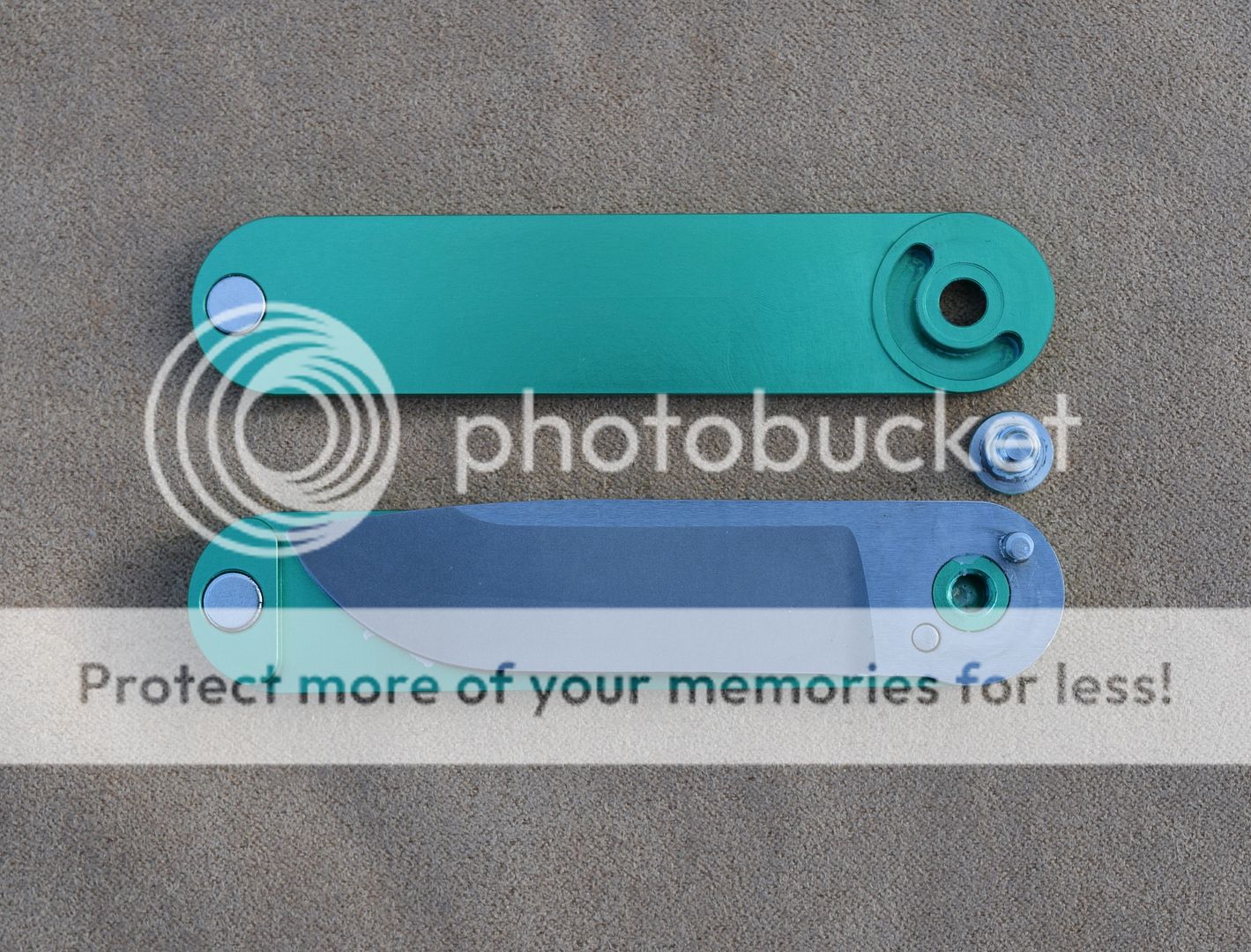

The construction of the Acorn is relatively simple because the machine work is very precise. Technically speaking, there are eight component pieces that go into the knife (1 blade with 2 opposing crosspins, 2 handle scales, 2 magnets, and 1 pivot screw.)
Here is what you see when pivot pin and top of the handle are removed. Note the position blade edge in the closed position. It sits far enough away from the bottom of the handle to provide a good margin of safety.
[/URL]
The circular pivot section on the inside of the handles sits approximately .020” higher to provide blade clearance from the rest of the handle.
[/URL]

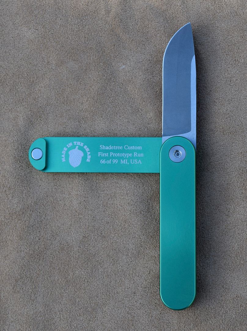

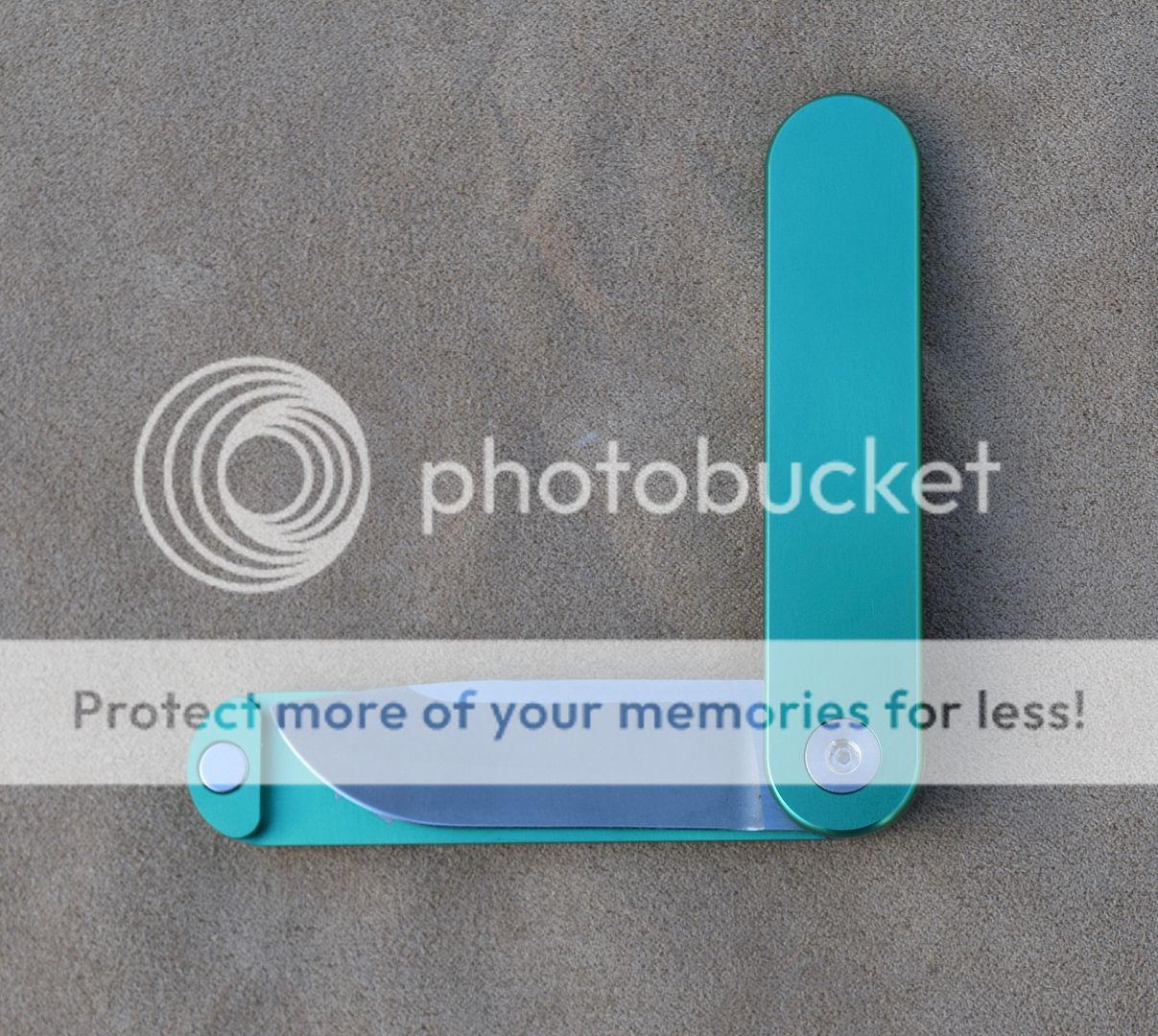

The opening and closing sequence works as follows. Remember that each opposing cross-pin in the blade has only 180 degrees of free movement in its corresponding groove in the mating handle scale.
Starting in the closed position, the cross-pins are located in the 0 degree position of their respective handle grooves. The blade is locked from movement in this position.
[/URL]

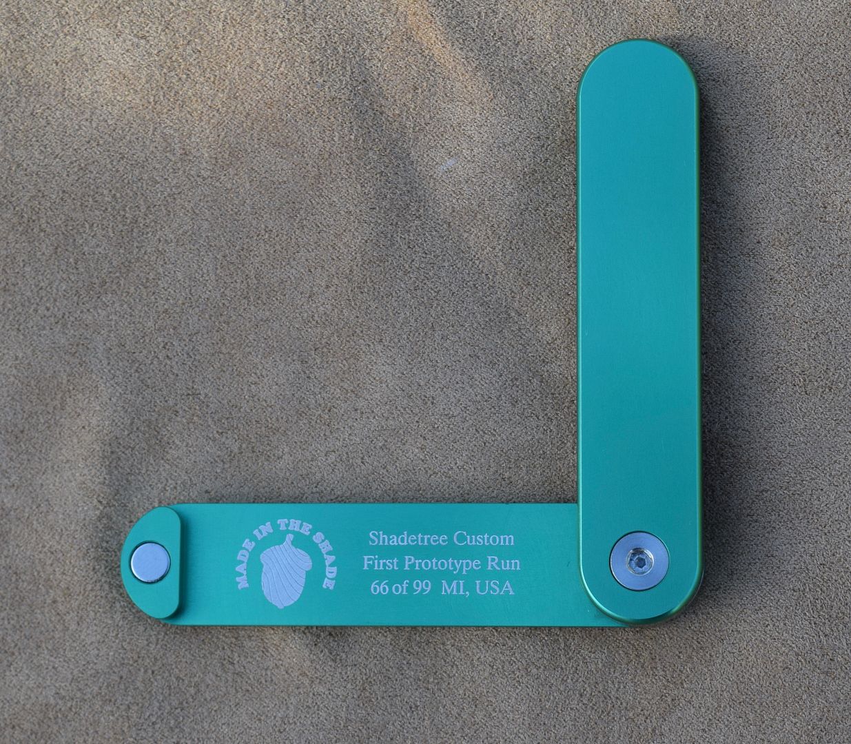

Rotating the top handle clockwise 90 degrees does not cause any blade movement from its closed position.
[/URL]
Continuing the rotation another 90 degrees places the cross-pin at the end of its 180 degree arc inside the top handle. Continued rotation beyond 180 degrees will apply torque that starts moving the blade and the bottom cross-pin through its arc.
[/URL]
Rotating the top handle another 90 degrees moves the blade a corresponding 90 degrees on its arc to toward fully opening.

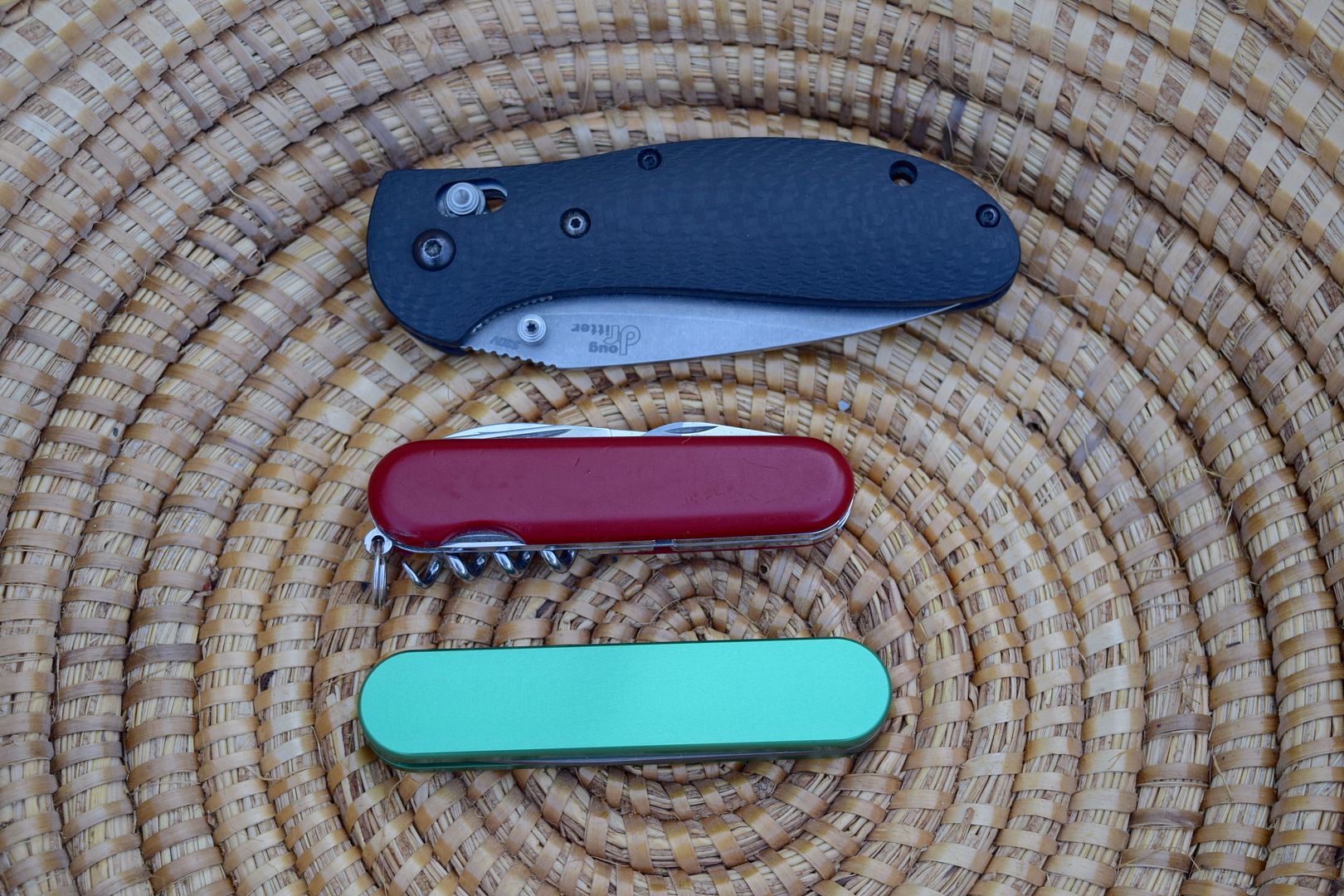

I normally like to incorporate a lot of comparison photos with similar knives into my reviews. The fact of the matter is that I am mostly a fixed blade knife user with a very limited collection of folders to draw comparisons to.

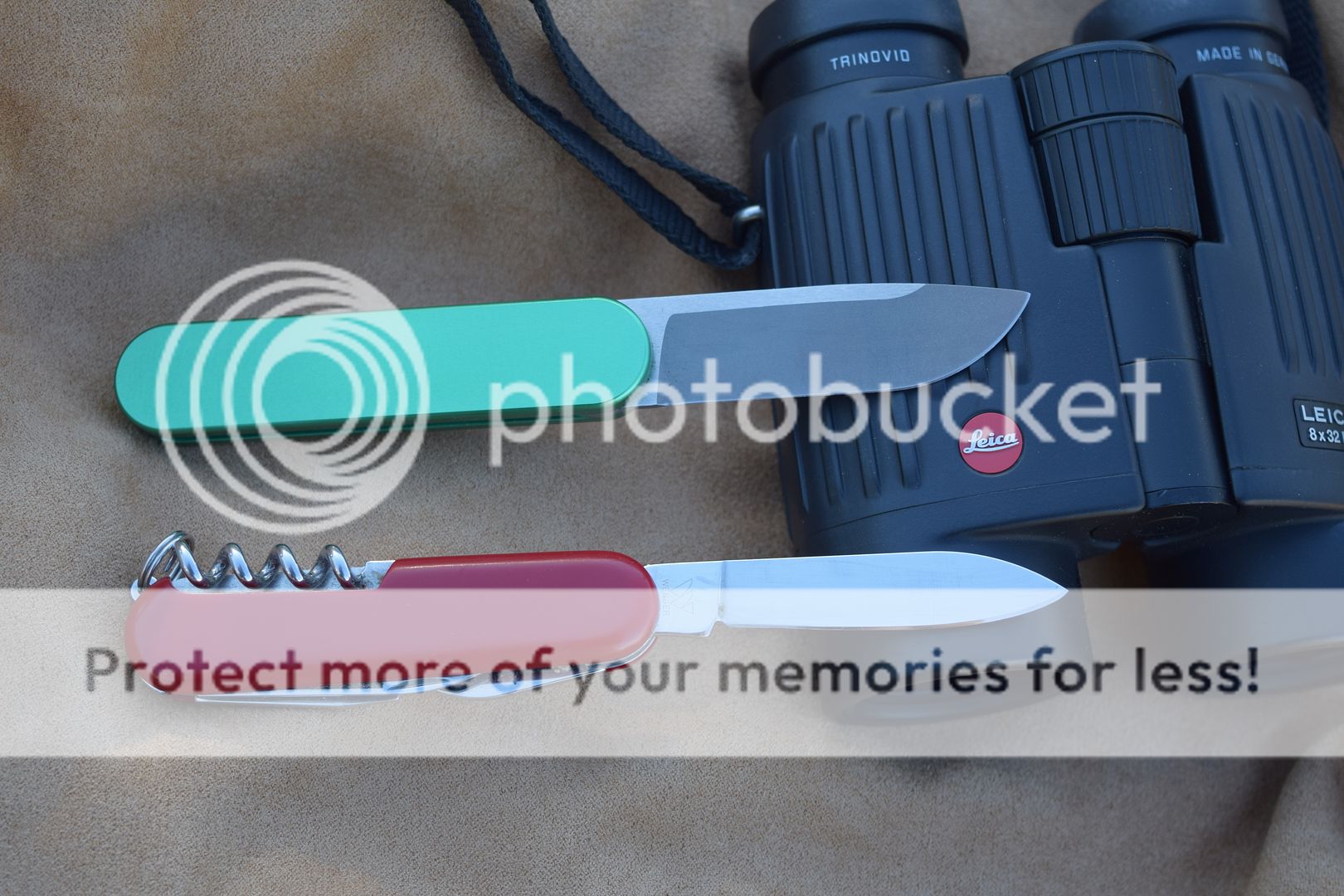

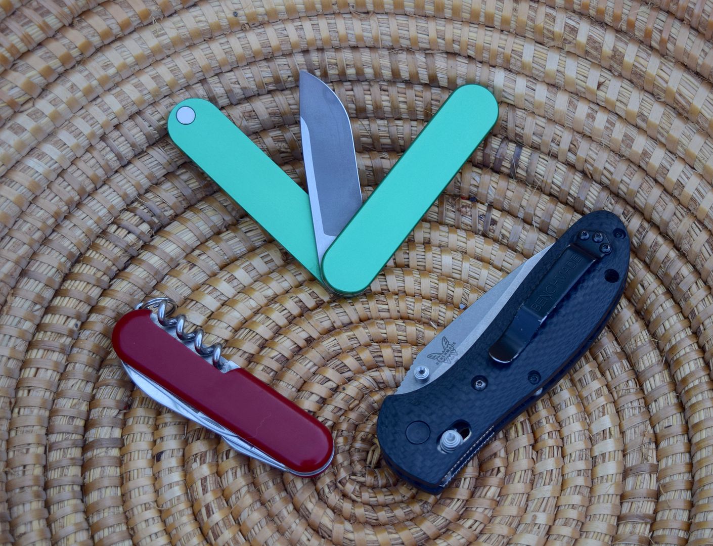

Here is the Acorn shown with a full size Benchmade Ritter Grip and a Wenger Swiss Army type knife. I only carry the Ritter Grip when I have a specific purpose in mind because of its overall size and weight.
[/URL]
[/URL]
The Wenger has been my regular carry pocket knife for the last fifteen years or so. These two knives are almost identical in weight. The Acorn handle is .025” longer, .075” slimmer in width, and .022” shorter in height than my Wenger. In less technical terms, The Acorn is a size and weight that I would feel comfortable carrying everyday.
[/URL]
The main difference to me between these two is the blade shape and utility. Even though the Wenger blade is .010” longer overall, it offers .490” less cutting edge length than the Acorn due to the long ricasso section of the blade. I call long ricasso sections on knives “dead space” because they are not useful to me in any way. The Acorn does a nice job of keeping the ricasso to an absolute minimum. This allows me to get closer to what I am cutting for increased leverage and control. I really like the choice of 3/32” stainless blade stock and the high flat grind on the Acorn.
[/URL]

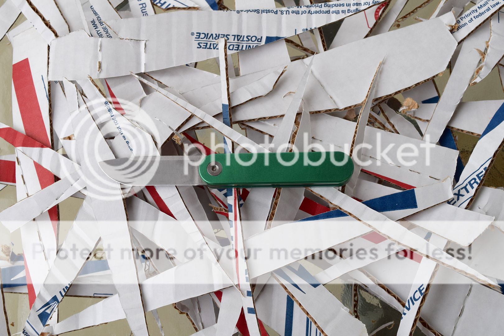

In-Use Comments:

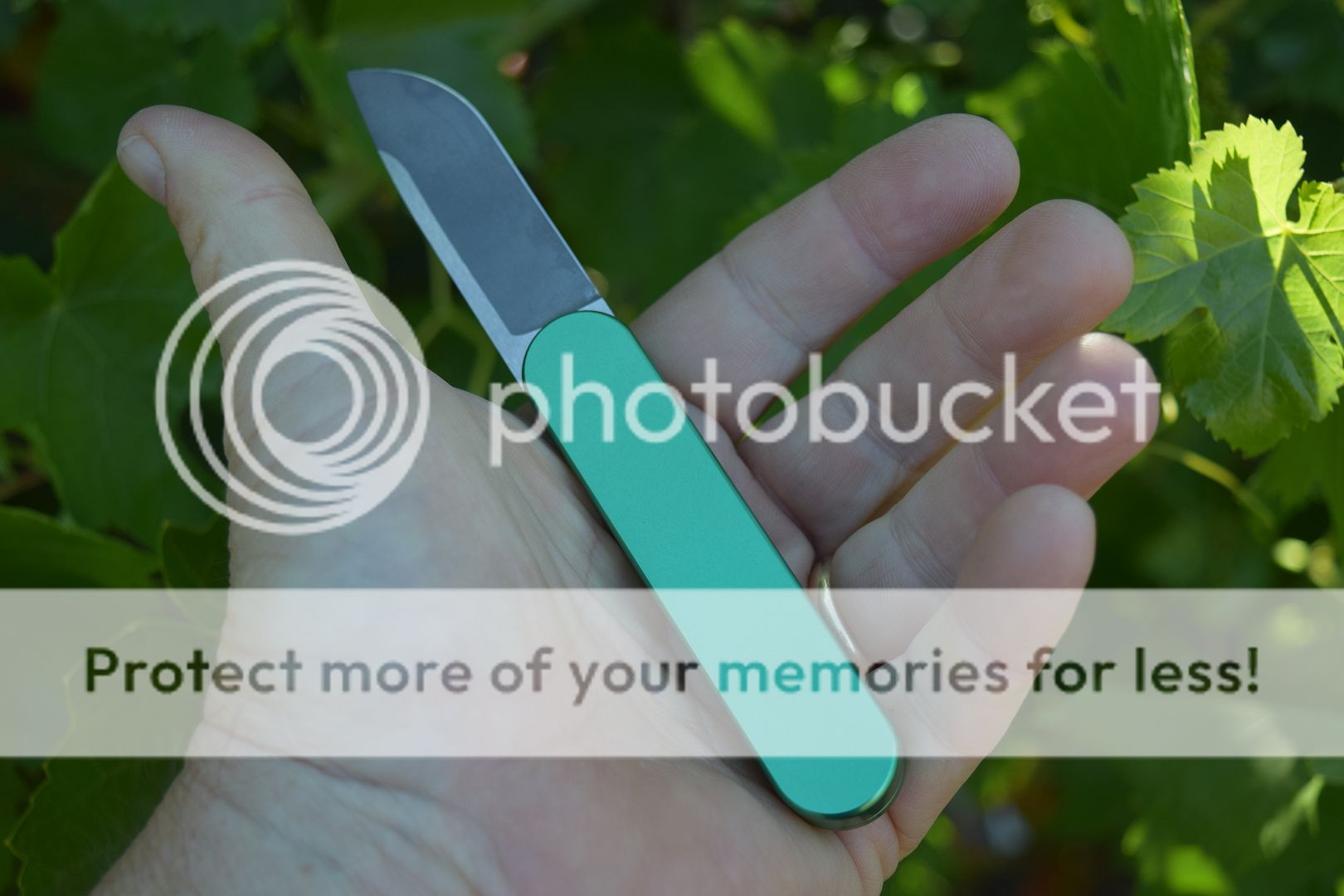

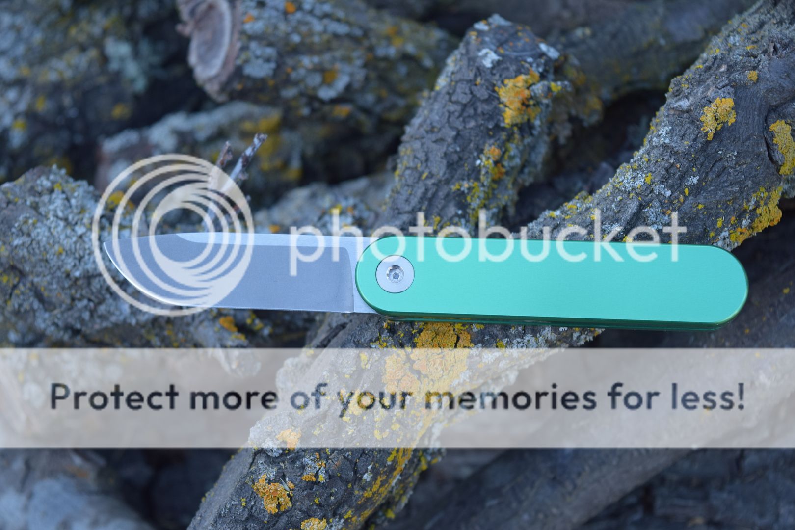

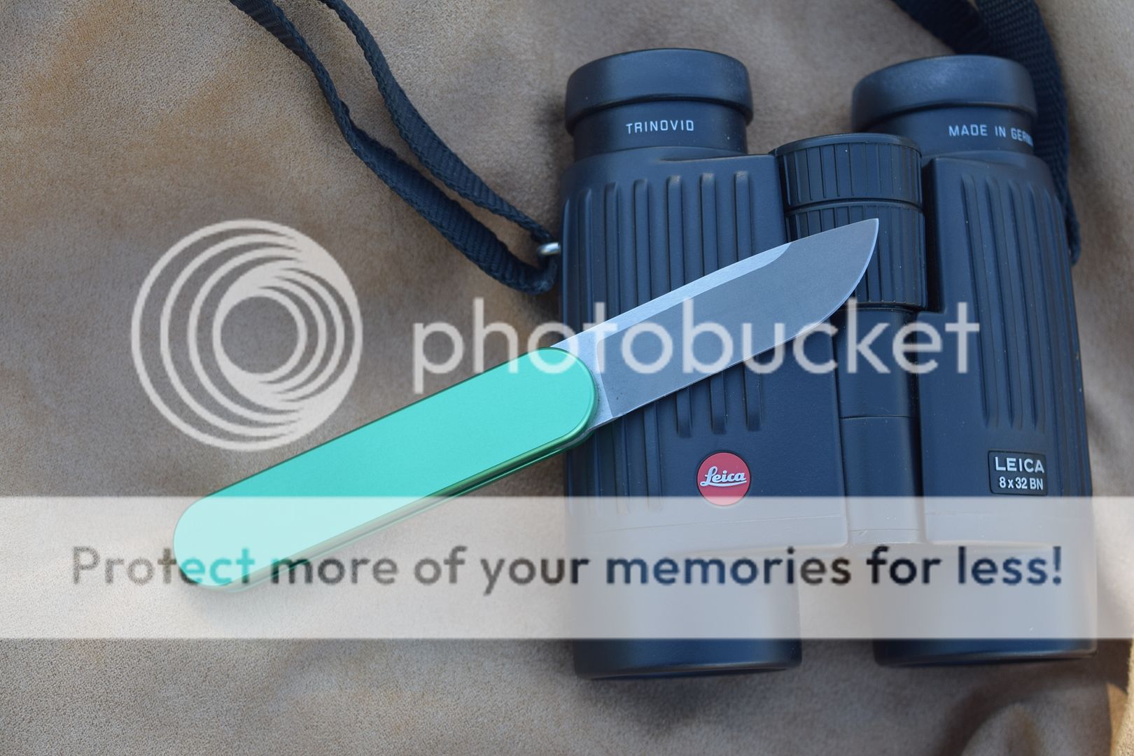

I found the Acorn to be comfortable in hand thanks to the radii of the handles and the rounded pommel shape. That comfortable smooth finish also means you must use care to not let the knife slip out of your hand. (My palm is 4” across for reference.)
[/URL]

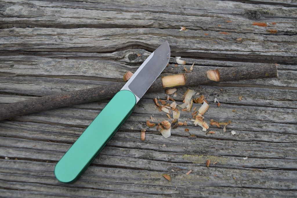

I tried the Acorn on the same type of tasks I typically use my Wenger for. I started by slicing up some cardboard for the recycle bin. The Acorn sliced through it with ease thanks to the thin blade stock and high flat grind. I cut-up several boxes before checking for edge retention by slicing thin paper cuts. All good here.
[/URL]
Slicing food like an apple for lunch is a simple task with the Acorn.
[/URL]

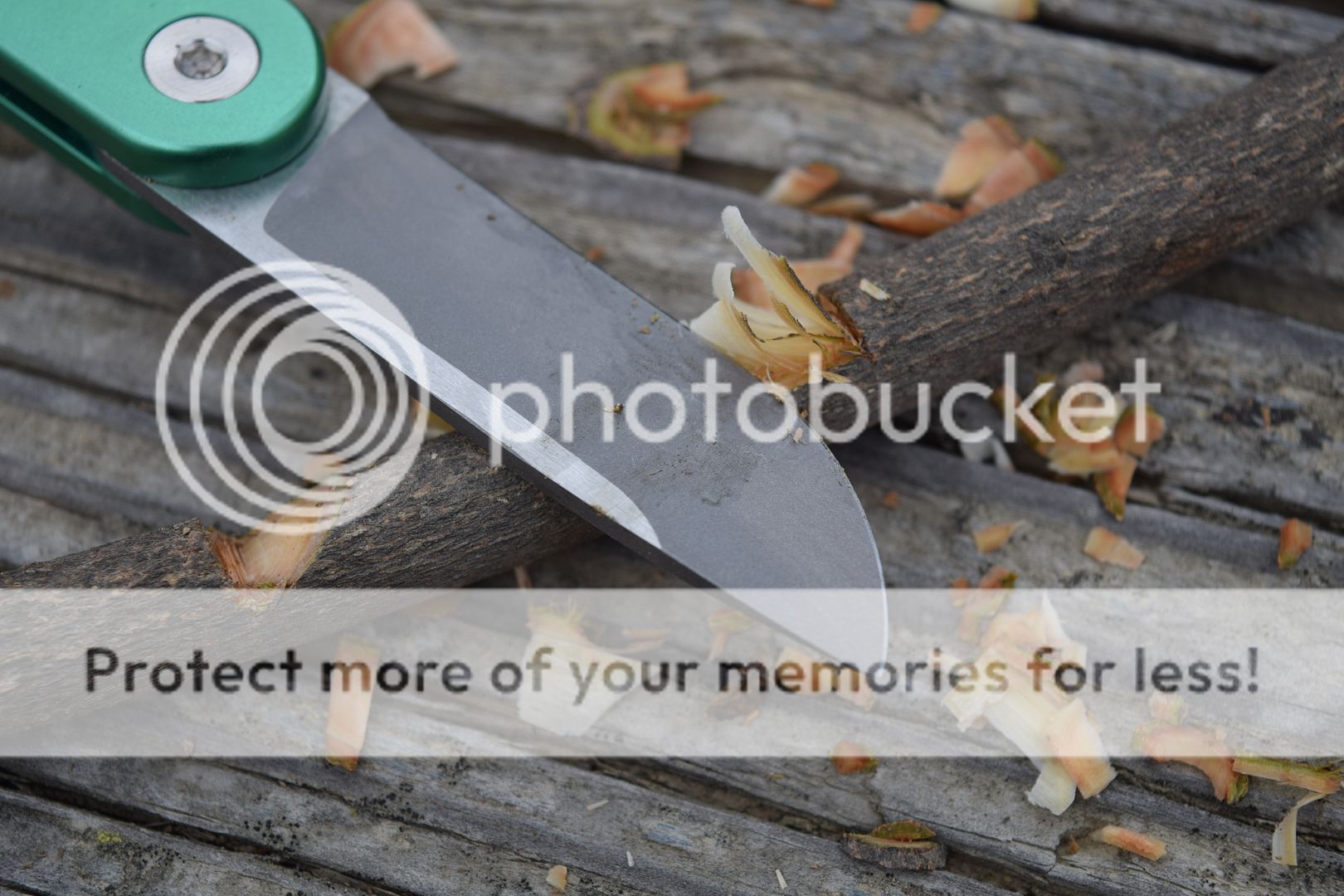

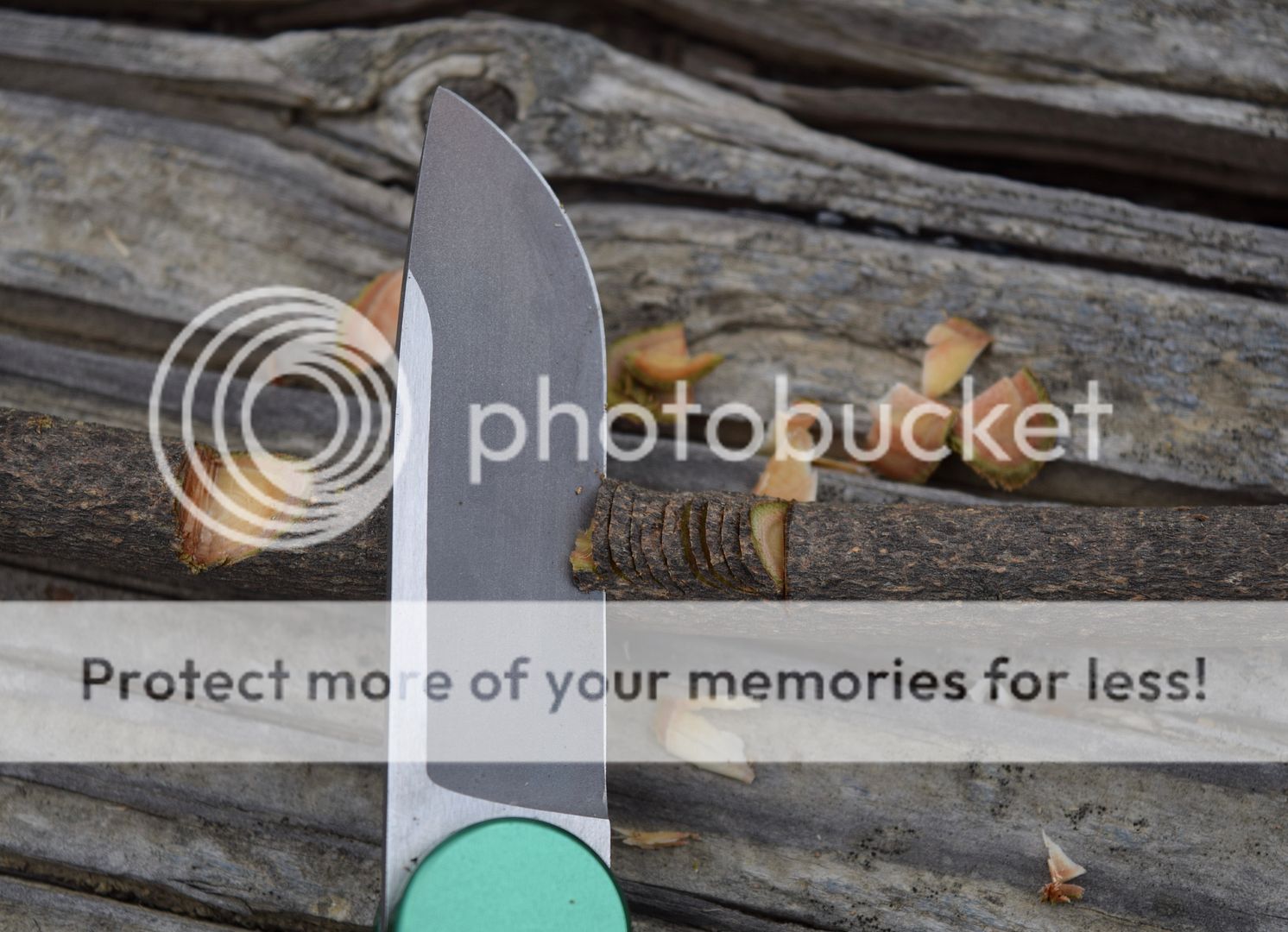

Next I tried it on some basic wood notching. The blade bites in easily and produces nice thin cuts. I like the close proximity of the back of the edge to the front of the handle for work like this because it allows Puukko-ish like control and leverage to the wood for precise cuts.
