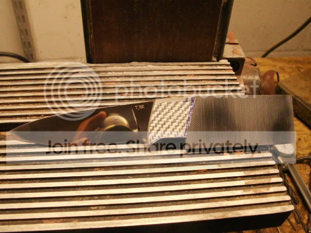

Alright Shady, here is my vision. It is missing the stainless .020 spacer between the tex and the black G-10. The blade is sanded up to 800 grit, and I purposely kept going after the paper was burned out real slow to kinda "polish" the steel. you can still see the 800 grit scratches but change the angle and it looks like a mirror.
Oh yea, the feedback. The tex cuts real nice on the bandsaw, but you can tell it is noticeably softer than commercial G-10. I have not encountered any difficulties working with the stuff so far because of that. Quite easier to remove material compared to G-10. we will see when I finish the stuff to 600 or so. Has anybody had to use CA to keep the fuzzies down?
Tim

I could understand why some folks might be scared of the "S" word! The thing that folks have to realize is that pretty much any form of poly or epoxy resin is going to be more pliable than phenolic on any day. I cannot put a dent in the stuff with my fingernail. The only way anybody can really tell that is it deifferent is when they start cutting and stock removal. Personally I like the fact that it cuts and sands easier. My comparison would be solely to any other form of G-10. Using wood as a comparison is like comparing apples to wheat!!:D To be honest with you I would rather use a linen laminate from you than buy the storemade stuff if it is easier to work and shape.

well, I have been so busy with a construction project I've been slacking- but here's a trout and fowl that I'm in the middle of bluing up, done with the greenish yarn sample. came out pretty camo so far. everyone in the house and at the worksite love the way the phenolic is coming out.
most of the finishing is taking the material down to 320 and then using steel wool.
the fuzziness goes away pretty fast at 240 grit hand sanding, it still feels softer somehow than the harder plastics I've used, but I don't know how to describe the feeling. less glassy? the knife is plenty comfortable
