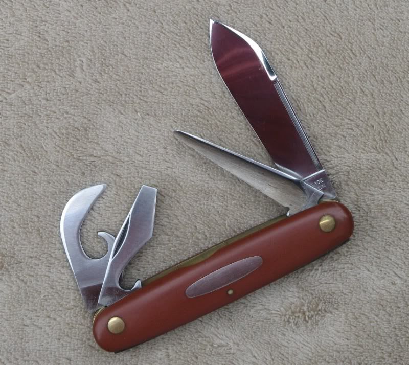

Here's a shadow of sorts.
This one is very interesting. Who made it, please?[/QUOTE]
I have no idea. There's not a stamp or mark on it. The nickel silver on it looks to be German to me because of the color. I posted it on BRL's forum but no thoughts.
