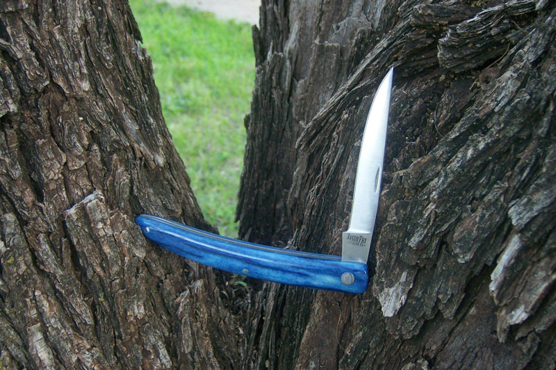

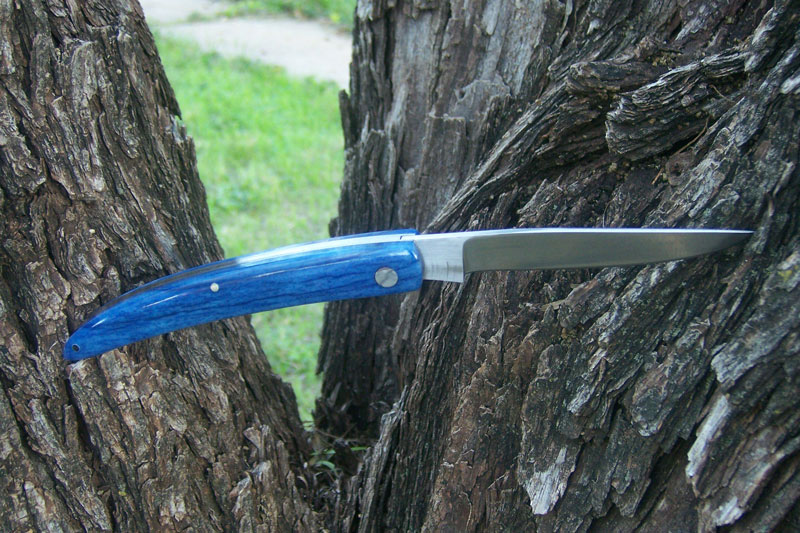

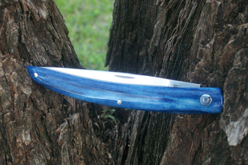

So I started this idea back in November. Finally finished the knife this week. You can tell I wasn't in a hurry :) The swedged blade and spring are CM154 stainless steel. This knife also has 410 stainless liners and 416 pins. It's got a smooth, medium pull with a crisp half stop and good "walk and talk." The handles are blue dyed giraffe bone, buffed to a high shine. I chose this design primarily to take full advantage of the size of this set of bone. Closed length is 5", open length is 8 3/8".
Nice work!! It has great lines!! I'd be mighty proud if I could do that!!
No kidding! That looks awesome! I've always wanted a knife with blue bone just like that for some reason. Great job!
