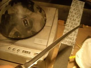

here are some pics to hopefully help you understand a burr. this one is exagerated for effect, so your burr probably won't be this big (this was ground hard on a dull 40 grit belt)
non-burr side:
burr-side:
see that bright lip hanging on the edge on the burr side? that is the burr. holding your knife like this, edge down, under a bright light can show you a burr well. you can also hold it edge up right under a bright light to show you if you have any flat spots (they will look shiney)...instead of looking for a burr. if you have any flat spots, you aren't getting a burr, and you aren't getting sharp.
