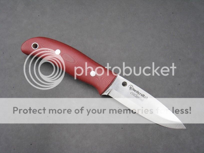

I have plenty of fancy equipment in my shop, yet I often still go to round and half round files to shape micarta. Anything you would use on metal will work on micarta too. Sometimes I even leave my micarta handles as is, straight from the file, as it leaves a nice, subtle, grippy texture.
Here's an example of one I did using only files - no grinder or sandpaper whatsoever.

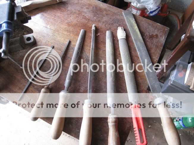

So, what tools. Same as I use for wood.
Those Auriou rasps are lovely, but they are total overkill for Micarta. They are expensive and Micarta is hard. That Japanese rasp made of saw blades will work on the flats but a nice cabinet rasp is better. Not a half round rasp, a cabinet rasp. Same rasp gets used for a lot of wood shaping in my shop, so its not a one-trick-pony.
Square 10" bastard cut file will do a lot of the refining, and a 6" bastard cut will do the rest. Half round files are nice, but you don't need them except where your index finger rides, and you can use a dowel and sand paper, or a Dremel for that area.
Lots of things can be used to provide backing for sand paper to even out your file work.
Results are slower, but every bit as good as anything produced with power.

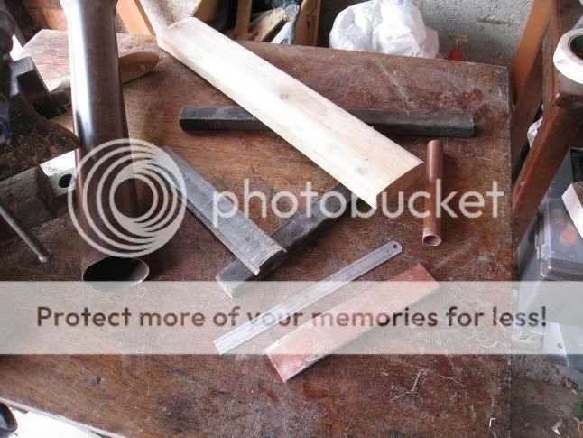

Whole process I still use...sorry I never posted it here, just so as not to be sending folk to another forum. :o
https://www.spyderco.com/forumII/viewtopic.php?t=44349

Never use the rasp on the rivets! That is the second fastest way to kill the rasp second only to rasping on the tang! In that thread on the Spyderco forum it shows how I work around the handle fixings with the rasp, then change to the 10" square file to cut the bolts and tubing back. Its not a bad way to work, a little annoying, but not a killer unless your have to make money. That problem is one of the places the belt sander scores really high, being able to shape both materials quickly.
