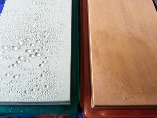

The 1k and 2k are very different...
2k is smooth, 1k absorbs water more quickly.
with 1k
with 2k
completion leather and paste to polish luxor (green/gray/white)
Sebenza 25 (S35VN 58-59 HRC)
Now with Doug ritter M390 (60-62 HRC)
with 1k, 2k, naniwa 3k and finish leather + luxor
1k is much rougher, 2k is smooth like the marble.
2k removes heavy scratches to give a matt finish, it facilitates the transition to the next stone.
You can go 1k > 5k .
but with 1k - 2k - 5k you go faster.
