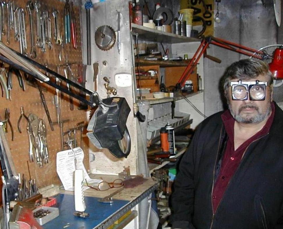

Your system in the shop is terrific, simple, yet very rational!

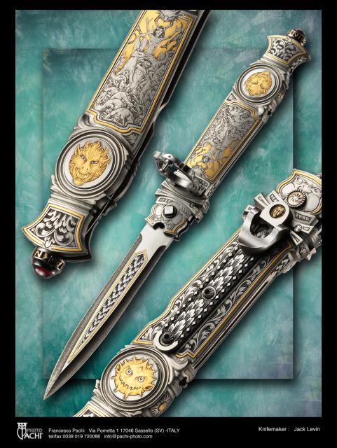

Just another archieve flier- Best of the Show in Atlanta 2004, pic used on the flier of the Blade show in 2005. Knife won 4 awards. Frame carved from the solid piece of titanium. With pics I just fill up the gaps between advices, or when I have nothing else to say :)

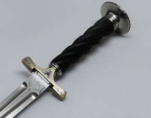

If anyone will be interested in alternative method of making the fluted handle, as the one from Ebony Gaboon on the picture below, just raise your hand :). I will type the separate description. Method which allows to make very accurate, symmetrical fluted handle from any wood, or ivory.

I would be tickled to see another method of fluting a dagger handle.
Here we go- fluted handle as on the pic above.
If you want to make a fluted handle, you will need divider, lathe and milling machine.
First, Jack mounts the divider on the milling table, then puts the special end mill in the vertical spindle of the milling machine.
You can make the end mill yourself. Use old center drill with the edge and dress it as a funnel shape.
Put a spindle diameter with the cross thread and original bronze nut 3/8 diameter in the divider. This spindle you can make from an old Yankee screwdriver.
Then take the piece of handle material -wood or ivory and drill through a hole 3/8-th.
Put it in the lathe machine and turn handle material down to diameter of the handle you need.
After it put the original bronze nut in the hole of handle material, put it on your spindle and support end of the spindle with the dead center.
Then take any screw and put in a handle material through from any side, reach the nut end and tighten the nut.
All this composition will remind screw and nut. The revolution of the end mill supposed to be very high - 7 or more thousand RPM, be very careful.
Then, hold the handle material with your fingers and move it carefully back and forth along the spindle. Gently bring the end mill down. The thread on the spindle going to work as a screw and handle material going to travel according the thread on the spindle. After the first time you will get nice spiral cut. Milling divider going to help you divide the outside diameter of the handle by 4, 5, 6 or more equal flutes.
Change the position of the divider after every cut and make the next cut after it is done. Every time you will bring the end mill more and more down.
Result of your work will be a number of accurate spirals on the handle. But reminding you again – please be very careful. Remember: there is no knife to die for. It’s my interpretation of Jack’s instruction. There is no details-only the concept.

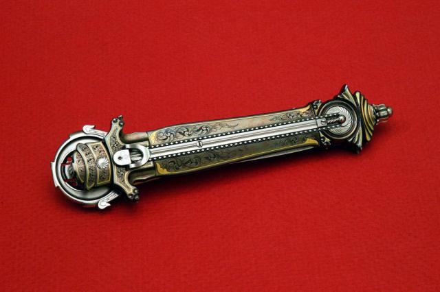

I think, this pic is from old issues of French knife magazine "Le Passion De Cou...". Knife "Don Quixotte" ( as the shape, carving and embellishment reminds of medieval armor) circa :) 1998, won Best Innovative in Atlanta for the automatic shield. For a long time in private collection abroad.

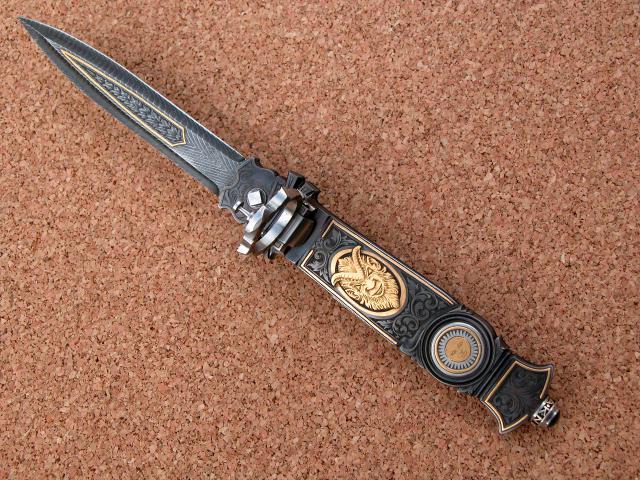

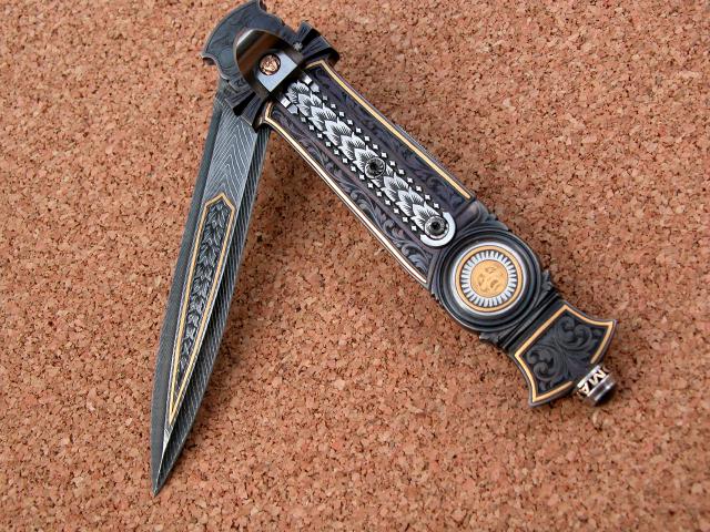

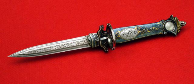

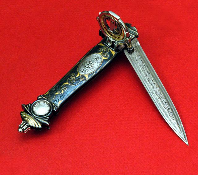

These 2 latest knives were engraved by John Robyn. Both in Europe

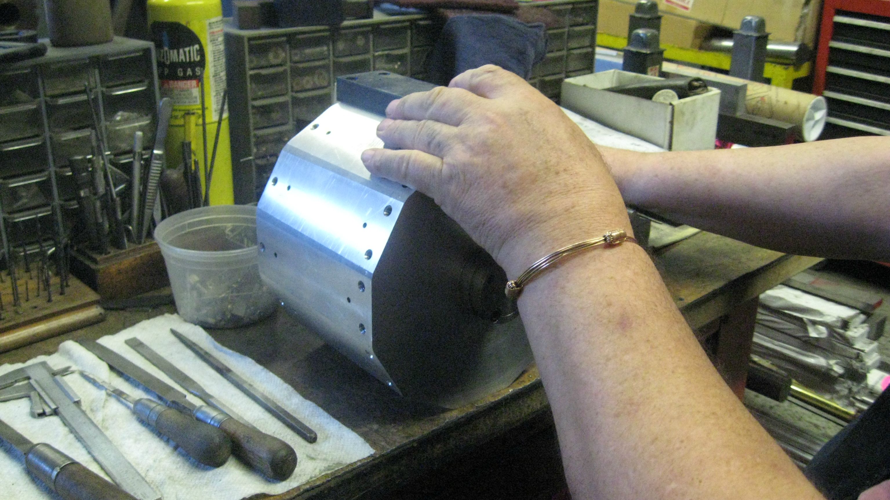

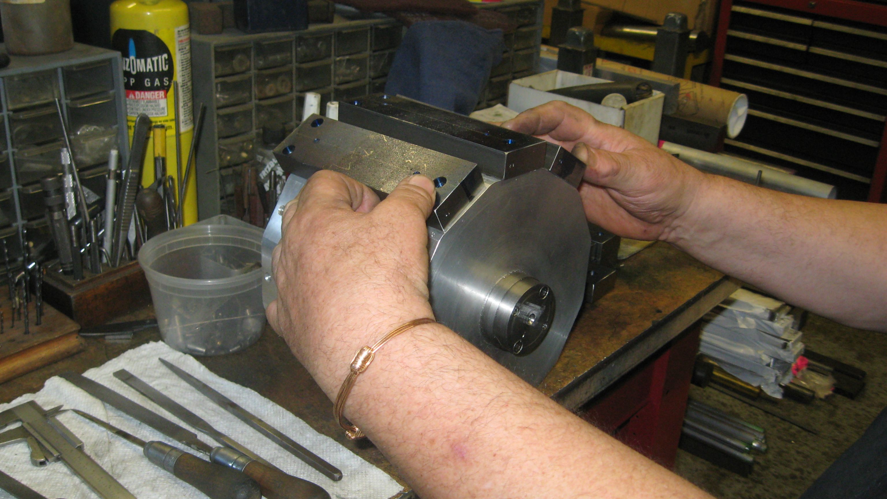

Here is last device invented and made by Jack. It is not completely finished and was never used, however, can be very valuable innovation. This is the drum for the mechanical method of removing the metal stock from the blade. Good for custom made and small editions. Drum may be loaded with 12 blades at the same time. Shape of the blade- “apple seed”. The benefits of using this method are efficiency, accuracy and few other important things.
P.S. Sorry, Jim, can’t shoot better pics, as the device is not in our possession. Unfortunately, we lost it without any compensation for Jack’s invention and physical job.… He tried to bail out this invention, but no success...
Any technical questions - welcome.
