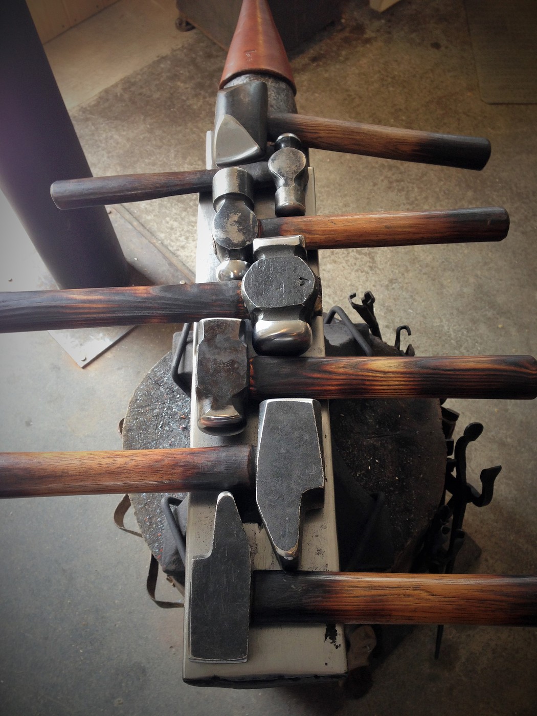

I was reviewing my hammers and thought I'd share what I've learned for me.
The hammer that I keep coming back to over and over is the one on the left in blue, a Vaughn ball peen, 40 oz head, available at McMaster Carr for $22. I have a Hofi style Big Blu straight peen, a Toruku 48 oz Japanese blacksmith and other cross pein. Previously I've had 2 other custom made for me, rounding and pein hammers. But again I keep coming back to the low cost ball peen. It just felt most comfortable all around,
Reasons why - I shaped the handle Hofi style and made the handle significantly shorter. Dressed the face to my liking. But then I just realized the head is way forward much like the Japanese blacksmith hammer!
So that overall balance and head forward works for me. That's why I keep coming back. to that hammer. The Toruku has too much weight forward (for me) and the Vaughn ball peen feels just right.
just thought I'd share :)

I always reach for my 32 and 40 oz ball peens too over my straight and cross peens. Although second most used would be a 2 lb Swedish style. The weight forward thing isn't something I had thought about, but reading this now makes me wonder if I should try out a Japanese style hammer myself.
These are my most used hammers... from the top...
3lb Double diagonal peen (reground sledge)
1.5lb Ball peen
2.5lb Ball peen
4lb Rounding hammer w/ squared face (it has since been replaced by one of my own making)
2.2lb Rounding hammer w/ squared face (reground maul)
3.3lb Frenchie
2.2lb Frenchie
