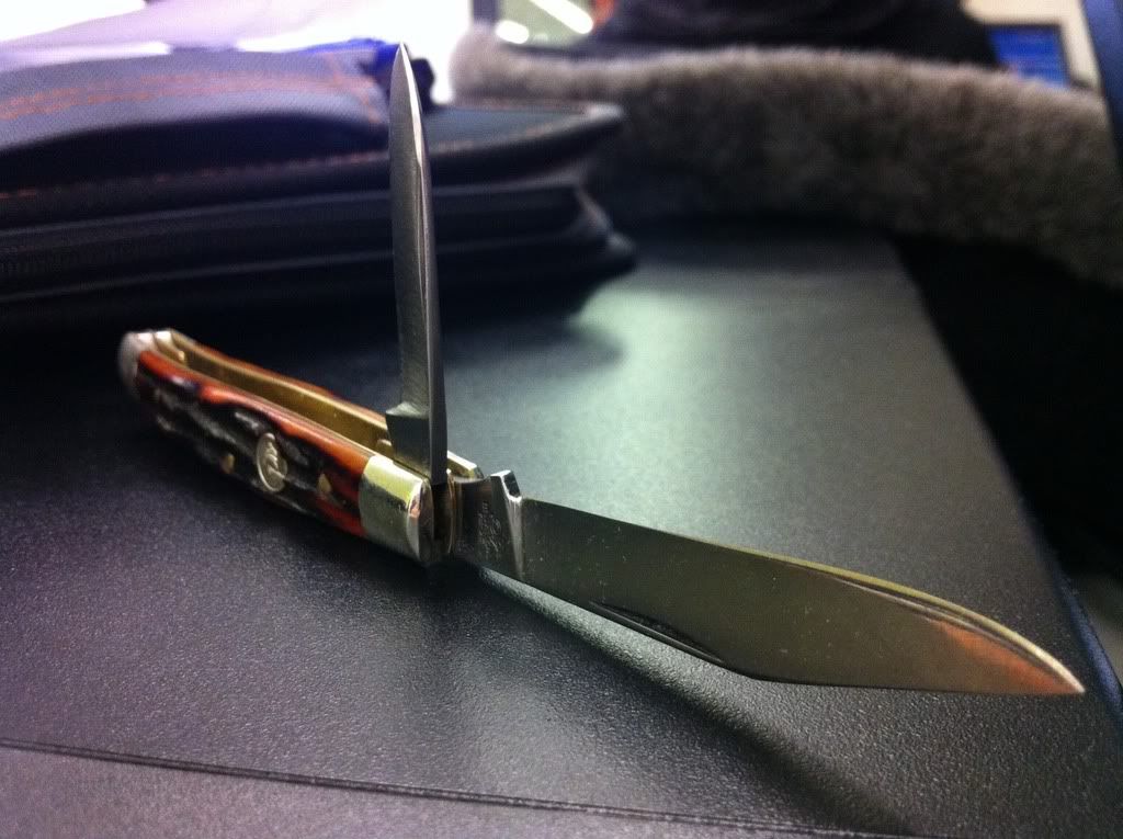

I've been doing test cuts (paper push cuts) with my new GEC White Owl and comparing it to other knives I have. The Owl came rather dull from the factory and I've been using my Sharpmaker to bring it slowly but surely to where I like my blades to be. I don't get anything hair shaving sharp. As long as it can push cut paper, that's sharp enough for me.
My Peanut just does it better.
Is this due to the thinness of the Peanut clip blade vs the White Owl blade? Or can I expect the same performance from both if I keep at it on the Sharpmaker (I am awful at sharpening free-hand. I've tried it. It's not pretty)? I guess I'm asking, inexperienced as I am, if the effortless feeling I get from the Peanut is based on blade thickness, rather than actual sharpness.
I've got the thinner pen blade on my White Owl performing as well as the nut. But my logical mind tells me I'm just not getting the clip as sharp as it should be. I'm afraid to keep going at it on the Sharpmaker for fear of eventually wrecking the blade, but each time I do use it, the blade is noticeably sharper.
Just not Peanut sharp.
Apologies if I should have posted this in maintenance. Just figured I'd get the best replies here, given the specific traditional blades.

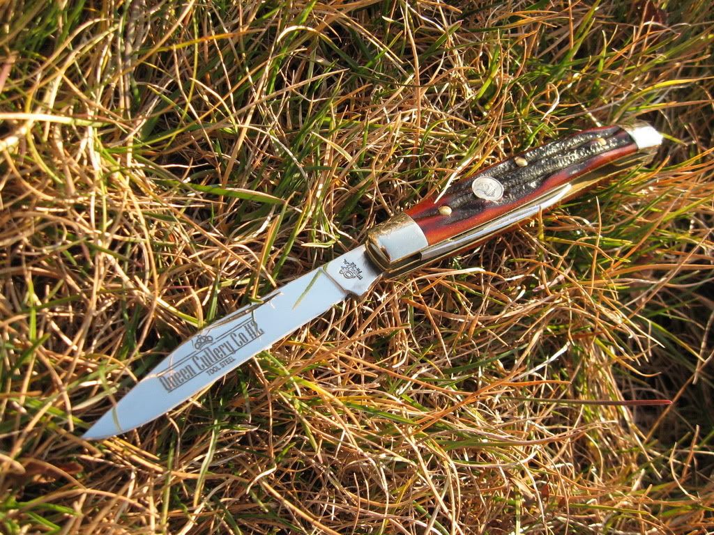

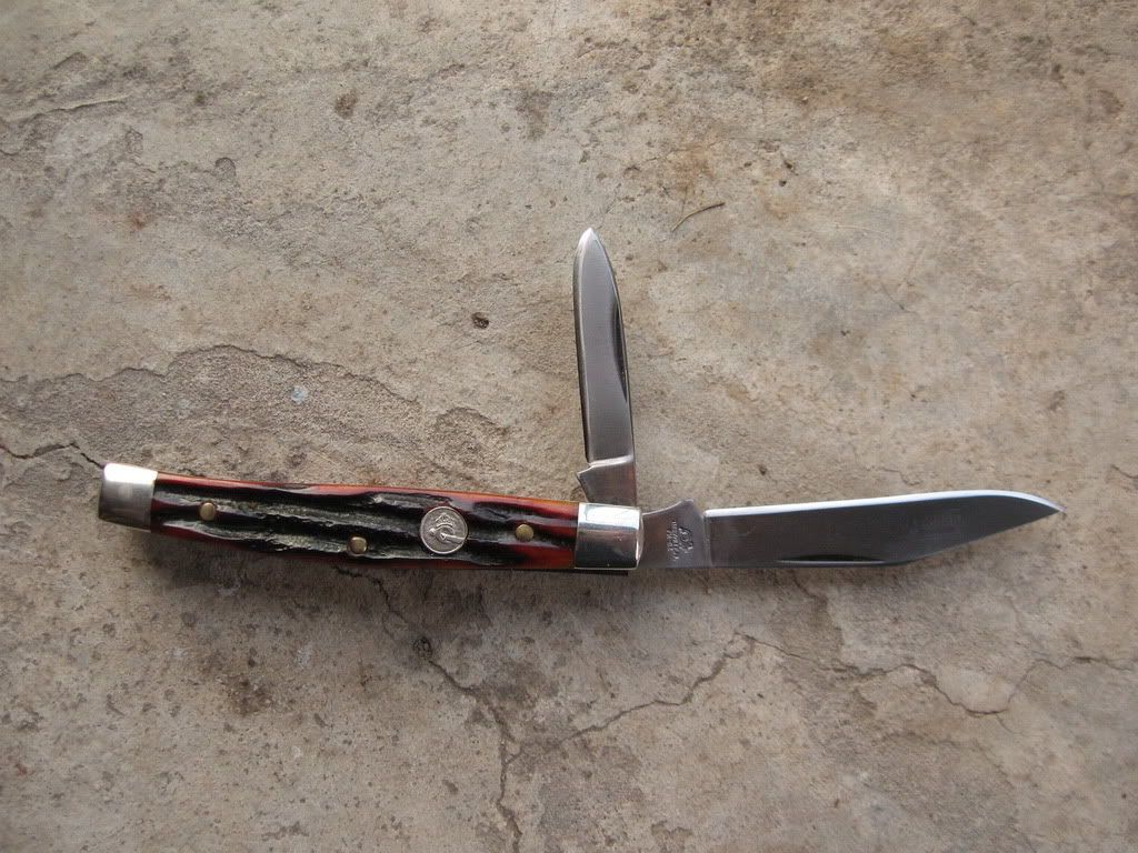

Same thing happened to me with a queen serpentine jack, which i did sharpen eventually to push cut paper, but still, the peanut was cutting better, some materials that is, like apples for instance. The jack was now performing admirably, and the paper was no match. But then i had the thing brought to peanut level, and now it performs even better.
factory edge,
My work, also with the sharpmaker, used the 30 degrees slot only, till i could make a 40 degrees microbevel
and finally, the thin regrind to match the peanut, (not by me though :D) now sharpened to a 40 degrees microbevel
