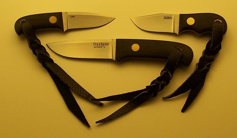

I tried to take some pics last night when I got home from work thinking if the whole house was dark, I could set up my photo box and things would be good, but when I uploaded the pics this morning I found that they were yellowed and fuzzy, I'm disgusted. I always want a to keep a picture of the knives I build for my records and I know they don't have to be perfect but I want them to be a lot better than they are, sometimes I get some good shots and then sometimes they're total crap. like last night. My photo box is like the first one you posted, I modeled mine after yours, as much as I can remember. I'll just have to go back through the threads and hope I can figure it back out. Thanks again for all the advise you post and those awesome images you post. You have truly been blessed with the talent to produce breath taking images. Later, Dwayne
Here's a couple of the pictures I took of a new pistol I traded a work folder for along with some neck knives I made for the local officers. You see what I'm talking about, Dwayne
Hi Dwayne,
OK, since you asked, this brings up a very common flaw. I'll bet that you shot both those images using the 'auto' white balance selection on your camera.
You would have gotten consistent results using a prescribed setting of, probably 'incandescent' or 'indoors' settings to get around the yellow cast of the 2800k (Kelvin color temp scale) indoor warm lights.
That said, I did a quick repair in Photoshop which allows for the correction. The first photo was lit properly and responded well.
Going a bit further, there is a tool in PS that uncovers the deepest shadows and makes it more like the eye sees it naturally. (Shadow/Highlight tool). You can now see the detail in the handle grips.
The second shot is simply a wreck....
Underexposed and the white balance was so far gone it still looks crummy.
My advice is for you to spend time re-reading the $75.00 No Frills - Home Studio thread and experiment in there. You can make it look even better with correct lighting, rather than post-processing adjustments.
Coop

Coop, nice fix and good advice. The color balance is way off in both, they really should be reshot.
Taken from Coop's correction, the highlights were still off. I tried to correct the color there but that just caused more problem.
RESHOOT.

Hi Phil,
Yeah, there is still 'warmth' in the metal on my redo. Perfection requires a reshoot with proper lighting. :thumbup:
