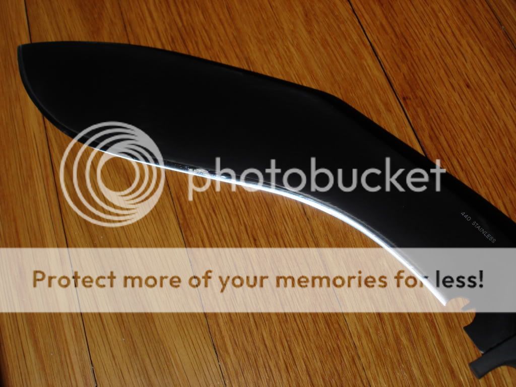

As I have found out the KuKri Machete from Cold Steel comes with a "Utility Edge" In my case...really bad utility edge...I was expecting a little bit of sharpness. I could fall on it and come away unhurt, it is that bad. So I spoke with them and they told me they could do it for 10 bucks or I could put it on myself. She recommended a 23-25 degree edge. What are the best tools you guys recommend and how to achieve this? Since the blade is so curved as well as long this look like it might be a bitch!
I had a Panga machete that came in pretty much the same condition. I used a metalworking file to remove the coating/set the bevel and I wanted and then used a small 2-in-1 sharpening stone from the hardware store to sharpen it up. I don't really need a hair-splitting edge on my machete, so that was good enough for me.
In order to get the inside of the curve you can use the edge of a traditional rectangular stone. It's not so tricky--just different. :):thumbup:
I've got a belt sander that I would use.... if you have one that's what I recommend!
Setting the bevel sounds like work, but for edge maintenance I use 800 grit paper - wrap it around a large dowel to get inside the curve.

I did mine on a 30X1 belt grinder then followed that up with my pocket water stones. I got a nice durable convex edge, it may not shave hairs but it now chops like a dream.

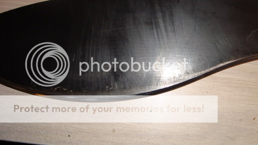

The heavy grinder marks are from the factory. The factory grind was so bad that it looked like a saw not a knife and was so off center it was just shy of a chisel grind. that was my first and most likely last experience with a CS product there are so much better offerings out there for the same price I don't see the reason to give them a second chance, but that is just my opinion.

I use a 6" mill bastard file. Mine's rectangular, I'd get one with a taper next time to the hardware store to hit the recurve nicely.

I used a bastard file for all of my Cold Steel machetes. You could use a 1" belt sander if you want to get it done quicker, but you'll have to take frequent breaks so as to not ruin the temper.
+1 on the bastard file. the steel's pretty soft so it's easy to work. certainly easier than a ka-bar or old hickory. ;)
On this kukri of mine I started out with a 12" millbastard file, but it doesn't get the recurve portion of the blade very well. So I took an empty pringles can ( any thick cylinder will do) and wrapped sandpaper around it.
Sharpend the blade basically like you would with the sandpaper/mousepad technique, then finished by wrapping leather around the tube, and stropping it that way.
Now it shaves hairs like a dream! :thumbup:
