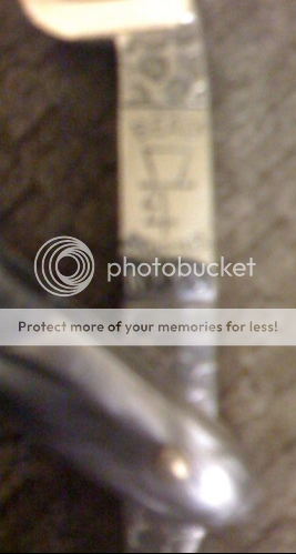

I have a Beau Brummel straight razor that I bought at an antique store because I find it cool...and now I want to shave with it! It has a very thin edge, but it's not sharp, certainly not shaving sharp! How do I get it to where it needs to be? I do most of my sharpening on a paper wheels system, but before I apply my straight to it, I wanted to hear some feedback! Help! Thanks in advance!

Personally I use a belgium coticule. Can you post a picture of the straight?
Took me awhile, and these pics were taken with my camera phone so I apologize in advance for the crappy quality! Here goes!
It does have a tang stamp that says soligen, and carbon, but it's very faint and impossible to capture with my camera. Thanks again for your time and input!
