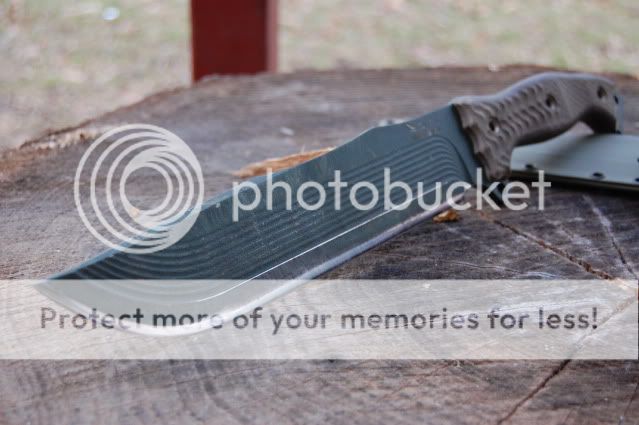

Infi is a steel with unusual properties, it can take a lot of lateral stress without breaking ... many other steels cannot ... a lot of other knife makers who use other steels will find that their knives if tested on lateral strength fail long before a blade from Infi will ... sour grapes being a common theme in any walk of life has lead to a Busse/Infi blade being referred to as a sharpened pry bar ... for those who are fortunate enough to own and use their Busse knives they know that they can re-profile the edge to whatever type of use suits their personal circumstances ... people have shaved with a Busse as large as a Khukri and as small as a knecker blade ... Infi will take a razor edge and can also be thinned behind the edge for specific uses which benefit from that type of geometry. If you want to chop through breeze blocks the larger blades come from the factory with around 25 degree edges per side which enable this without deformation and chipping of the edge. They come this way from the factory because you cannot add steel to a knife and the starting point needs to be a thick grind. However, for working with wood many of us thin the grind behind the edge and go for around a 20 degree primary bevel and 15 degree back bevel per side. Some may adopt a similar profile by convexing the edge into an appleseed shape rather than have two seperate angles. For fine cutting you can take Infi down to 15 degrees per side without undue rolling on the edge. Less than 15 degrees and you need careful technique to ensure the edge retention is not affected by rolling.
Your machetes will be thinner and have less edge retention than a Busse but like Infi although for a different reason (due to low Rc hardness) will withstand a lot of torque on the blade. They won't be as tough though as a comparative Infi knife of similar length. This will partly come from thicker construction of the Busse blade and partly from the properties of Infi as a steel. However, if you have the strength to use a long Busse blade such as a 12 inch NMFBM you will find many of your machetes/parang's become second choice ... I have used a .25 thick NMFBM instead of my Army issue Golok for the last 4-5 years or so ( whenever it was when the NMFBM's were first released ) and the difference is considerable on both chopping performance and lasting edge retention in the field.
Here is my NMFBM ...

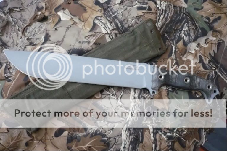

Now I get it. I used to be unable to justify the expense the same way until I finally decided to try one out first hand. Now to think of only getting 3 or 4 days between sharpening... ugh :barf: I remember those days, and I will never go back to wasting time sharpening my knives that often. After being used exactly the way you have described, including dirt contact/digging/root chopping, an average of three days a week for the past year while being my machete kept on my tractor to clean up the place. This is what the factory edge looks like on my Basic 11 I have owned for over a year, with the factory edge untouched, AND NOT SHARPENED EVER! That also includes chopping and splitting wood to feed the wood stove over the winter and cutting open some tin cans. You are paying more money for a higher quality blade that will spend way more time being used than being sharpened.
And it still cuts and chops as well as the first time I used it. :thumbup:
Once you try out INFI first hand, you will understand too. ;)
