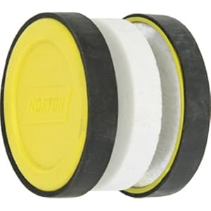

When I was a kid we had one of these in the drawer.
It actually works OK as long as you use some oil with it - once it glazes up you're finished. Am a little surprised to see one made by Norton. If you need a working edge with a minimum potential to trash the knife, this might be a good choice.
That is the same thing my mother used! That, and the powered stone on the back of the electric can opener...
