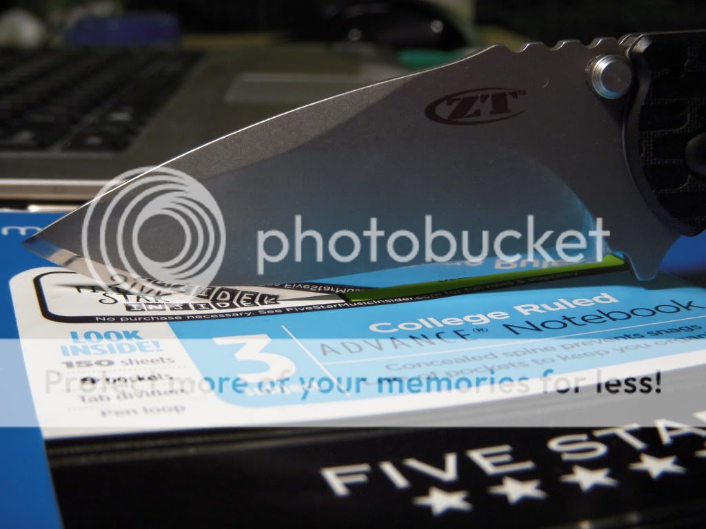

Hey, I got my Edgepro and I'd like to thank everyone who helped me in making my decision! It is a little finicky, but I'm really liking the control it gives the user. Here's my best one so far. It's not perfect, and there are some scratches on the polish, but it slices like I never thought my 0551 would. Took forever to sharpen (High wear steel + thick blade = hours of reprofiling), but well worth it!
Hey, that came out looking quite good! Congratulations, looks like you're getting the hang of it fast. :)
