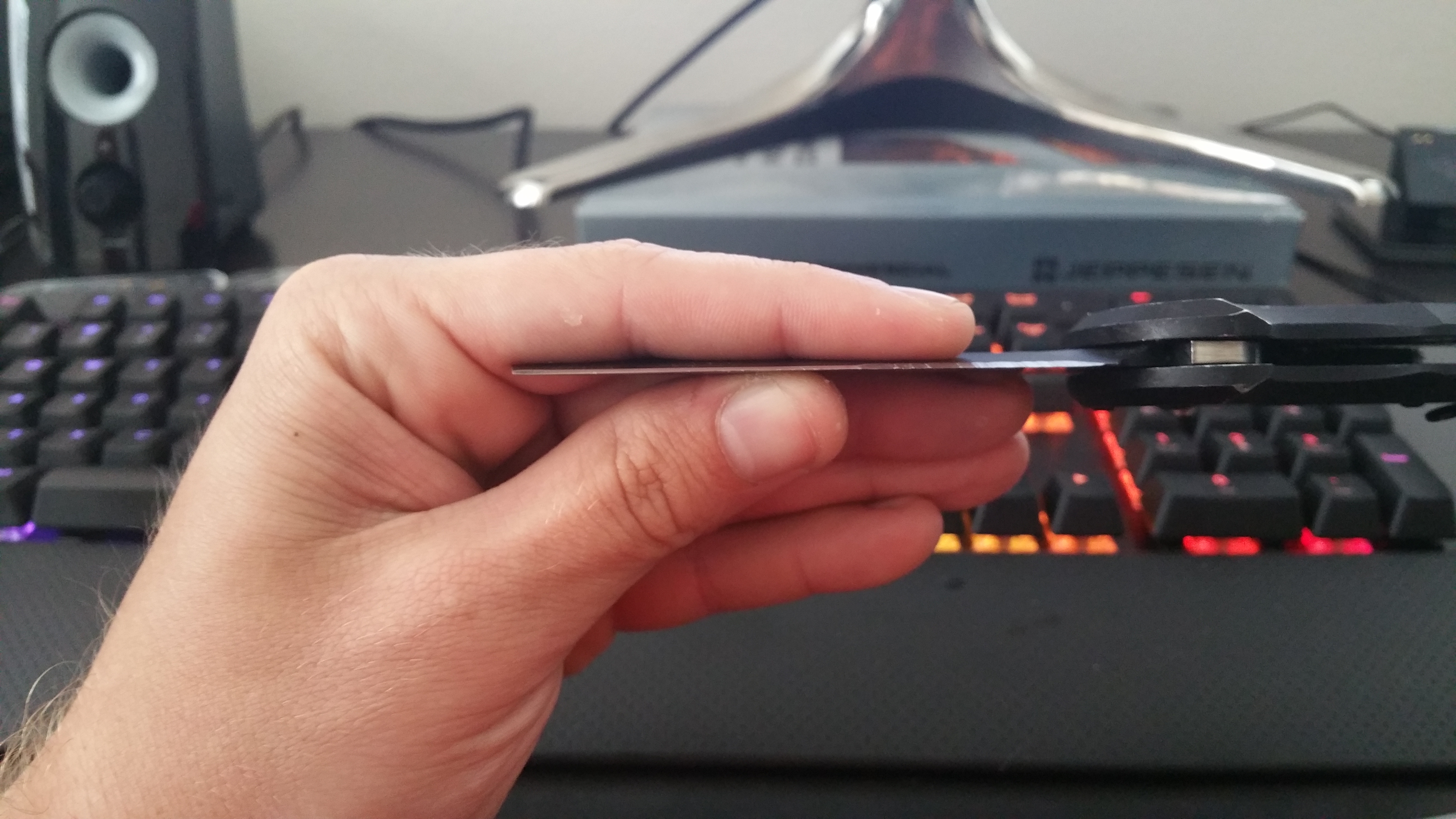

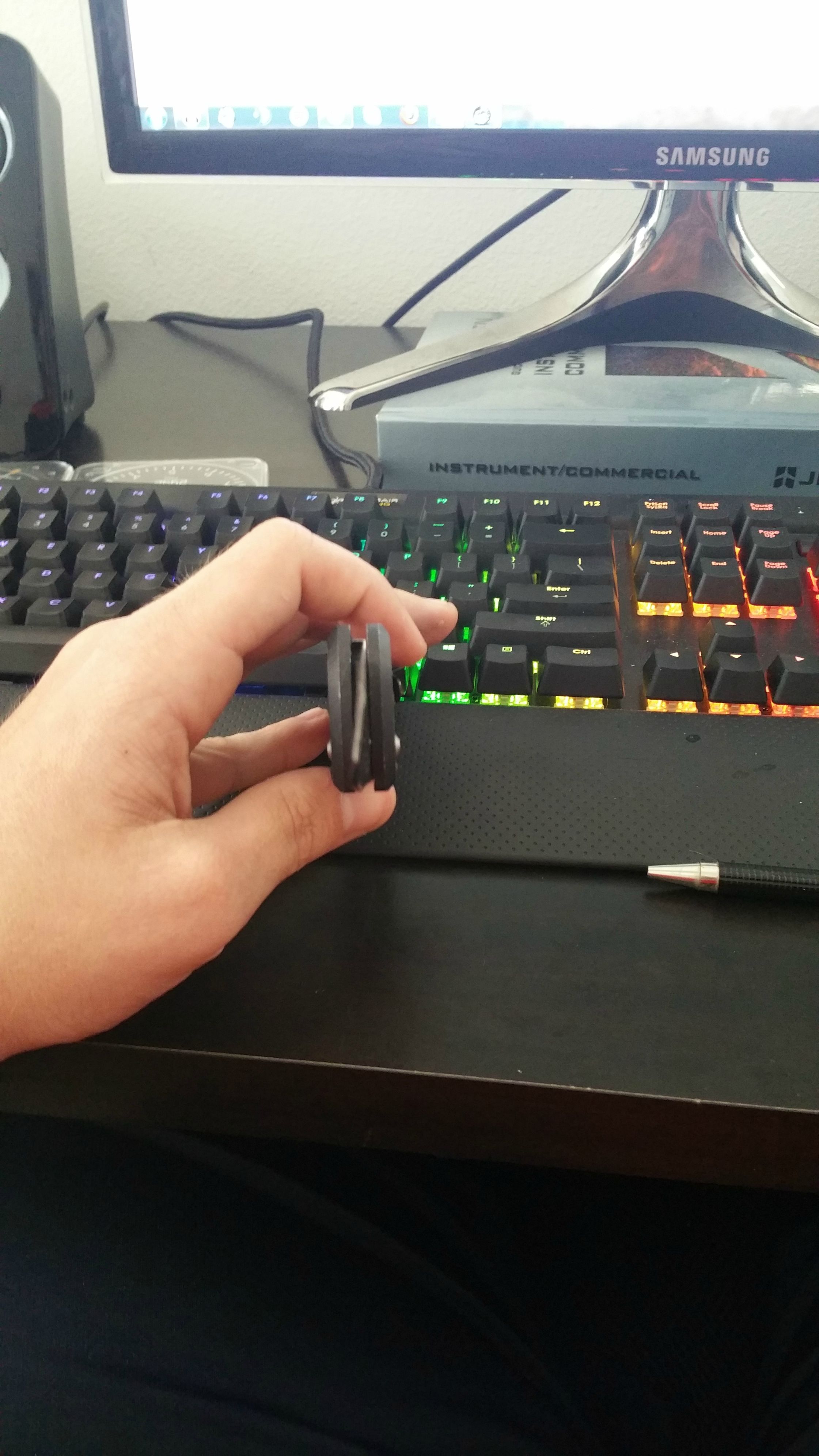

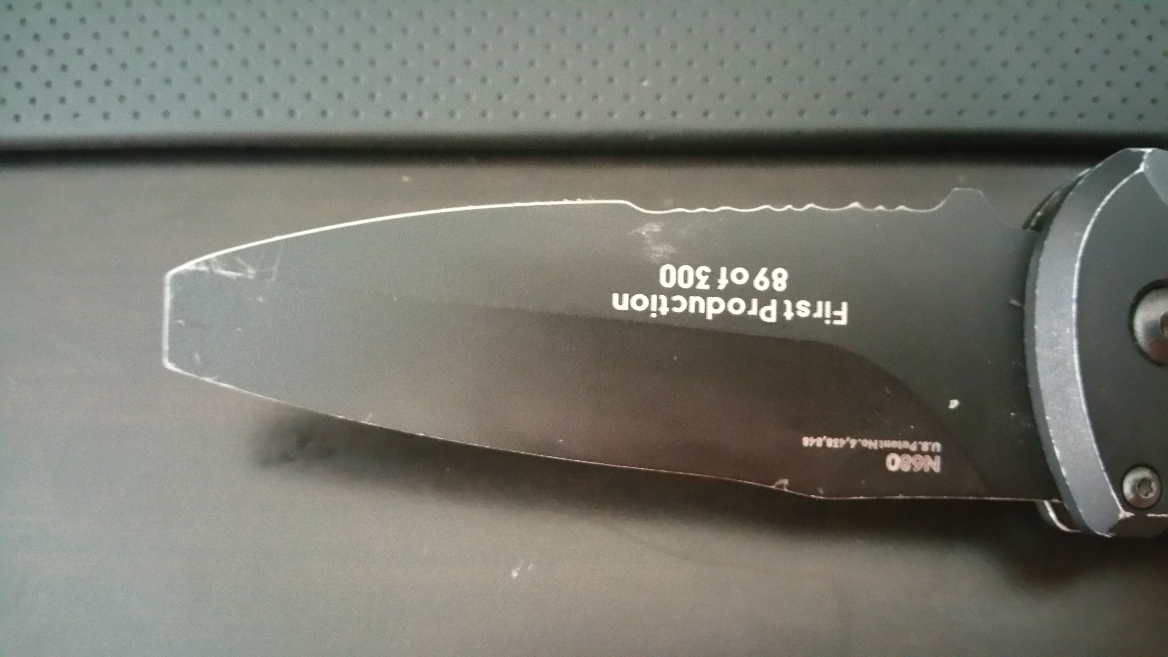

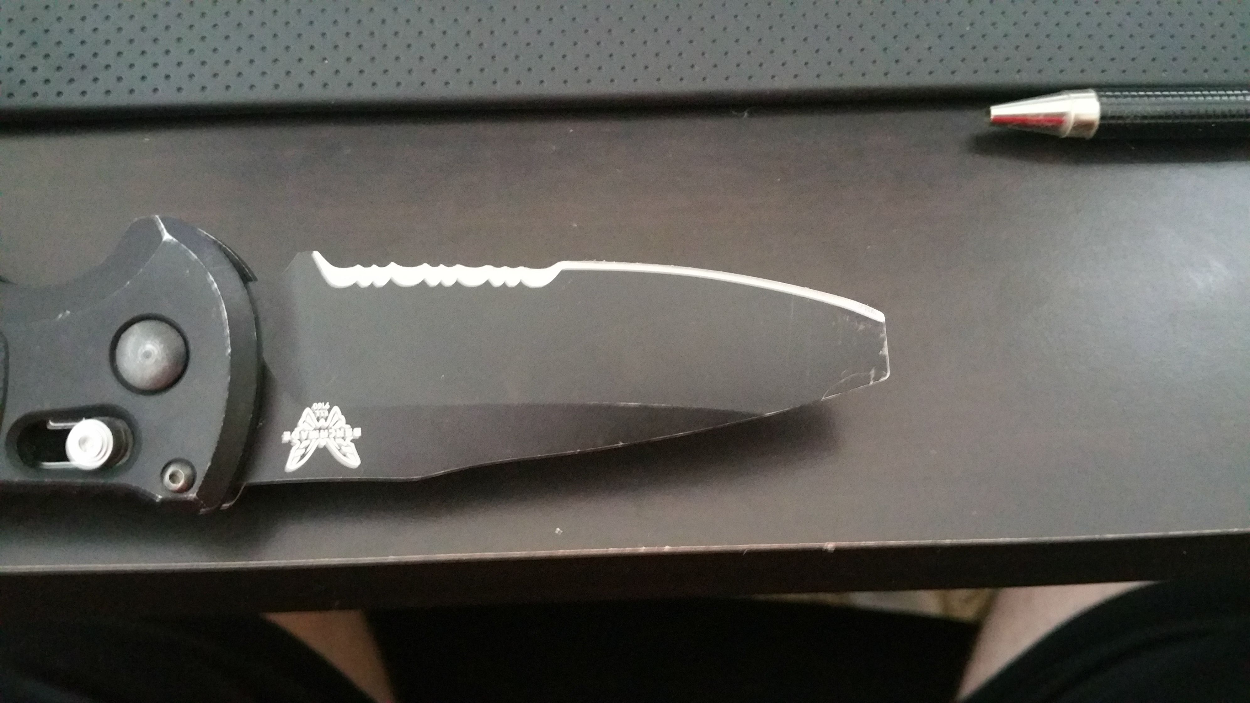

Yea there may be a bevel (extremely low) on the right side, but it honestly FEELS in my hand / finger, 90 degrees. Its 100% not even on both sides... here is a photo so we're all on the same page. I tried taking a photo of the edge from the front, but I can't get the camera to focus correctly, its the best I could come up with!
Sorry its not as nice as other peoples, its been through a lot! Lots of door panels / air bag panels looking for dope!
I use this every day and just looking to put a simple 30 degree on it so I can maintain it without having to send it for BM every few weeks and being without for a week or two! I use this knife every day and cut everything from seat belts, plastic to evidence bags... just looking to get a decent edge and I can maintain!
Yep. They sharpened it Emerson style. It works on that blade. They cut weird, but super easy to sharpen. You can keep it or go symmetrical, but id recommend giving that a shot for awhile. You may like it.
Let us know.

There is a drastic change in the blade grind on the non-beveled side which is the reason for the chisel grind. I would NOT recommend changing its grind.
Sharpen the bevel side at 20 and the backside 10, on the backside use medium and fine grits, no coarse grits.
Really appreciate it Jason... I've only had a good 10ish blades under the Wicked Edge, but I will 100% follow you advice! I'll keep it like you said as the blade itself is "torxed" to an extent so you can put some good leverage on it without bending the blade!
I'll give the 20/10 a whirl here in a few days when I get off assignment and let you know how it goes!
