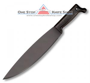

This one? I wish I'd bought more of them when CS clearanced them out years ago. It's been my favorite also. I just gave it to my daughter a while ago. The first phot is the one I was referring to. The second photo is I think, one they replaced it with later.

That’s the one. I don’t think they offer that size anymore. I’d turn this one into something else and get a new one if they did.
