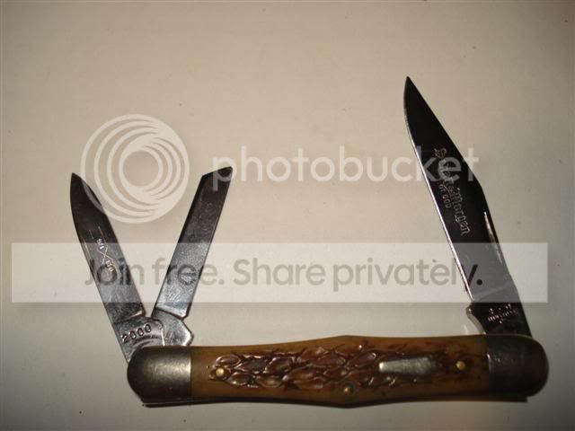

Well I don't know if it's 420 or what, maybe you folks can help me out. On the small pen blade it says 043 and 176 and says it's made in 2000. Here is a pic for identification:
I don't think it was flip flopping a burr but rather the edge was not the right angle as my sharpener is set at. Mine sharpener unlike a sharpmaker does not have adjustable angles. It was just hitting the outside of the edge rather than the edge itself.
In 2000 Queen made a swell center in their Annual Reproduction Series. It has an ATS-34 main blade and 420HC secondary blades. If the etch on your main says 1 of 600 that is what you have.
