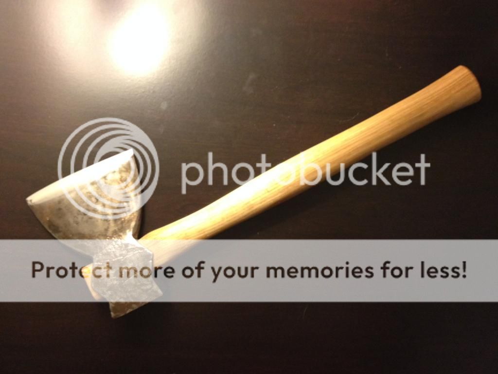

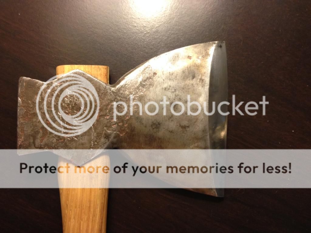

B brettdean Joined Jan 5, 2013 Messages 72 Aug 7, 2014 #8 Ok, i'm finished with this one. True Temper Flint Edge
S Square_peg Gold Member Joined Feb 1, 2012 Messages 13,879 Aug 10, 2014 #10 Looks great. And those are SUPER handy.
