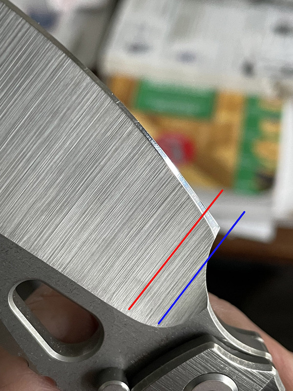

Most folks that have been on the forum for a while know of my pet peeve about sharpening choils, if I can get a knife without one I will pick it over one with. The majority of them are made with a crisp 90 degree edge that catches on things and can hang up the knife while cutting at the most inopportune moment and can cause injury in some cases. One knife maker on here that doesn't include sharpening choils retold a story of a cowboy that was trying to cut a rope off of a horse but the choil area hung up on the rope and pulled him off the fence. Myself, while working overseas unwrapping the heavy plastic wrap we put around our machines for shipping, the knife would sometimes hang up if I plunged the blade in too far and the plastic gets caught on the choil. Some people will say, 'don't do that' lol but when you're working to get stuff done, trying to keep the last 1/4" of the blade from going into the material isn't a high priority at the time.
So, one thing that I will do is to soften that choil area down to more of a ramp, so when material does fall into that spot it will ride up and onto the sharp edge. Chris Reeve folders, for the ones I've seen over the years have had an angle in the choil area making it so it doesn't hang up. More makers should take note. It requires a little more time I guess than just drilling a hole or filing the notch, but I think the consumer would appreciate it. Or, as Spyderco knives go, they typically do not have a sharpening choil and that's a great thing to me.
I recently picked up two of the Tactical Pteradactyl knives, a mini Bowie and a medium Raptor, below are the before and after photos of the Raptor. I radiused the sharp edge of the choil into more of a soft curve, now material will move up onto the blade easier than before, without losing very much of the original edge.

Edited to add what those new knives look like, these were taken before I radiused the sharpening choil

Good idea to sharpen it like a seration especially if it is too big. The same technique works on chips too. Make it into a serration so it doesn’t catch then sharpen over it. Given time it will disappear.

I cut a small choil
view
Then sharpen it on my diamond plates. Hopefully the choils go away and I’m left with a nice 90*
view
On a MasterSmith type fixed blade you will often see than they rounded the area at the choil section, so material will ride up and onto the blade like on this White River version of a Fisk Sendero fixed blade

One way to see how this affects an edge is to try to start cutting on a piece of foam, the abrupt sharp point of the start of the edge would hang up and you can't get it pulled across, where one of the above blades will help by gliding the material up and onto the edge.

I guess if you have examples that would help understand your bias, but everyone of course is allowed to like what they like and choose what they want. My point stands for me as it is aggravating when a blade is hung up during use. Several cutting demonstrations show that when they are trying to cut and the knife gets caught and when it frees up it can go faster than expected and there is a risk of harm to the user or the blade

The point of this thread is to highlight how some choils are made in such a way that it impedes the cutting ability of the knife, and by angling the choil so it is more of a ramp than just an abrupt cut off, it will help overall.

I prefer to have a small choil, and i’ve been known to add them to knives that I sharpen often. I like to keep the edges of my stones square and I hate that unsharpened bit right at the ricasso. Well, it annoys me at least. And for the record, if I may be a bit immodest, I’m pretty sure I know how to sharpen properly. That said, they can definitely catch on things and rounding off the edge as you show definitely helps.
