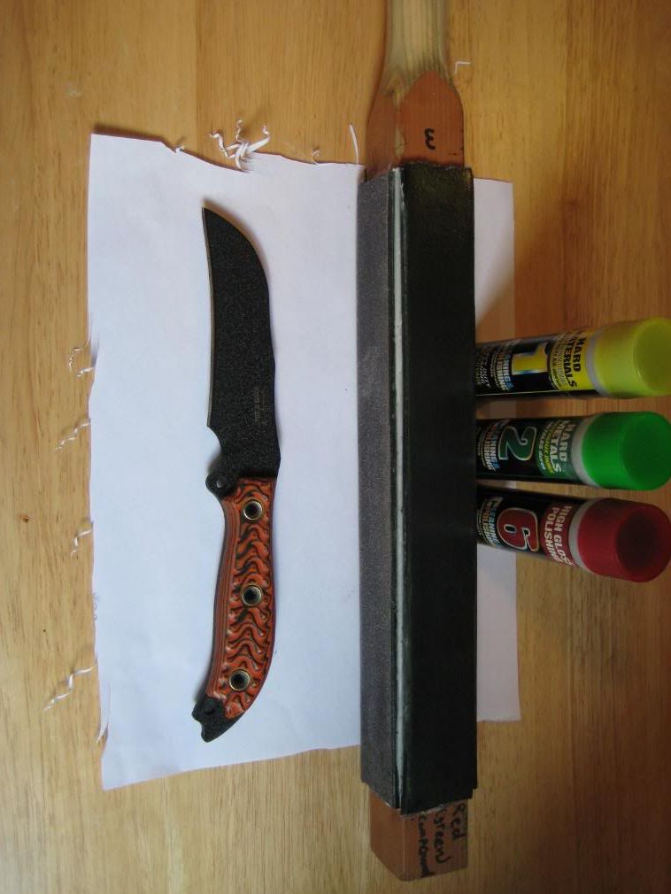

I use a leather strop for mine. Super easy if you have the edge nice and convexed.
Super simple to do. I have never used a stone or slack belt sander. just sandpaper/mouse pad, and leather strop.

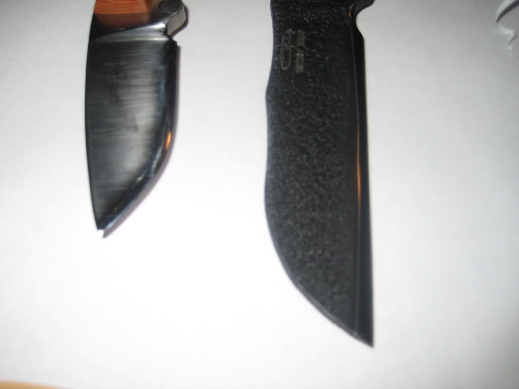

after straightening and convexing
