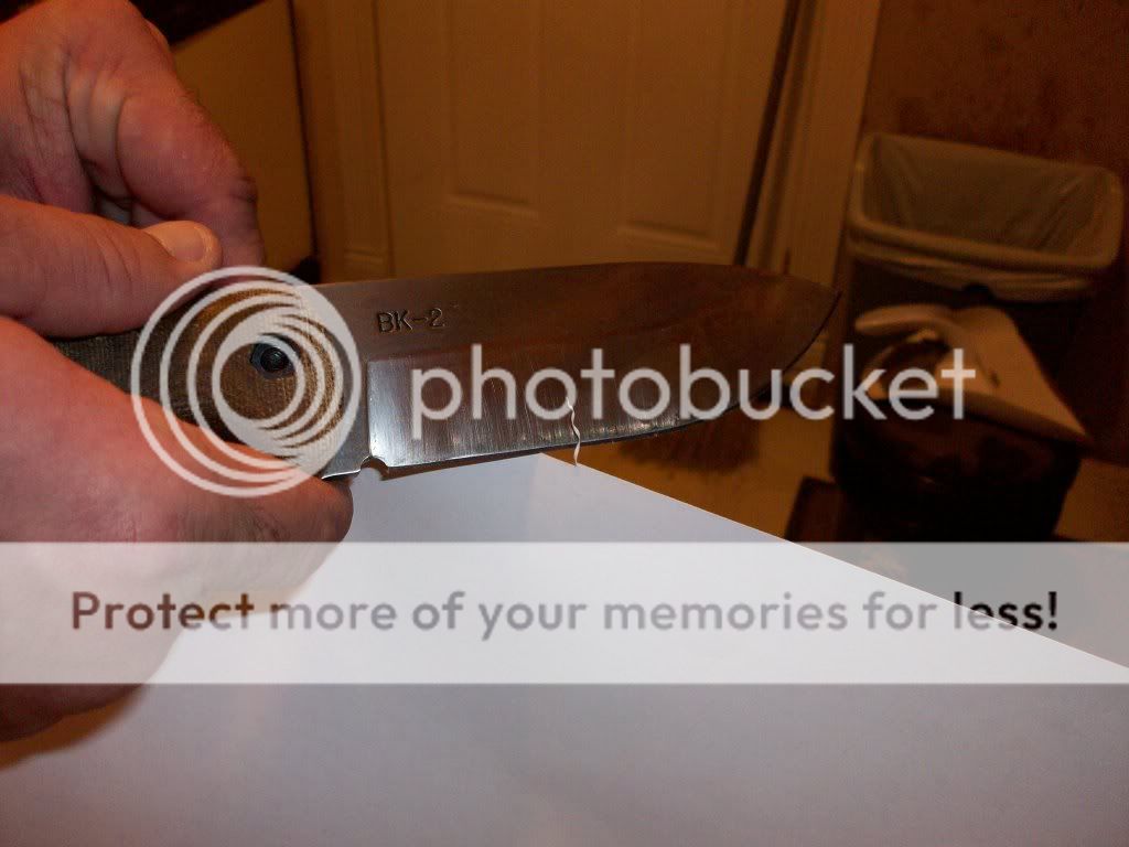

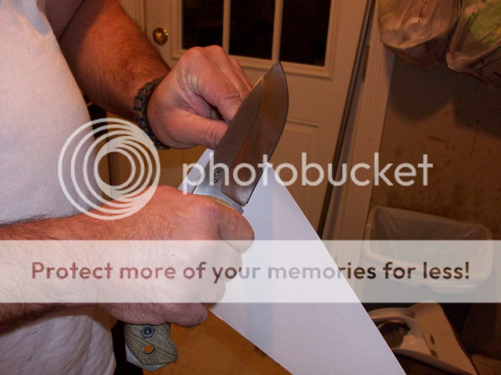

Ok, you need a Lansky (got that) and a sharpie.
Start with the coarse stone (extra coarse if you have it).
Clamp the knife on the spine, right where the little indentions are on the clamp. Make sure when you hold the knife up, the edge is centered in the clamp, then crank it down as tight as you can get it.
Take the sharpie and mark along the edge, completely blacking it out.
Take the stone and the rod, lay the rod on a flat surface, I use the kit box top. Place the stone on the rod and tighten the thumbscrew in the front. Make sure the stone and the rod are in line with one another. If the rod has some bend in it, flex it slightly until it straightens out and is perfectly in line with the stone.
Place the rod through the 19 degree (I use 25, its a good working angle)
Gently begin moving the stone back and forth moving from the ricasso to the tip. See where the sharpie is gone. If you are hitting high, you will still have sharpie on the edge. If you are hitting low, you will have sharpie on the shoulder. Adjust the angle until you are striking from the edge to the shoulder completely.
Repeat this process until you get a burr on the under side, should take about 5-6 passes. Flip the clamp over, and repeat the process until you get a burr on the under side. Once you have it, change from coarse to medium, and repeat the process, sharpie, stone, burr. Then change to the fine stone.
Repeat, sharpie, stone, burr. Once you are using the fine (extra fine) stone, continue to make passes until the burr gets smaller and smaller until you can barely feel it. Then strop it.
Stropping it is not an overly difficult process. Leather, canvas, denim will be fine. If you don't have jewelers rouge, chromium oxide, or crystylon power, use powder detergent. Rub your charge (rough, CO, or CP)into your strop until there is no sign of the charge sitting on the strop.
Start by pulling off the blade, meaning drag the spine first, and the edge must be touching the strop, at the appropriate angle. You will feel when the edge begins to grab, and thats where you want to be. Back and forth, about 10 times on each side, and you should look at the edge and see mirror. Test on hair, paper, pets, spouses, and the neighbors pets.
Let me know how it works out for you.
Moose
This is C&P that I did in a post once more. I apologize. I'm lazy.
