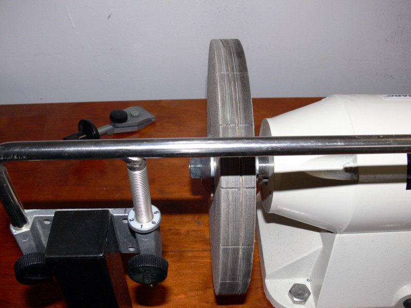

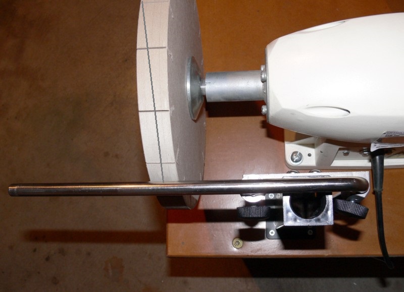

A 10" slotted paper wheel width is 1" i.e. 25.4 mm, which divided by the 16 spaces between the 17 slots the 10" paper wheel has, gives 1.6mm.
1.6mm is the step from the slot to slot at which I cut a diagonal groove using a triangle file, as shown on the picture.
The resultant 3D pattern of the slots and the diagonal groove on a rotating wheel, transposed from the wheel circumference to a static flat 2D, gives something remotely similar to your washboard, especially at high RPM.
Apologies for smartass terminology, I only try to clearly explain what I've done.

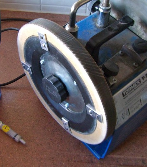

I decided to give it a try having read about your device http://www.washboardsharpening.com and a patterned MDF wheel for Tormek by KWAKSTER https://www.tormek.com/forum/index.php?topic=3509
I've found out that this grooved paper wheel deburrs better when I struggle to deburr an edge on a regular one, and often gives a better keenness.
Tormek MDF wheel by Kwakster:
