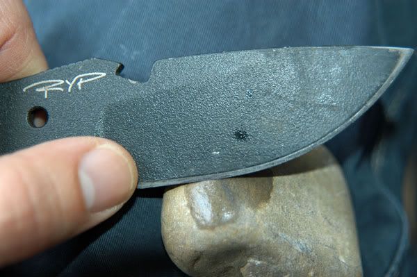

If nothing else is at hand, I even sharpen like that:
Yep, it's a pebble. And it got shaving sharp.
Rock on (literally)!
I am surprised more people are not doing this. There are many ways to touch up an edge in the wild with what you have. A fairly smooth river stone like you appear to have there is a great choice.
