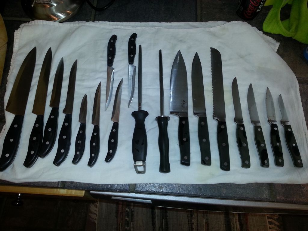

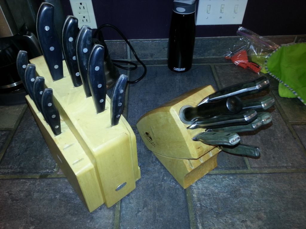

I'll post some pictures of my results as I progress. Here are some shots of the victims:
The knives and blocks:
After washing:

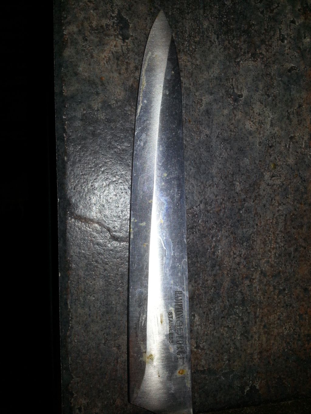

Condition example #1:
Condition example #2:

Since all of these knives are pretty beat up, I decided to cheat a bit. Before I wasted any time on my stones, I wanted to make sure they would actually take an edge so I used the Work Sharp - Ken Onion edition to verify I'd be able to sharpen them at all.
I apologize for the picture quality as all I have is my phone camera. The first picture is the "before" shot but it needs a bit of an explanation. The angle the shot is taken from is closer to edge-on than perpendicular. There wasn't much visible bevel on the blade and what little existed was abused. It's hard to tell from the picture but the edge was more or less flat and blunted. It looked like someone had chopped veggies on a marble counter top or something. The edge would not cut paper and I could run it across my finger with virtually no bite.
The second shot is after I ran it on the WS set to 17 degrees using 4 belts:
  • The stock, WS P120 Extra Coarse
  • Micro-mesh 240
  • Micro-mesh 320
  • Micro-mesh 600
The scratches you may be able to see running along the length of the body of the blade are from a rust eraser I used to take off most of the rust spots and stains. If you look at the bottom of the bevel you'll see a reflection of part of my hand. Yeah, the WS is pretty impressive and FAR surpasses my skills using stones or strops. Still, this gives me a target to aim for.

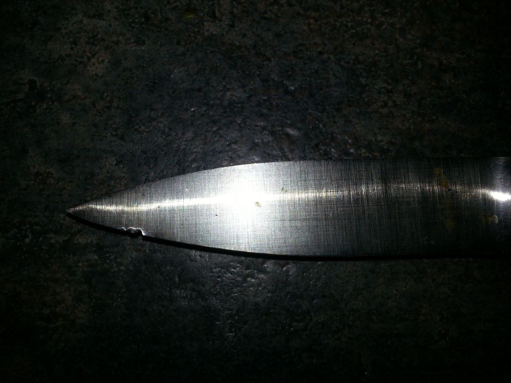

  • The area I am having trouble with is the end of the blade as it begins to curve up to the tip. As I was checking the edge, I'd see a little bit of light reflected back along that part of the edge only.
  • I spent extra time working just that area, focusing on keeping the angle the same as I moved along toward the tip.
  • Oddly, the edge from maybe 1/4" down the blade out to the tip, came out well. It was that area from 1/4" back to the beginning of that curve, maybe a total of 3/4" that I couldn't get quite right.
  • It came out sharp but definitely not as sharp as the rest of the blade and I could hear, see, and feel the difference cutting through paper.
  • The loupe showed that the edge was thinner in that area of the blade but it is not strong enough for me to really determine if the angle is much different.
Any advice on how to deal with that rounded approach to the blade tip?

It can take a few to work this area down coming from the factory - is frequently ground at a more obtuse angle - not sure if that's what you meant when you said the edge was thinner. Is frequently a spot where the feedback tends to diminish somewhat as well, leading to a bit less bevel consistency. Just take more time on the 500 before moving up, make sure the burr is continuous before advancing. The pics below give an idea of how the bevel contacts the stone through that region, and is a good idea to work it a bit more dynamically - fore and aft at the same time as you manipulate the handle up and down. No need to hit the entire belly in one pass, I scrub right through it in overlapping sections just as the rest of the edge.
Also recommend using two sheets of paper on the WB and a bit more pressure when stropping, especially with no compound and on softer cutlery. The polishing/burnishing effect will be more pronounced.
Thanks, Martin. Those pictures are perfect. I was not lifting the blade as much as I came around from the main body of the edge to the tip. That does make sense as I think about the results - that curve was clearly not as sharp and since I could see a bit of light reflecting off the edge there, the apex must have been incomplete at that point. I was worried that too much lift would wreck the edge. I'll try to clean it up tonight with a steeper angle.
I may have been using my terms incorrectly. By saying "I used a somewhat more obtuse angle", I meant that I inclined the blade towards perpendicular to the stone as opposed to laying the stone flatter against the stone - a steeper or higher angle (like for putting an edge on a hard use knife) vs. a shallower or lower angle (like for putting an edge on a fine work blade like a sushi knife).
