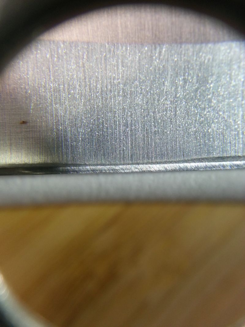

Thanks, Martin. Those pictures are perfect. I was not lifting the blade as much as I came around from the main body of the edge to the tip. That does make sense as I think about the results - that curve was clearly not as sharp and since I could see a bit of light reflecting off the edge there, the apex must have been incomplete at that point. I was worried that too much lift would wreck the edge. I'll try to clean it up tonight with a steeper angle.
I may have been using my terms incorrectly. By saying "I used a somewhat more obtuse angle", I meant that I inclined the blade towards perpendicular to the stone as opposed to laying the stone flatter against the stone - a steeper or higher angle (like for putting an edge on a hard use knife) vs. a shallower or lower angle (like for putting an edge on a fine work blade like a sushi knife).

I caught that part, but your observation that the edge was "thinner" where you were having trouble made me think the bevel region was thinner, making the edge more obtuse in that spot relative to the surrounding area. This is painfully common on factory edges and can take a bit of time to grind down so the angle matches the rest of the edge.
Stay on it, you're knocking on the door! Stop and observe often - IMHO it should be over 50% of your sharpening time. It actually saves time in the long run, and steel to boot.
Oh, gotcha. Most of the blade had a uniform edge bevel except in that trouble spot on the curve to the tip. In that area, the bevel (the distance from the apex of the edge to the bevel shoulder) was smaller; I'd say as much as 30+% smaller.

That smaller bevel is a dead giveaway that the edge is much more obtuse than the surrounding - you'll have to change the angle of attack to match the factory, or grind that shoulder back for awhile.

I spent some time tonight reworking the edge. After working the shoulders for a while on the Washboard with some 320 grit sandpaper, I went back to the 500 Shapton GS. As I mentioned above, I used a slightly higher angle in general and elevated the blade more when I got to the "trouble area" leading to the tip. I spent a lot more time in that area as well. I moved on to the 1000 and then the 4000 just to see how it would go. I was actually surprised at how much metal the 4000 removed. It was nowhere near the 500, of course, but still...those stones don't fool around. I finished with some light passes on the washboard wrapped in 2 sheets of paper and HeavyHanded's compound.
The results are much better. I've got an even edge bevel and a sharp edge from tip to heel. I've attached a photo I took by holding my loupe (it's a 20x, Martin) to my cell phone which is th ebest I can do at the moment. If you look closely you can make out the scratch pattern and you can also see the uneven job I did while working on the shoulder of the edge bevel :o
I ain't pretty but it's progress and, all in all, I'm pleased. I think I may try one of the knives from the other set next just to see if there's much difference in the steel.

You're getting there, lots of practice. You're going to find most factory edges are uneven and obtuse - the first sharpening always takes a bunch of time. Elevating the spine to match the factory grind a bit better will keep saving you a lot of time and gives you more feedback from the get-go. As you get a better feel for it, you'll just start grinding your edges lower by instinct.
Don't be afraid to use a single sheet of paper and a bit more pressure when finishing on the WB, it makes a big difference.
