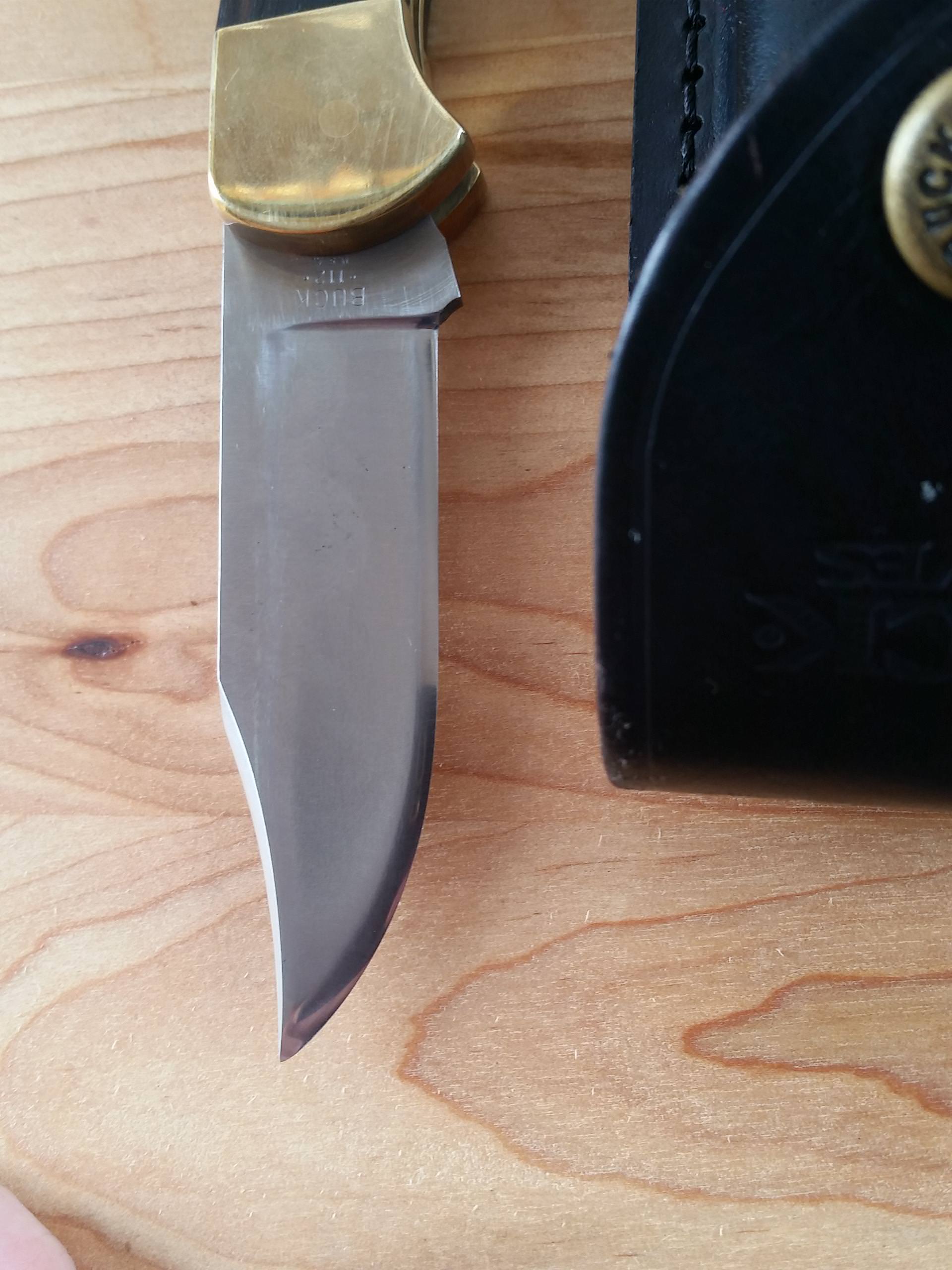

My convexed hollow grind on my 112:
You can see how far it backs that bevel up. There's a reason they changed their geometry for better cutting.
Matt, you took it to a very high grit and the higher shoulder should give you improved cuttting performance. Good. What did you use on it? DM
That's precisely why I did it. The 112 is my favorite woods knife, but my first sharpening on the knife, backing the bevel up just a bit with a stone, left a lot to be desired. My splitting hatchet is more acute.
So I took this one through the same process I did my Bark River. I used the sandpaper I had lying around, which was 220, 400, 600, and 1500, on a leather paddle strop. Then I stropped it as I would normally, black compound, then green compound, then canvas. The edge is really agressive in wood. Still not a knife you'd want to have to slice apples with, but great for what I want.
