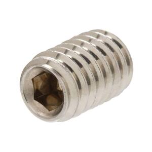

Also, I replaced the thumbscrews for the stone holders as well, with headless hex screws (use an allen wrench to tighten them). The screws are completely recessed into the stone holder, so those don't get in the way either. Don't have pics of those, but I'll look at mine and see if I can add some vendor/spec info for them here (edited to add: see below).
(Edit: "Socket Set Screw", #10-24 x 1/4", stainless) Looks similar to this vendor image below, though the pic is of a 5/16" length; it'll still work:
I found mine at either Home Depot or Lowe's (check the bins/drawers of specialized fasteners), though I can't remember specifically which at the moment.
