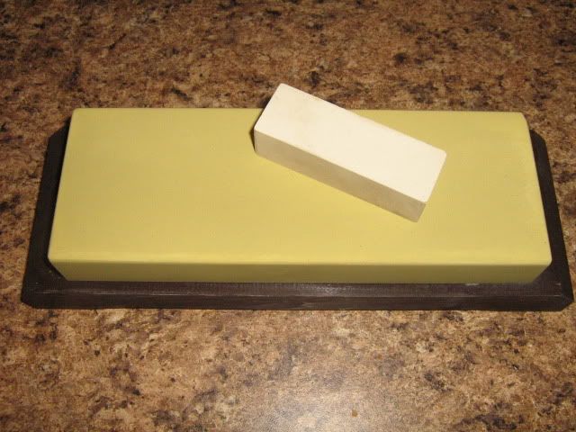

Next is a synthetic stone known as the Kitayama. Its labeled as a 8k but is capable of finishing up to the 10-12k range. Works great on all steels and produces the sharpest of edges with a very bright finish. Comes with original box and nagura stone. $60 shipped SOLD

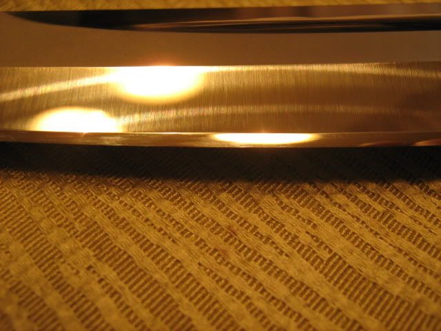

Though they call the kitayama a 8k its at the upper end of 8k from the very start. The kitayama following the norton would be a excellent finish step IMO, you might not even have the need to polish with the 0.5 after. Hair splitting sharp edges are easily possible with this stone.
The finish is very bright and near mirror with a faint scratch pattern.
