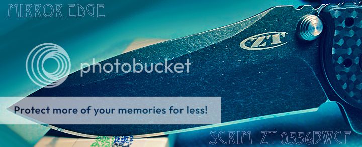

Excuse the typo ON the photo. It's a ZT 0566...but the point is...did it 2 nights ago on my little $65 Lansky system (I did also add the ultra fine, Lansky "Sapphire stone" and a strop for a little bit more $ but well worth it). I'm a happy camper. Doubt I'l be splurging on a Wicked Edge any time soon. So that's my 2¢.

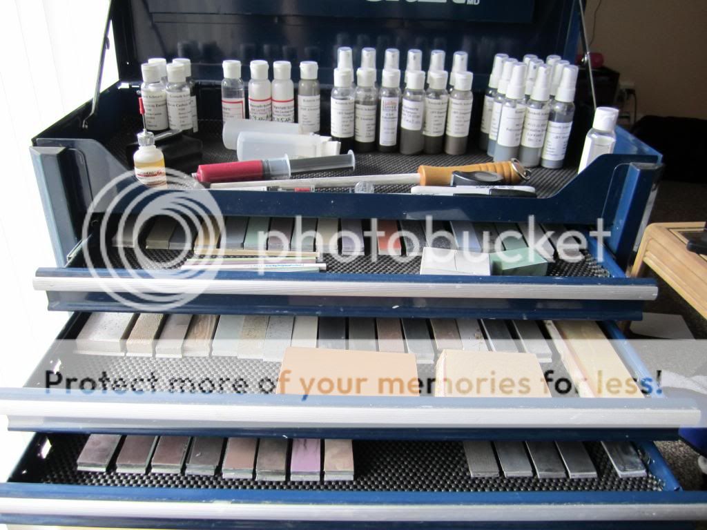

Great collection ... of cigars!! LOL. I would say I am joking, but I am a Drew Estate whore so the cigar jumped out first. After which your collection of stones and diamond sprays etc., etc was noted.
What do you spray your diamond on? I use a felt an anything under 1 micron - love it. The faster you strop, the brighter it becomes lol.
Yeah I like mine...
:eek::eeko OH MY GOD! and i thought i spent lots of $ on my egde pro system and sharpening stuff strops ect.don't even think mark richman has all this! how much do you have invested in this any way.
