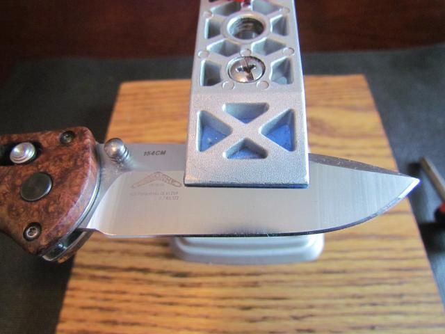

Here are my helpful tips:
I do not remove the wires from the hones. I've removed the included screw and replaced them with set screws I bought at Home Depot. This allows you to use more of the hone. I also use "blue" grip tight on the set screws to hold the wires in place. Once the wires are set parallel to the hone surface I only check them before use and tweak as needed, which isn't often.
I've placed each of my knives in the "jaws" where I want them...as has been said unless you put them in the same spot the angle changes a bit...and take a photo of the knife in the jaw. This way I always place the knife in nearly the exact same place as the previous time I sharpened it.
I use a tackle box with the center "walls" removed to hold the hones with attached wires...so much easier...imo.
I generally use a 50 stroke per side method. Sometimes more seldom less. This works for me. Others have their own systems and if they work to our satisfaction that is all good.
I use the medium and fine diamond hones followed by the "black" Arkansas hone then the yellow and blue sapphire ceramic hones. I always finish with a bit of stropping on my home made leather strop.
I started with the natural set of hones but found they did not work all that well for the harder steels.
I have a Lansky leather hone...imo it is useless for honing but they tried...it just does not work imo.
I use each of the diamond hones until a burr is reached then flip the knife over and repeat. Once I feel the knife edge is ready to move on to the next hone I then move to the next finer hone. Usually once I hit the yellow and blue ceramic hones I'm really just polishing the edge. It is already very sharp.
Here are a few pics that may help.

I have used a Lansky for several years and had good results... until I bought a Becker BK14. The steel was harder than most I had worked with to that point. I could get most knives shaving sharp with the Lansky, although I did find my knives "walked" a bit in the clamp. I noticed the pic above of a Lansky setup with a thicker, skeletonized clamp. Mine was either older or cheaper, as it was fairly thin, solid aluminum.

I have the same clamp and with some blade profiles I have some trouble getting it where it doesn't move on me. This is important cause if your angle keeps changing even a little you're not going to get the edge you want. I have some electrical tape wrapped around mine, it helps but i'm still trying to find something better.
