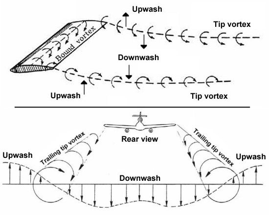

At the same time, I'm struggling to understand where the lift comes from when the mower is used in mulching mode. It seems to me that unlike with bagging, there is no airflow in or out, only swirling.
I am picturing a tip vortex. If it is swirling like this that is still upward flow at the outer edge of the blade deck where the cutting is taking place, right?

The best mower I ever had was a gen 1 Ryobi battery mower. It was only a mulcher, nothing else, and mulched so well you wouldn't want anything else. The underside of the mower deck looked identical to the vortice in the photo above, so I would say there is still a lot of lift with a mulching blade. I inspected my new blade today and noticed the wear is even from the tip in 4" or so until it bends up, no extra wear at the tip. The tips on it sweep inward around 20 degrees so if I bevel them it will reduce the cut diameter quite a bit. They are high lift Ego blades at $35 each. Nothin special but the price.
Mr.Wizard, for the mower blade vortices you need to invert your diagrams since it is reverse of a lifting wing. The mower blade tip vortices would push the grass down at the outside and lift the grass inside the cut diameter, in theory. There is also the endplate effect from the mower deck.
I think the air is up and out into the bag when bagging. Downward near the center when mulching when all other egress is blocked.
