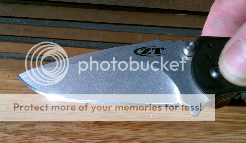

Forum member Rayban stopped over today to get his new ZT sharpened and I decided it would be a good chance for me to make a video. Enjoy!
[video=youtube;bYyUDeqjgx8]http://www.youtube.com/watch?v=bYyUDeqjgx8&context=C3e76732ADOEgsToPDskLJ NlPT1_ja8--nekceXMnx[/video]
[video=youtube;lqhNbJt8tpU]http://www.youtube.com/watch?v=lqhNbJt8tpU&feature=context&context=C3e767 32ADOEgsToPDskLJNlPT1_ja8--nekceXMnx[/video]
Awesome. I Just tried sharpening mine with a DMT Diafold. It really didn't cut the mustard. Thanks for the post.
I reprofiled mine on an Edge Pro at ~18 degrees per side. I then did a 20 degrees per side micro bevel and now it cuts like crazy despite the width of the blade. I did find that the orginal grind was off on one side in the tune of about 25 degrees on one side and <20 on the other.

Good job Knifenut! I see you favor the DMT stones, I use one of their ultra-coarse for reprofiling myself, but I usually sharpen with Japanese Waterstones up to 6000 grit and finish off on a strop. I really like how S35VN sharpens though for how well it holds its edge, I've found it to be relatively easy.
Thanks, Thomas :)
EBHM4, I tried my Nubatama bamboo 180 grit to no avail, the steel was too wear resistant to be sharpened on the waterstones I have. Maybe others like naniwa stones but IMO this steel will be best sharpened on a harder abrasive such as diamond. I like my diamond stones but believe in the right tool for the job and diamonds are not always it. (In this case they were though)
care to share why you use short strokes and long strokes?
To keep the metal removal even throughout the length of the bevel. If I were to grind with a heel to tip stroke every time I would end up with more metal removed in the belly and tip area. It's all about how much surface area is making contact, when transferring to the belly and tip the area of contact becomes very small and the pressure very high. If not mindful of this you can distort the bevel and geometry of the edge.
