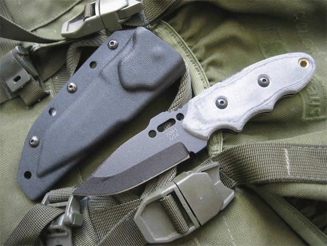

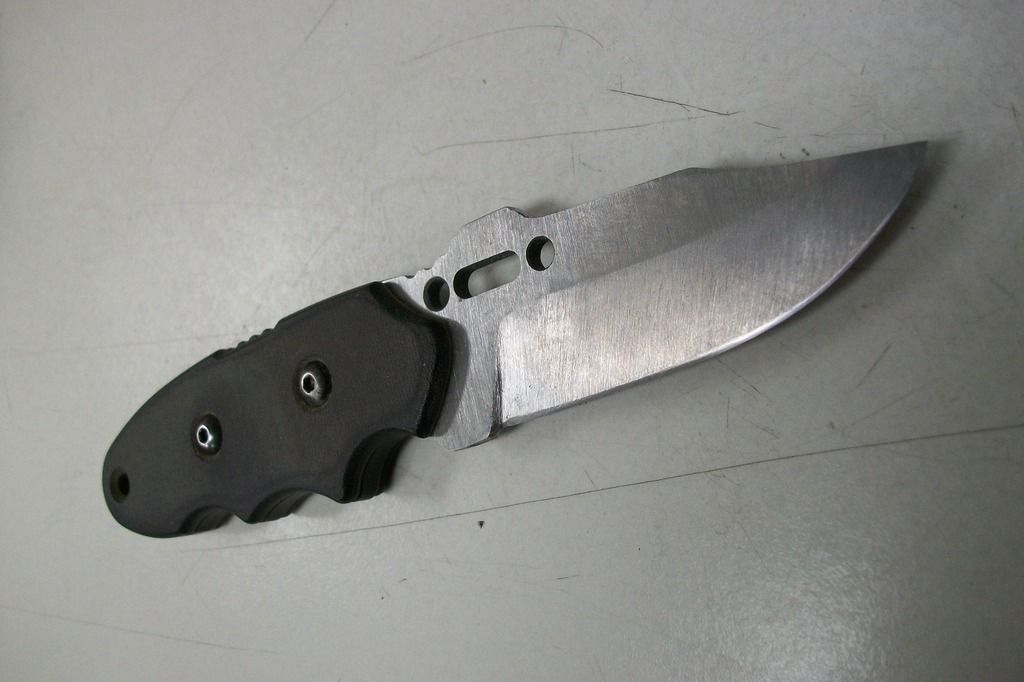

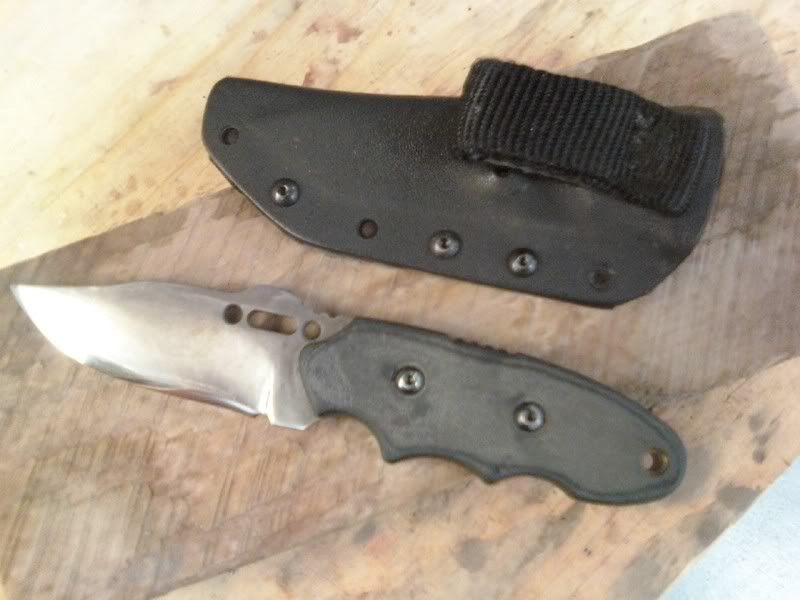

One of my most used EDU is on older Tops knife that came so overbuilt it couldn't cut an apple without exploding it into pieces. The convex helped tremendously, then over time I thinned it out at the spine and redid it to a more traditional grind.
From the factory:
Convexed by hand and clipped:
Currently:
