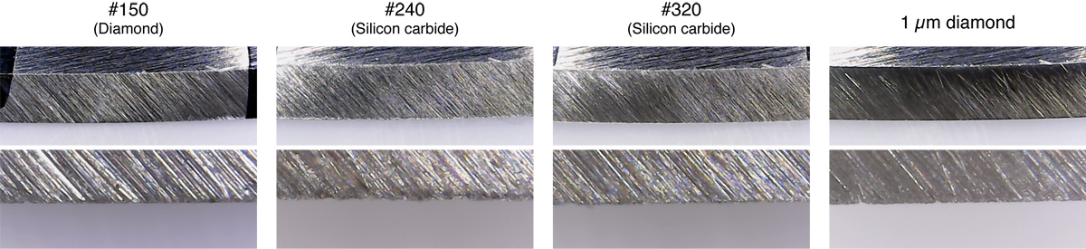

If you can polish #400 edge with 0.1 micron diamond, you may be able to keep some of the coarse micro-serration structures for slicing aggression.
But the edge bevel won't be very polished because you don't want to overdo with the high grit.
I have not tried it extensively yet, but it did work to create a semi-polished-toothy edge.
Also, I have seen a report of a plane edge finished at #1,000 on the front side and #30,000 on the back side creating a consistent few micron thick wood shavings with more smooth bite than fully polished edges.

The diamond makes a coarse edge despite the mirror. So you still get the aggression while maintaining the polish.
The finishing surface needs to be hard. Whether a fine polishing stone or stop, it has to be a firm backing the abrasive is working against. Yes, this leaves a slight bit of irregularity but with a very thin cross section, rather than a variable cross section with the same amount of up and down.
The craziest catchy fine edges I have made were using fine abrasive on a hardwood backing. The edge was paper cut catchy and under 400x magnification you could see wicked projections. I doubt it would have the same longevity as an edge with a bit less projection, but it is the edge that caused more accidental cuts than any other I have made.
