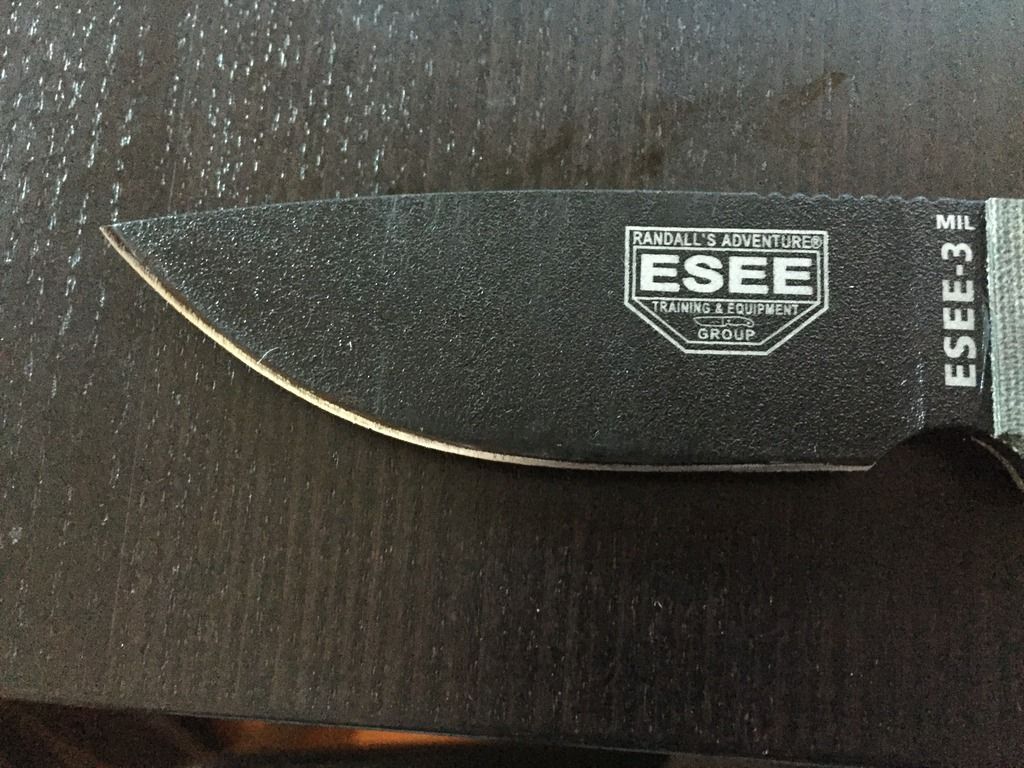

Hello! First post.. I have some problems sharpening my ESEE knives, that I need help with. I currently own the Candiru, Izula II, 3 and 4, and I use the Sharpmaker to sharpen them.

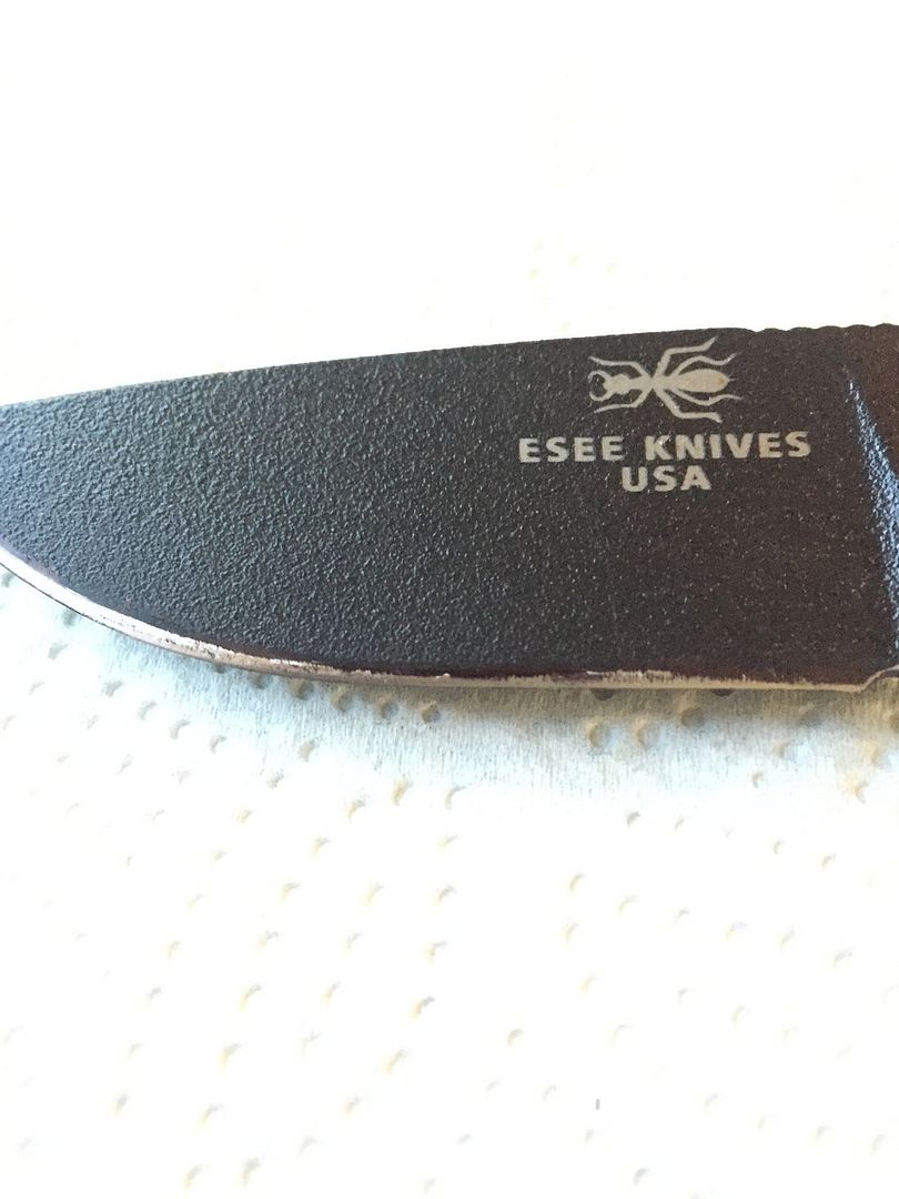

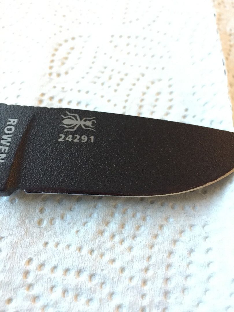

The problem: right before the belly starts I can see light reflecting of the edge, on every of the ESEE's. After reading on this forum I concluded with a wire edge, so I have tried stropping on a belt, dragging the edge along the stone on a steeper angle both ways (push with edge first and drag the knife with edge down) and I tried to drag the edge through wood. No change. I can cut printer paper, and shave armhair with it. If i dra the knives through my hair it cuts the hair on my head, so they are sharp (by my standards at least).
I tried to drag the knife hard through some prosessed hard wood just to see what happened to the edge, and while the light-reflecting parts grew longer, it was still shaving sharp.
What is wrong with my knives? Or more precisely, what is wrong with my sharpening technique?
Just to be clear, I have bought the ESEEs from different places. Since it has happened to every one of them, I don't blame ESEE for this.. Or Spyderco for that matter :)
(Please pardon for any spelling mistakes, english is not my first language)
It's possible that what you're seeing is not a burr or wire edge, but actually the microbevel put on the very edge of the blade by the Sharpmaker. It will be at a slightly higher angle than the main bevel, and will likely have a higher polish than the factory edge. It can be thin enough to masquerade as a wire edge to the naked eye.
I'd recommend slicing some newsprint. If it will slice cleanly along the entire edge without hanging up, you don't have any significant burrs on the edge.

Ditto on the marker trick. It will give you the best idea of where you are making contact with the sharpmaker stones
Tried the sharpie-thing. Got similar results on both the izula and the 3, after 10 strokes on each side on the brown/grey stone
Is it the bevels that are causing different grinding from the stones, or is it just my technique?
There is still Sharpie on the far left edge indicating that you are not hitting the apex.
Again, try slicing newsprint or phonebook paper using the entire edge. If the paper slices cleanly without snagging or tearing, then the edge is fine. If not, you've got more work to do.
Even with the coarser SM's 400grit Diamond or CBN rods, you should be able to get the edge to slice cleanly.
^Agreed, it's not apexed yet.
Don't count strokes to gauge progress. It's too unreliable.
Also, don't rely too heavily on the Sharpie alone. One light brush of the edge against the rods can remove the ink while not removing much metal at all (this is likely the reason why you're seeing that reflected light near the edge), and you'll still not be anywhere close to a full apex. Work until you can see AND FEEL an obvious burr along the full length of the cutting edge, then 'flip' the burr so you can see and feel it from the other side. That's the ONLY way you'll know for sure that you've apexed the whole edge. On thick-edged knives like these, that'll likely take some time. If it's really thick at the edge, consider investing in either the diamond or CBN rods for the Sharpmaker, which will remove steel more efficiently than the ceramics alone, which'll likely take hundreds or thousands of strokes to remove enough steel (this is why counting strokes for rebevelling work is too unreliable, or no real help at all).

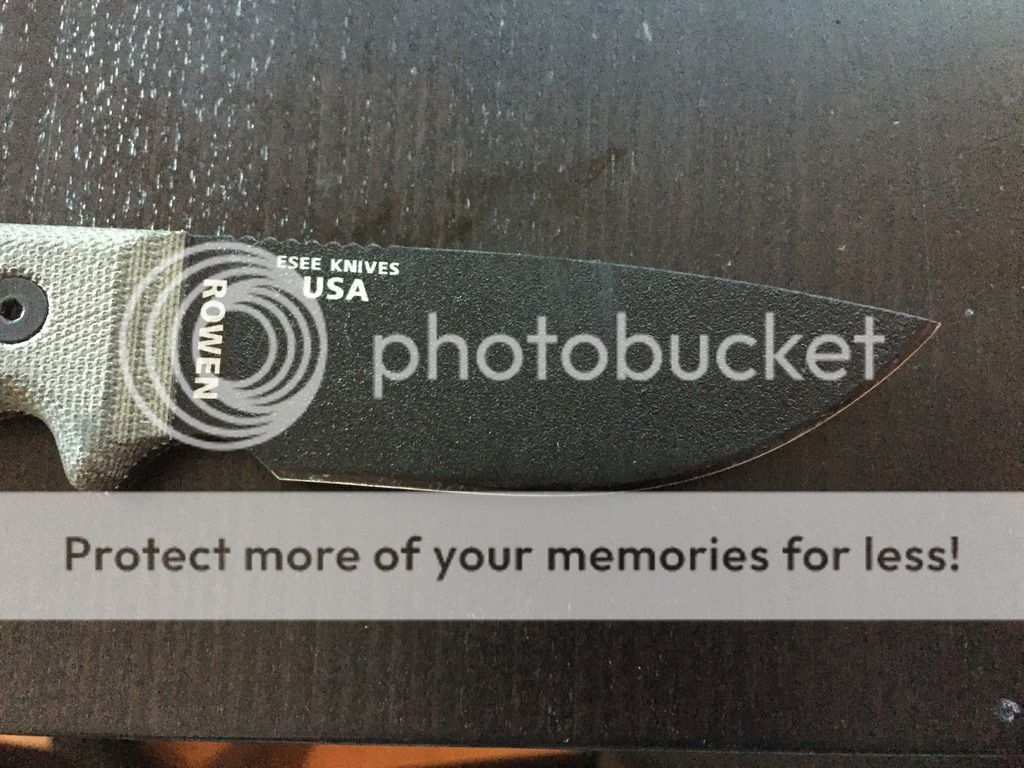

Thanks for your help! I tried using a cheap diamond hone thats supposed to be 320 grit to work the bevel on the izula. Then I used the 30 deg setting for a while, and when I went back to 40 deg I finally hit the apex. After sharpening through the stages i dragged the blade at a big angle lightly over the stone, and then stropped on the belt. After that i managed to cut thin paper (read news online and havent seen a phonebook in at least 10 years, so had to use the manual for an IKEA-closet..). Now it works!
I went outside and made some feathersticks and then looked for reflection after. I also cut the same paper, some cardvoard and shaved my arms. The edge didn't change :)
