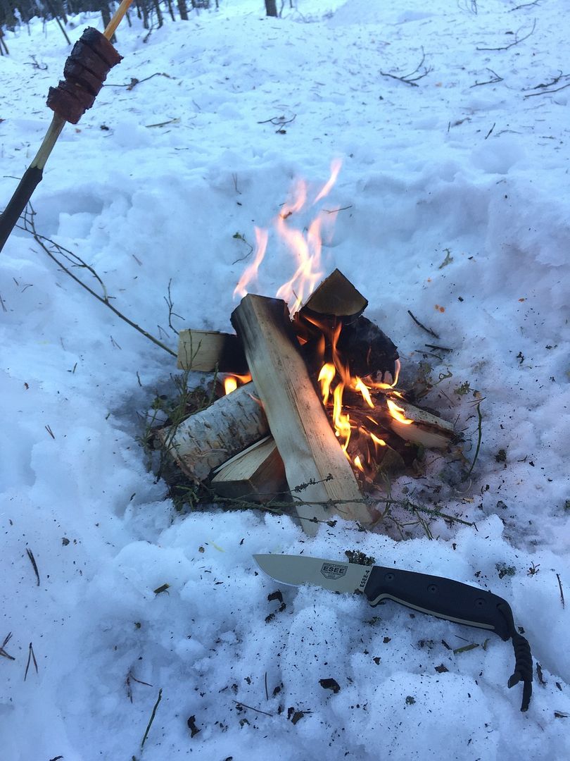

OK, so only a few (5-10 strokes) on, say, the corner on the fine SM-stone, veeery lightly?
Btw, I had to let the 4 get some air today, and since my wife just shakes her head when I say I want to go to the woods, make a fire and cook something outside I have to share it with someone else instead.. :)
The 4 also reflects some light at some places along the edge, but after making some kindle, a skewer for the meat and some whittling while waiting for the food to cook, it still shaves hair. So that just leaves me with a lot of work on the izula, 3 and candiru, I dont think I have to rebevel the 4 :)

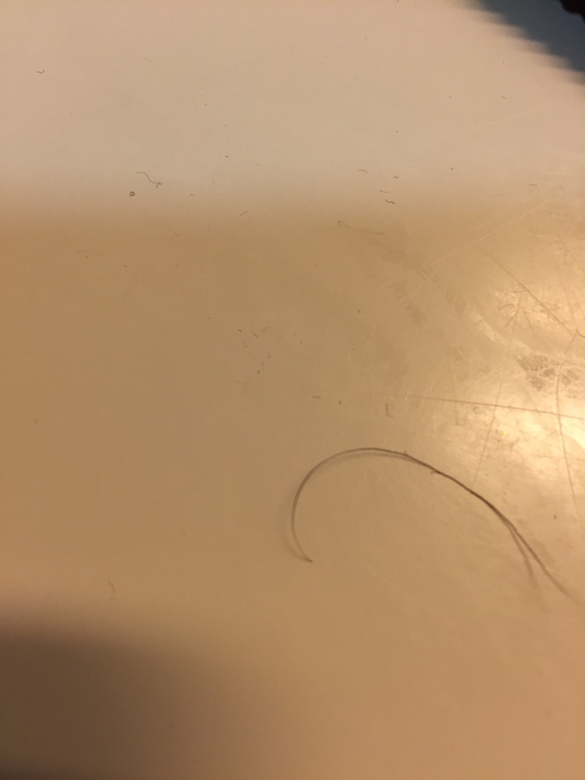

Update: the izula and the candiru needs a LOT of work.. The 3 only needed to take one side down to 30 deg, and then microbevel. The result wasnt as pretty as anything I've seen here, like mirror polish, but I did manage to split a hair with it, so I think I'm happy with that
Edit: pic taken with iphone, this was the best I could fo. You can see some of the shavings on the hair, but some fell off. And it was not freehanging, so still not supersharp, but I figure its sharp enough to make some skewers and feathersticks..
