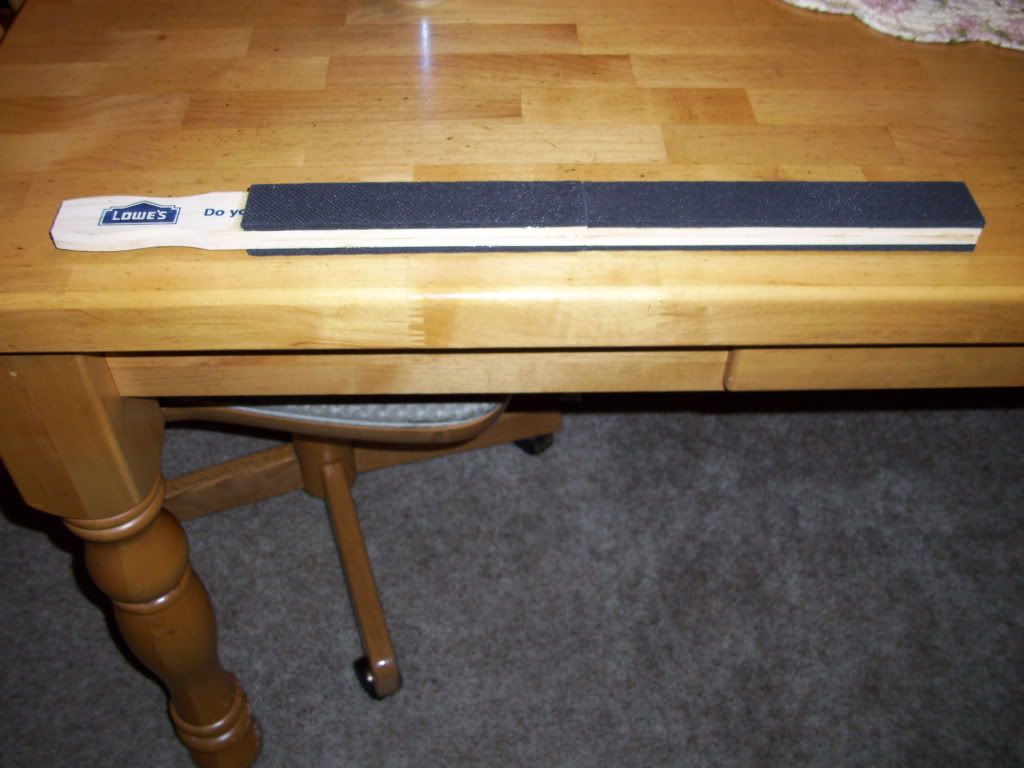

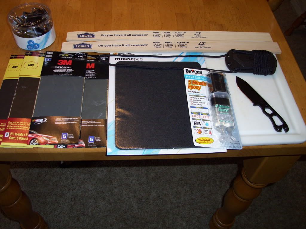

I used 2 HD paint stir sticks, that were free from the big box home improvement store. Glued them together, got a mouse pad, cut it in 4 strips to fit the width of the stir sticks & epoxied them on. I use the wet/dry sandpaper, wet, to convex an edge & polish it . I have up to 2500 grit.
Most of my blades are choppers, thats why i wanted more length to the surface. Works great. It is high enough up so your not dragging your fingers & having the pad on both sides also lets it grip the table top & stay in place better. Hope this helps.
