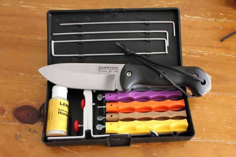

I have a few bench stones , Just used a ceramic 1000gt stone 6"x1 1/2" to touch up my BK10 Worked pretty good. I have a big course/mediam stone that is way to course for what Im doing.
Anyway I need something to hold a angle better (I suck at it especially on the curve)and was wondering about these lansky type sharpeners
Do these things work good -lansky or is one of the others better to get? Make it easier ?
Are these things for little pocket knives? Is a BK10 to big to use with?
I dont know,,, Maybe if I get one of these lansky or other brand wire guide type sharpeners, I might find out I can do better with a bench stone and guessing / trying to hold a angle straight... I dont know, Maybe these lansky type things work good....? ? ?

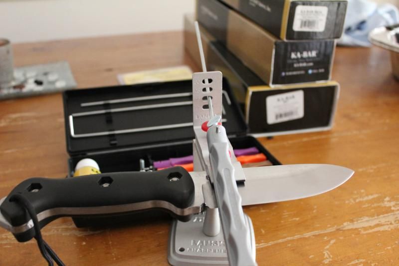

I used a lansky sharpener for a while. I received it as a gift from my uncle. As far as holding and angle I guess it does, but when it is clamped onto a blade with length the angle seems to change based on how far away the stone is to the clamp. I dont really know how to describe it.
I used sand paper as well. That is how I learned to truly sharpen. Slow, steady and deliberate let the grit do the work.
A couple years ago I bought 3 Norton stones. They are the 8x2 inch Crystolon course, medium and fine stones. The best $50 I ever spent. The medium and fine stone get used the most, but they all have their uses. I have never used oil on the stones, but use water and sometimes dish soap.
Actually this is true. If you clamp your knife deeper or shallower each time, the angle will change slightly. Also, if you allow the rod to rest on one side or the other of the hole, the angle changes slightly.

I'd go DMT, the lansky is slow cutting and the clamp can scratch the blade. Also I find the set up slower. The DMT angle guide cuts faster has a plastic clamp that doesn't scratch the blade spine and a magnetic guide rod. It's just faster and more convenient.
