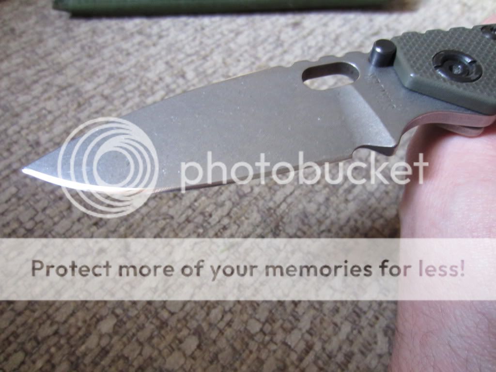

Here is an edge I finished up after last weeks EDC.
Sharpened initially on 320grit sandpaper, 600grit diamond paddle, 1000 grit lansky UF ceramic, then I am fortunate to have the Spyderco UF Benchstone with me as I am away from home for the past 2 months, and then LIGHTLY just knocked the burr off with 2-4 strokes on a small field strop. It is slightly convexed.
Now though I sharpen the edge up to this degree maintenance throughout the week is done on 600grit diamond stone as I feel this gives me the best working edge (sawing motion through material). Or, depending on how I feel the edge has performed just on the Spyderco UF stone (pushing through material like working with wood).

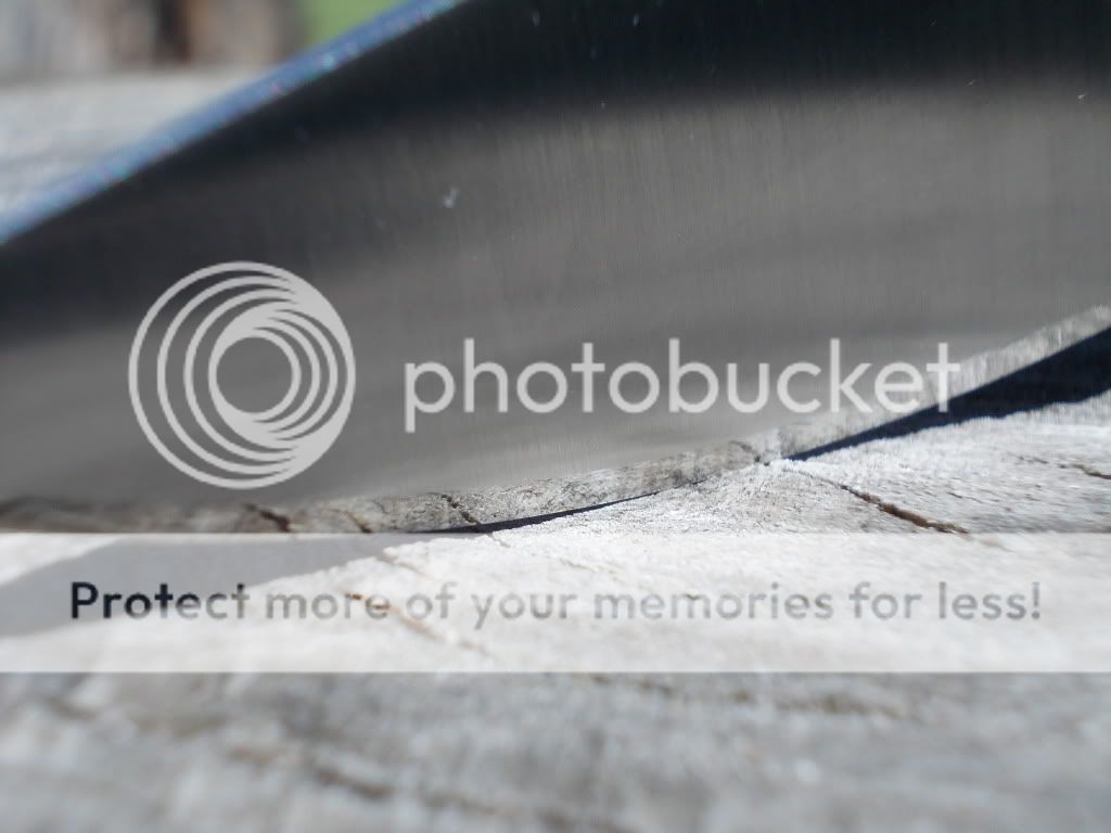

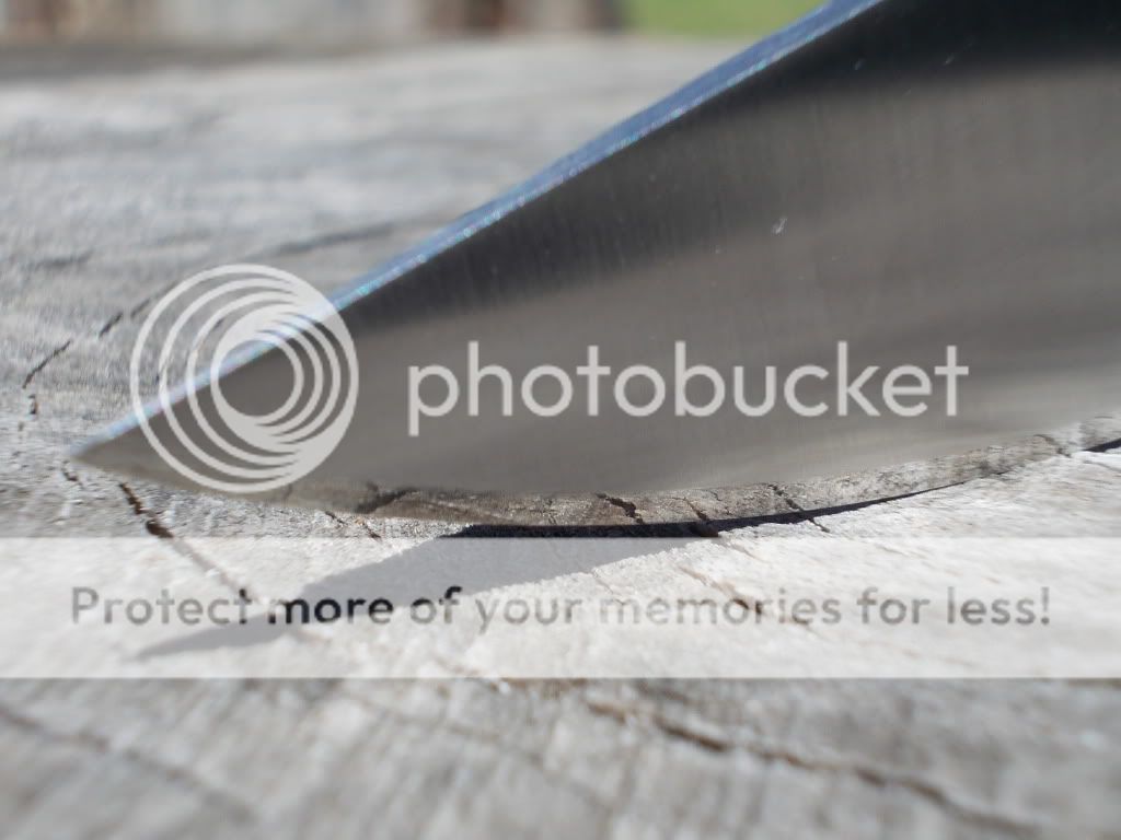

Here is the polished edge I put on the SMF I used to have. I haven't done it to a sebenza yet though, but you would have the same results. When I reprofiled the SMF, I finished it off with the white ultra fine stones. I wish I could provide a better picture, but I sold the SMF recently.
Looks dam good to me ^ The polished edge is not the only thing I'm after, but I'd be lying if I said I wouldn't want it on my knife.
If it really came down to function or aesthetics, function would win out every time, at least for me. But why not have both =P
