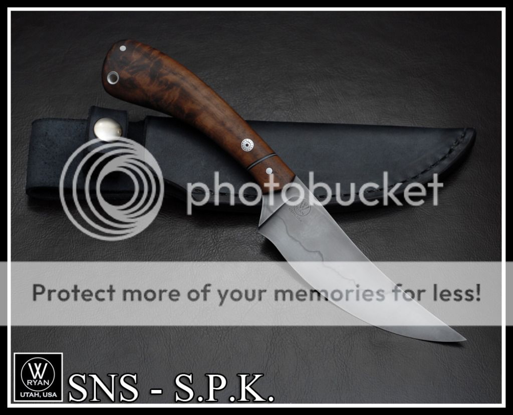

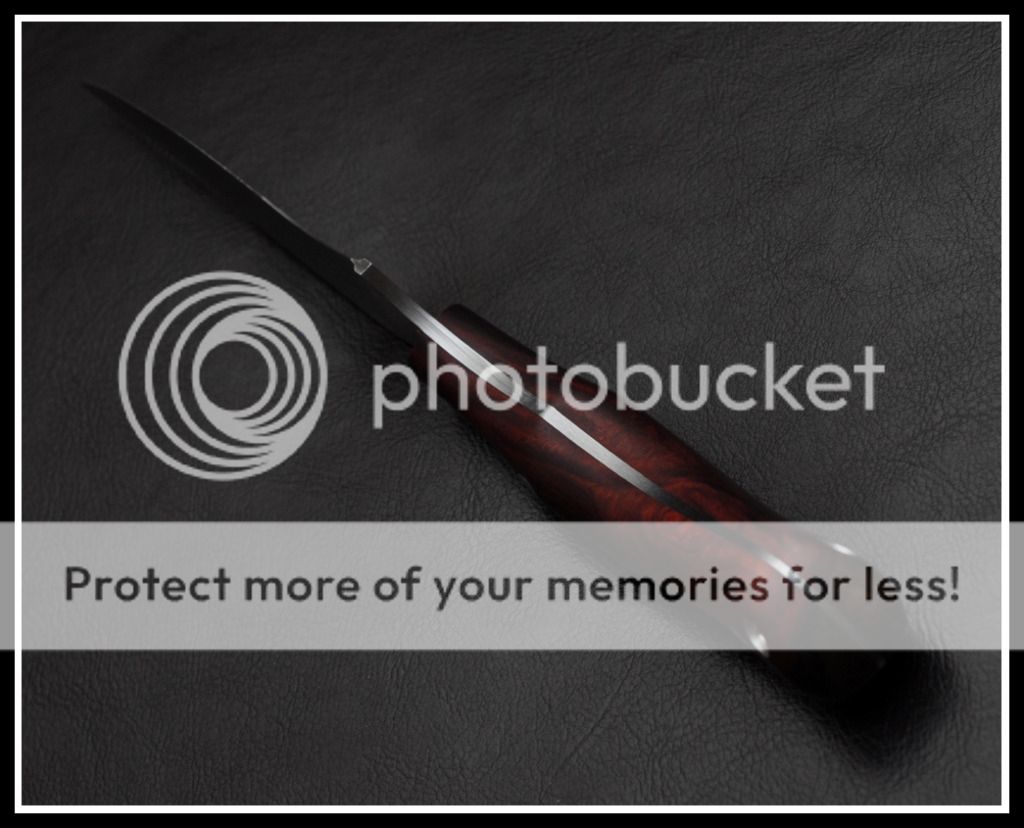

Sharpfinger Inspired "SPK"
This rendition of the Sharpfinger has the official Codger seal of approval. Seldom, if ever, has an "ode to Sharpfinger" won that distinction. I personally don't care for the "super-size-me" scaling of it, but then... I am an old Codger with well more than a quarter century of experience with Henry Baer's and Dave Swinden's original design.
Once one has used one of them for some time, the reason for the unsharpened area next to the choil is apparent. It is not needed for cutting as that is done with the belly of the blade in short strokes. The fine tip is used in initial piercing to make incisions from the flesh side out as this doesn't loosen hair on the pelt. Fingers placed along the sides of the inverted blade, or along the unsharpened spine guide the abdominal sac down and the tip lifts through the pelt like a zipper. They did make a guthook version and I have tried it. In fact I have a half-dozen examples. But I've always reverted back to the original design Sharpfinger.
Excellent craftsmanship here. FWIW, I would resist the urge to complicate an already elegant design by sharpening the spine of the knife. But then I am just an old Codger with several dozen of these original knives. That is all I have to say about that. Oh, and that this is my 20,000th forum post. If you wish to send me this knife as a present, I will report back on it's use on at least half a dozen deer this fall, possibly more. :)
Thanks everyone for the comments, I really appreciate the input and never hurts to hear you got something right on occasion.
Codger, I am a medium aged feller not quite to the Codger-dom state yet. Congrats on the 20K I may just have something I can send your way... ;)
Ryan and Michael. Thank you for your info. I learn much from threads like this especially when codgers add their experienced $.02:D
now might be a time to consider learning how to do escutcheons.
Next time you do this pattern, I would suggest simplifying everything as much as possible, and put escutcheons on. It's a dramatic pattern that would pop, imo, if it mimicked the simplicity of manufacture as the pattern it's based on.
Keep the hamon, of course!
I am finding that more and more, overall, your designs are losing some fru fru and becoming more refined.

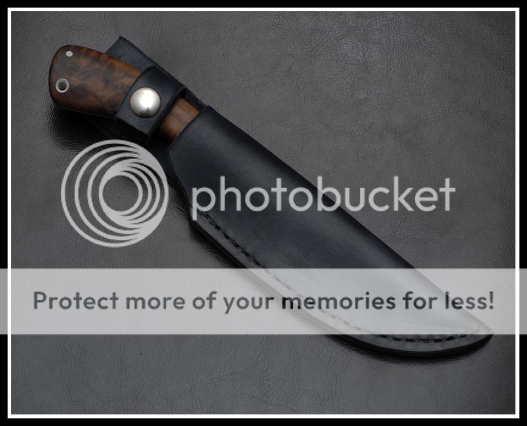

I finished up the sheath and have a few photos before it goes in the mail.
Nice work buddy! Although seeing your grandfather's Sharpfinger is very cool, I didn't even need the comparison shot to know where your design came from. It turned out really nice. Love your interpretation. The blade shape is really great!!

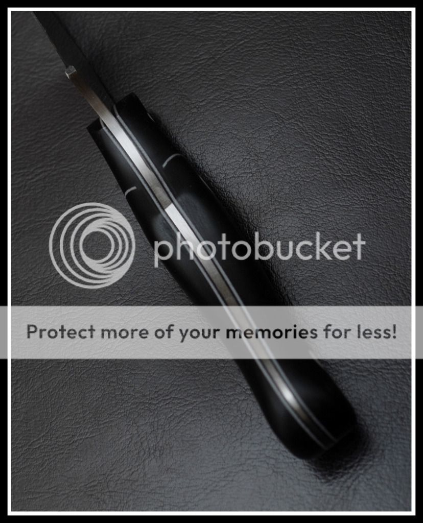

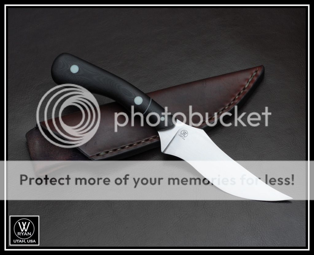

After getting some great feedback from Codger and others I made up another one, This one is closer to the original Sharpfinger. I like a bigger handle and blade so I pushed both ends out a bit and put a little more curve in both as well. I can't put it down... It just floats around in my hand and finds all kinds of interesting positions to settle.
Specs:
Steel: 1/8" 1084
OAL: 8.25
Blade: 4"
Handle: Black G10, Fiberglass Pins, G10 Spacer
Sheath: Brown Leather (RH)
Comments, Criticism welcome on this little guy as well.
Ryan
That is gorgeous. I would be scared to sharpen it with my meager skills and that beautiful set of curves but I would love to feel how it cuts.
:):thumbup:
I like features of both! The adaptability of the original to a multitude of different holds was/is one of it's most useful features. That is something that it looks like you have retained quite well while adapting proportions for your larger blade and handle length. Some knives really only invite one specific hold, all others being awkward or lacking control. Tip and belly control in multiple orientations was/is paramount to the original design. Heck, even a reverse grip ala Fred Perin and an icepick grip are doable!
I gotta go dig out my stablilized wood and ivory stash! :p
I bet yours cuts better and longer than the original. I had one as a kid and it was pretty soft. I have to go against Joe on this one I do not like the gut hook idea. Don't fix what aint broke.
