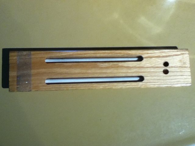

OH, Oh, oh and I just thought of a third HUGE REASON I have avoided the Sharp Maker and it is a totally irrational one I'm sure. I have two sets of the ceramic rod sharpeners that you can find in any sporting goods store. One set I bought and the second set I found when I cleared out my parents stuff after they passed away. I just looked on the base . . . they are called “Crock Sticks” . . . they’re a CROCK alright !
Both of these generic ceramic rod sharpeners SUCK so bad they do absolutely nothing. Over the last twenty years and more I have come back to them thinking it was ME but no they are only good for . . . for . . . for . . . well I can't think of a single useful thing I could do with one of those ceramic rods.
So I was traumatized at an early age by ceramic rod sharpeners promising the world and delivering only disappointment and low self esteem. Why pray tell do they have little slots so I can see the stones when they are stored in the wood base ? Or was that just to make it easier to drill the storage holes and get the wood chips out ? If that were the case best to have used two slabs of wood routed like a pencil is made but I am getting off on a tangent.
