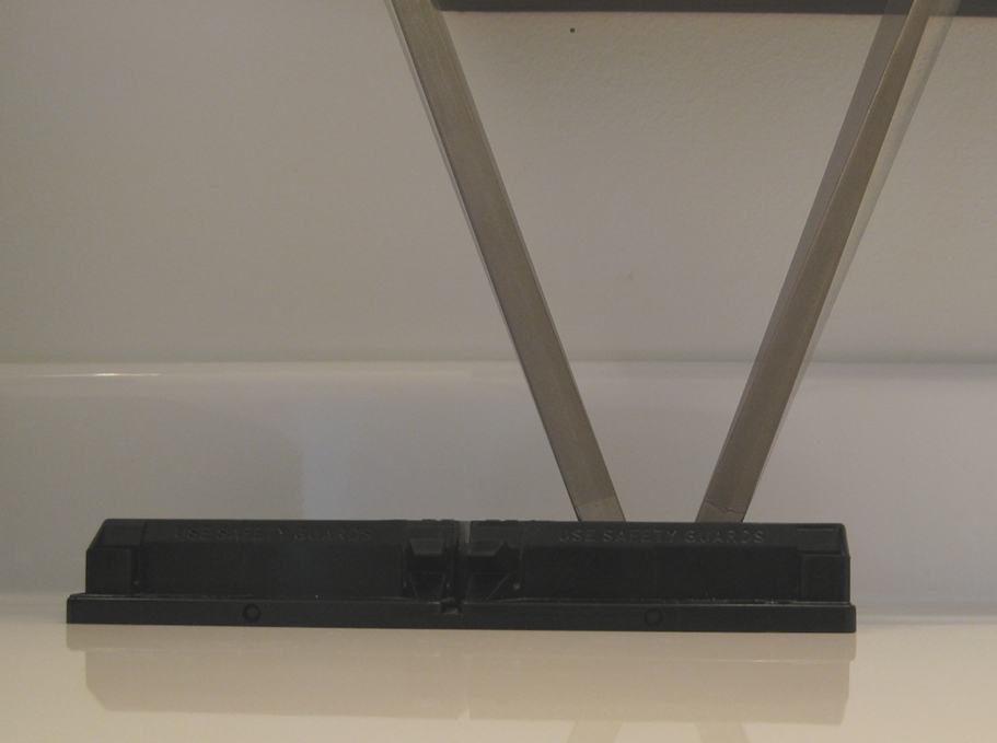

I own all 4 different stones ( UF, white, brown, diamond)
I’ve always wondered why my sharpmaker never seemed to get things as sharp as I thought it should. Moving stone to stone seemed like back peddling in sharpness occasionally, sides to flats felt like the angle was changing or not cutting. I thought I was digressing in skill. Turns out the problem wasn’t me.
I’ll try and be short but technical. Basically- the angle varies depending on what grit you’re using, what stone you’re using for that grit, flats vs corner of the stone, different sides of the stones, and even the 2 holes in the plastic base on the same side.* I can’t believe I didn’t notice this sooner, I always had my doubts and felt something was off but dismissed my concerns. I’ll explain why the angle changes.
I measured each stone and grit with a caliper and they all were “significantly” different widths, and even some stones (especially the diamond) had different widths depending on which 3 sides you used.
Therefore when the stones are sitting in the plastic base the skinnier stones (or side of a* stone) have more room to spread out and this creates a greater cutting angle on the knife edge. How much of a difference? 1-2 degrees as measured by a protractor, and yes it’s very noticable. I verified this by accident using the diamond stones on a new knife the other day when I made the discovery. I was shocked to see that between the flats and corner it looked like a quasi-microbevel. So I measured them all with a protractor and verified. Now if the angle difference was consistent you could easily compensate for it but every stone is different and every side is different.
Here’s a link of 2 rods superimposed on eachother
http://lh3.ggpht.com/-wFyc5xxLcxU/Scpu3PVcxmI/AAAAAAAAA9Y/-xy-sEtPnxs/s2048/Superimposed.jpg
How do people still get very sharp knifes? Sloppy technique and many repetitions will end up getting you a semi convex edge and still a sharp knife. At the expense of time, more metal removed, inconsistency, and edge smoothness. But as consistency and technique improve you’ll actually have a harder time using the sharpmaker since you’ll be not sharpening the same angle anytime you move/change a stone. IMO that makes it a glorified freehand bench stone. If Spyderco just made the stones with tighter tolerances so the angles only varied 0.5 degrees between stones I’d have no complaints.
I’ve heard of people wrapping the rods or pulling them together to remove the slop, but this just creates the same problem except not the loose rods form a more acute edge than the thicker ones, plus this still doesn’t account for inconsistency between sides on the same rod.

I just tested my Sharpmaker with different stones using and AngleCube.
Both the table and the sharpening base of the Sharpmaker were 0.0 degrees.
White stones (left and right): 20.85 degrees and 21.15 degrees.
Brown stones: 20.4 and 20.9
Extra fine stones: 20.7 and 20.5
Diamond stones: 20.2 and 21.0
Congress 320 Ruby: 21.7 and 20.5
I'd guess that my ability to hold a perfect vertical angle while sharpening the blade would produce more variation, but there is variation in the angles of the set stones.

The Sharpmaker is not a precision sharpening tool but one way to minimize problems is to follow the instructions which say to stroke the blade gently down the rods. The harder the pressure, the further out of line you push the rod.
Yeah, your own hand is going to have more angle inconsistency than the few degrees the rods are pushed out. It is not a precision sharpening system. But a very very good system for quick runs.
